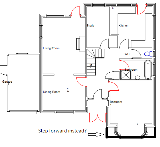

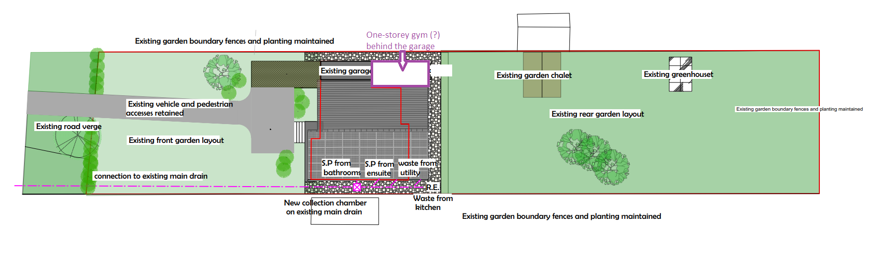

So, now that we finally have PP, I want to make up my mind WRT may be applying again to fill in the space behind the garage that will otherwise be mostly unused (well, we can store the bins there but they are nicely positioned on the other side, next to the kitchen and the side gate, where the drains are shown). I've marked the space in question in purple. The internal size would be approx. 2.5m by 5.5m, I guess we could also eat into the existing garage a bit although not sure it's particularly helpful at this stage. That would give me a space for the gym and as the garage needs a new roof anyway both could be covered with a single slope from the house outwards (see below). I'd lift the eaves a bit as well but can I do it without planning? If so, by how much?
I do admit I keep thinking that in 20+years the garage+gym could be turned into a granny annex...
North is at the top here.

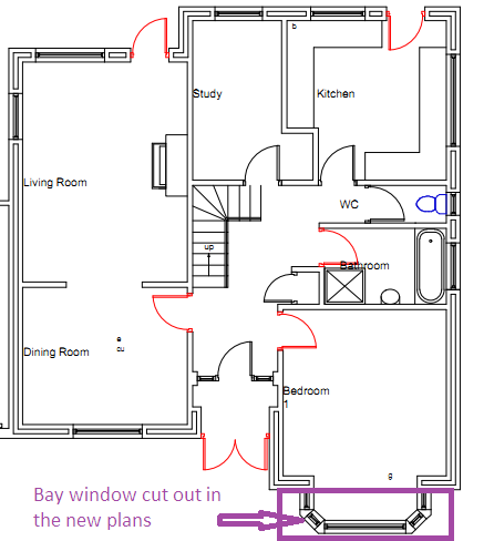

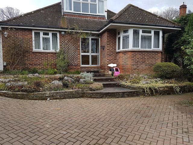

The other change I am contemplating is at the front.
The existing bungalow has a bay window which I don't like at all and to try and please the planner and at the same time get rid of the bay we cut it off completely for the now approved plans.
Old:                                                                                                                                New:
image.png.d1d4c2ca4e8d7e9aa5b4a83eac0db866.png  image.png.d0cbe264710e6bd320851cdfff3cf2db.png

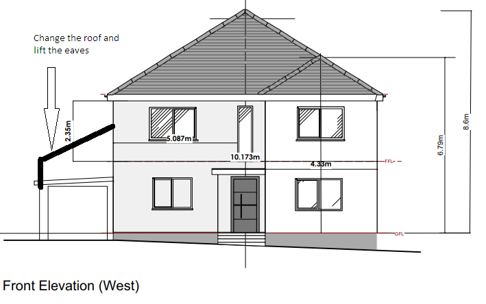

The current front view image is attached.
If occurred to me that as there is work required to build a couple of meters of foundations at the front anyway, it may be not much more expensive to increase the footprint at the front rather than reduce it:
I think it may just give us enough extra room to move the stairs to the right, South side (would be U-stairs instead of the straight we plan now). I still need to model it in Sketchup to verify. If it works, the hall will be much more spacious and get significantly more light (we'd add a window above the landing).
The question is: is it worth the hassle? I could probably get somebody to amend the drawings relatively cheaply over Skype or may be even do it myself, but
1) Does it look like it can provide value for money?
2) Is there no easier way to build the gym without going to planners again right now? I do appreciate we have enough garden space for a separate (sips type?) building, but if there is a space that can be within insulated envelope it seems a waste to build somewhere else as well?
As usual, any thought are greatly appreciated.

Glutton for punishment, or inspired minor adjustment? Hmm.
I can see the benefit, especially on the entrance route, and perhaps someone can give you a ballpark number for the cost of those foundations.
Rather than a full sketchup, try just adding the new outline bits onto a printout or trace a plan onto a new sheet over with a pencil or coloured felt tip.
An option for the hall-light would be glass panels beside the front door.
Would you try and pull he garage inside the insulated envelop?
You could do the hall and door and bay under PP, then leave the garage/gym for PD?
Remember you only have 3 years to start :ph34r:.

Thank you, @Ferdinand, as ever
Ideally I would pull the garage within insulated envelope, but I suspect it will require demolition as it is unlikely to have a deep foundation and the wall is single skin. On the other hand, demolition would give us a useful access root for the early stages of the build. I need to investigate what kind of foundation can be used for the garage as I would really want to avoid having to deal with party wall notices. Saying that, we'd need to think about it for the gym anyway. The neighbours are on the higher ground and are probably less than three meters away from the boundary. I suspect that I can assume that the bottom of their foundations is about level with our ground level, so we probably should be OK.
The front door is West side of the house and we already have a window above it, but it won't get that much light as the sun will be too low behind the trees for most of the year.
About PD root, I thought about it, my concern is the gym would be a side extension, but not only along the original building (as we are extending at the back by 3 meters on the shorter side), my understanding is that is not PD?
I was also thinking could I put in the foundation and the slab for it but leave the walls for another PP later, but again the issue here is I kind of want the gym ASAP to stop paying for it to someone else while I still hope to use it for another 10 years to recoup the expenses.

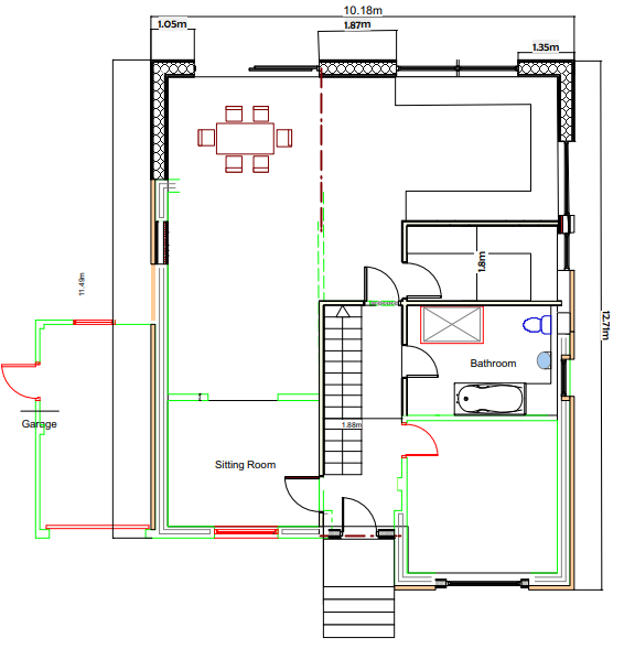

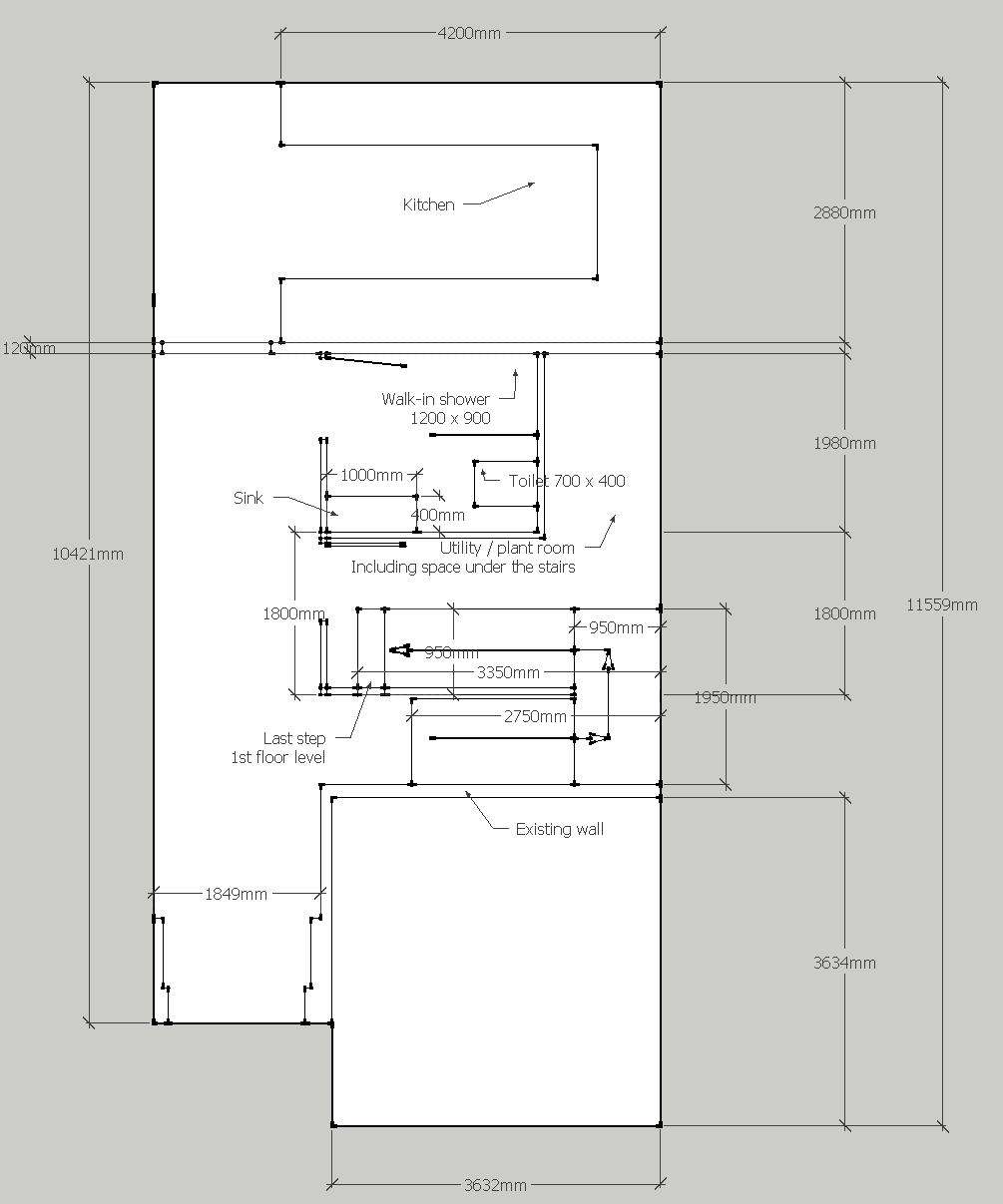

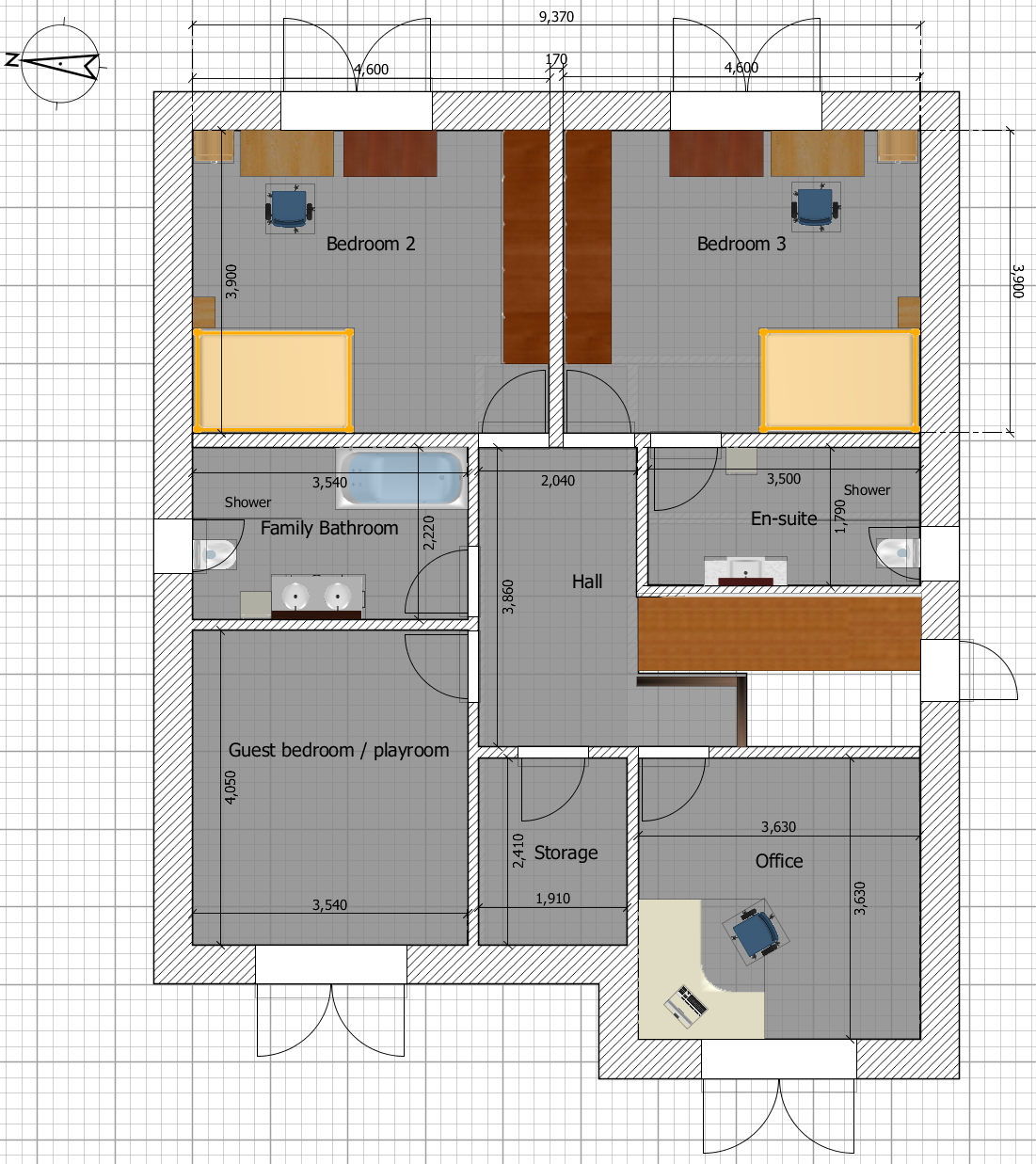

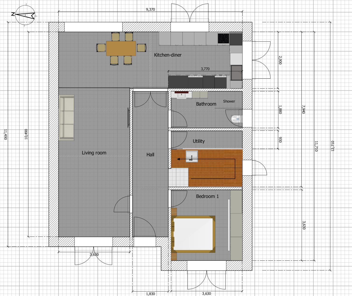

Here is a draft plan of the right side of the ground floor I came up with (living / sitting room on the left are left our for simplicity). I know the picture is not great :-) but I really had to use Sketchup: without it I'd have missed issues related to mismatches between the ground and first floor plans.
The main question I am trying to answer right now is whether the bathroom and the utility / plant room are large enough. I think I could move  the left wall of the bathroom to the left by another 400mm if required: not sure whether 1800mm+ hall is that important all the way to the kitchen, but it probably looks better, more uniform this way.
The utility will need to house a washing mashine, tumble drier (probably under the stairs all the way to the right) and ideally a large sink (probably, behind the shower). Plants - UFH manifold, may be the consumer unit and network equipment. I'm probably going to keep MVHR in the attic as I am hoping to have permanent stairs there. Gas boiler and HW tank (if required) would likely go in the attic as well. I think there will be enough space for Sunamp in this plant room should we decide to have it. Looking at the pictures in TerryE's post, the space under the stairs, close to 2.5 linear metres, should suffice but have I missed something big?
Does anybody see a better configuration for these rooms in the space between the kitchen and the bedroom?
The position of the stairs is not completely fixed but there is not much I could do with them as I need the landing upstairs in the same place where the downstairs one is to provide the entrance to the home office (it will be right on top of the bedroom downstairs in the bottom right corner. Can't move the stairs all the way to the kitchen either as it would affect the bedroom upstairs.
Overall this option allows me to easily fit 300mm going/180mm rise / 950mm wide staircase which would be great to have.
