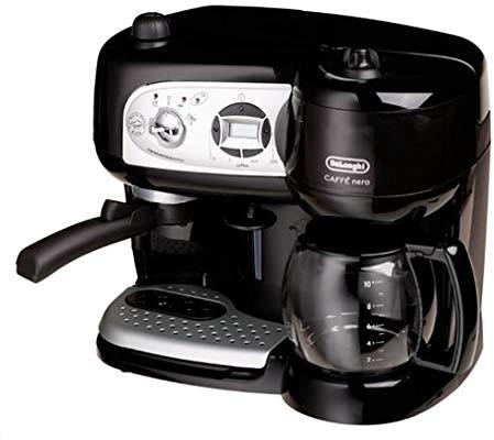

Onoff Posted February 26, 2019 Posted February 26, 2019 5 minutes ago, epsilonGreedy said: Is this because of the freezing risk? Are you suggesting a tee connector because I will will be able to reuse it in the main house later in the build? In case you want one of these in the shed?
