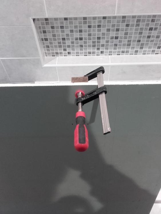

Onoff Posted February 22, 2019 Share Posted February 22, 2019 (edited) 13 hours ago, dpmiller said: is the fact that there's no PB maybe confusing it? @pocster, I think he's correct. The couple I have here have to have a "baseline" to start from which is when you place it on the wall and press the button on a bit of board with nothing behind. It has to stay in that plane which you do by keeping tight against the board. If you pull away from the board it cocks it up. You're undoubtedly doing that waving it around in free air. Clamp a bit of board to your stud and have another go I would. Keep away from the clamp of course. Edited February 22, 2019 by Onoff Link to comment Share on other sites More sharing options...
Pocster Posted February 22, 2019 Author Share Posted February 22, 2019 6 hours ago, Onoff said: @pocster, I think he's correct. The couple I have here have to have a "baseline" to start from which is when you place it on the wall and press the button on a bit of board with nothing behind. It has to stay in that plane which you do by keeping tight against the board. If you pull away from the board it cocks it up. You're undoubtedly doing that waving it around in free air. Clamp a bit of board to your stud and have another go I would. Keep away from the clamp of course. Yeah I did do exactly this first of all . Shoukd of videod that really . Anyway the 2 sent back ... Link to comment Share on other sites More sharing options...
