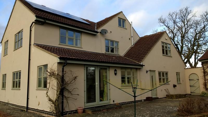

gravelld Posted February 14, 2019 Share Posted February 14, 2019 I'm thinking of hiring a scaffold tower to save a bit of cash and do some render removal myself. But we have two fairly deep lean-tos at about 3m in depth with a shallow pitch of about 25 degrees. In both cases the lean-to is open to a gable beneath at one end, but not the other. I've seen there's such a thing as "cantilever" scaffolds for towers but they aren't deep enough to reach the full depth. Is this something I have to have "proper" scaffolding for? Link to comment Share on other sites More sharing options...

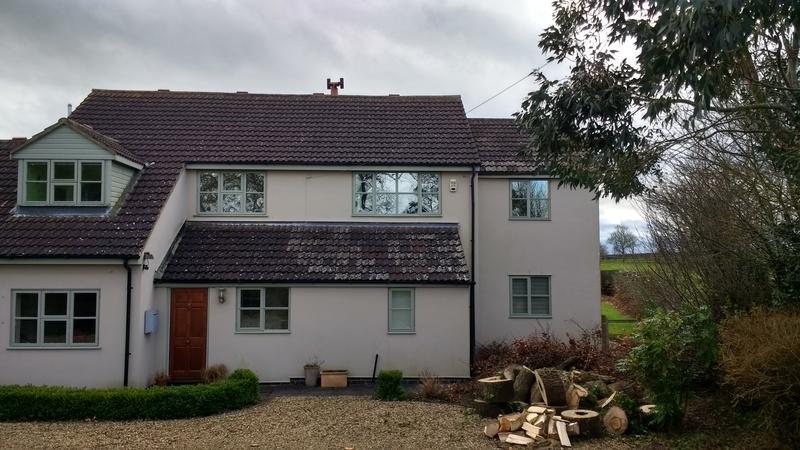

gravelld Posted February 16, 2019 Author Share Posted February 16, 2019 Thanks! The 25 degrees lean to is ok to walk on carefully, but I don't think it's suitable for working on, especially not with a breaker. There's only one "open" side so we can't span across. Plus it can be accessed along the length. That one is about 2-3m deep. Attached is the photo - "SE.jpg". The other one is more like 35-40 degrees, about 1.5m deep and can't be walked on. Again, only open on one side, so can't span. On that one the closed side is a rendered wall where the render is going to be replaced, so I could fasten something on that. This is "NE.jpg". Link to comment Share on other sites More sharing options...
Russell griffiths Posted February 16, 2019 Share Posted February 16, 2019 Take a couple of tiles out, build up a tower to same height of missing tiles, span from tower to missing tiles with a couple of scaffolding boards, span over these two boards with other boards to make a platform. Link to comment Share on other sites More sharing options...
