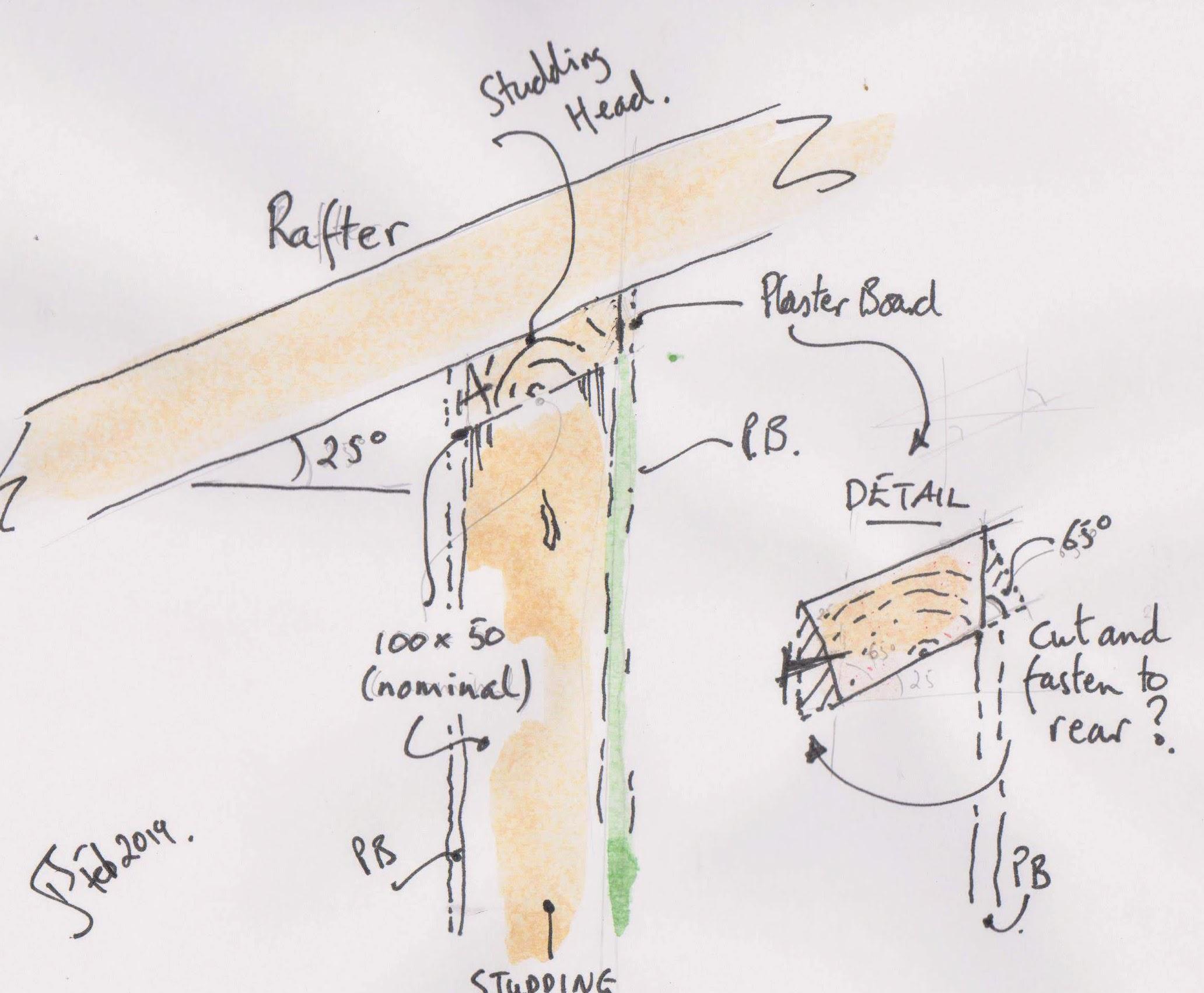

ToughButterCup Posted February 14, 2019 Posted February 14, 2019 Well , it's not flat and level like normal ones . This one is at 25 degrees. What to do? Have a look... All 100 by 50, but set at 25 degrees. And so that means that the head needs to be chamfered otherwise it'll push the PB out of line ... So I chopped off a small triangle (see detail above) so the face was vertical. To make the back of the studding work for the PB on the other side, should I nail the off-cut to the back of the stud? Or doesn't it matter? 1
Construction Channel Posted February 14, 2019 Posted February 14, 2019 That is the "proper way to do it". The easy way is to cut the studs square and put a packer or fillet on the long side where the gap will be
Construction Channel Posted February 14, 2019 Posted February 14, 2019 But in answer to your question. No it doesn't mater. You'll never get a driver to put a screw in high enough that it matters.
Mr Punter Posted February 14, 2019 Posted February 14, 2019 Nice drawing Ian. Like @Construction Channel says, cut the studs straight as it is simpler. You can wedge a bit of batten in the gap at the top to get a better fixing to the rafters. The top row of pb screws will still be fairly close to the top of the board. Are you building the wall on the floor, then raising it?
ToughButterCup Posted February 14, 2019 Author Posted February 14, 2019 17 minutes ago, Construction Channel said: [...] You'll never get a driver to put a screw in high enough that it matters. Ahhhh, thought that might be the case.... Anyway, thanks
ToughButterCup Posted February 14, 2019 Author Posted February 14, 2019 Just now, Mr Punter said: [...] Are you building the wall on the floor, then raising it? I've seen people do that on YT.....I'm not that confident..... I think I'll do it the 'proper way' (Ed's phrase) Christ I'm learning hand-over-fist........... thanks to you all.
Construction Channel Posted February 14, 2019 Posted February 14, 2019 Not that I'm picking holes or anything. It may just be local terminology, but I would have called your "studding head" a "top plate"
ToughButterCup Posted February 14, 2019 Author Posted February 14, 2019 1 hour ago, Construction Channel said: [...] I would have called your "studding head" a "top plate" Bear With A Small Brain. Told ya di 'I ? ..... 1

Declan52 Posted February 14, 2019 Posted February 14, 2019 2 hours ago, recoveringacademic said: I've seen people do that on YT.....I'm not that confident..... I think I'll do it the 'proper way' (Ed's phrase) Christ I'm learning hand-over-fist........... thanks to you all. Its easier than you think. Just a matter of making sure your measurements are spot on the first, second and third time you check. Much easier to get a good swing at it with the hammer to drive in the nails when you have it flat on the floor.
ToughButterCup Posted February 15, 2019 Author Posted February 15, 2019 21 hours ago, Declan52 said: [...] Much easier to get a good swing at it with the hammer to drive in the nails when you have it flat on the floor. Right. I going to give it a go using spare 2 by 4 (loads from the shuttering). Now that I think of it, though Declan, my stupid hands.... means I was intending to screw everything together....

Declan52 Posted February 15, 2019 Posted February 15, 2019 1 hour ago, recoveringacademic said: Right. I going to give it a go using spare 2 by 4 (loads from the shuttering). Now that I think of it, though Declan, my stupid hands.... means I was intending to screw everything together.... Screws or nails wont matter. Use what ever method suits you.
