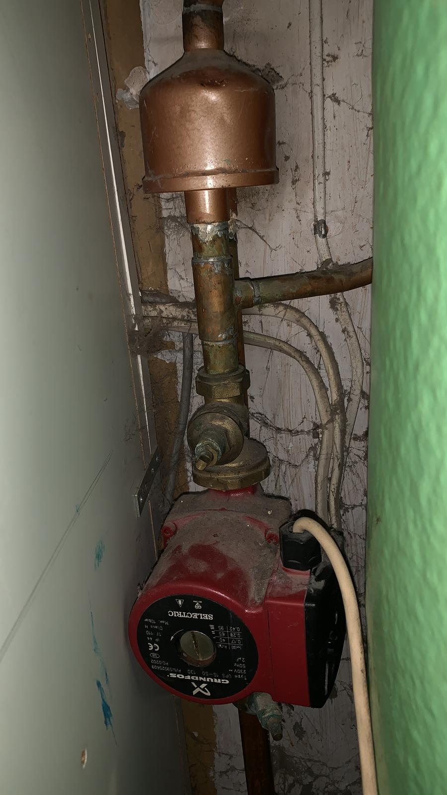

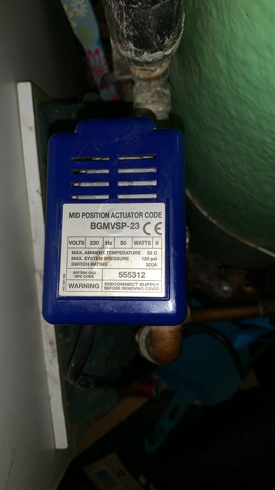

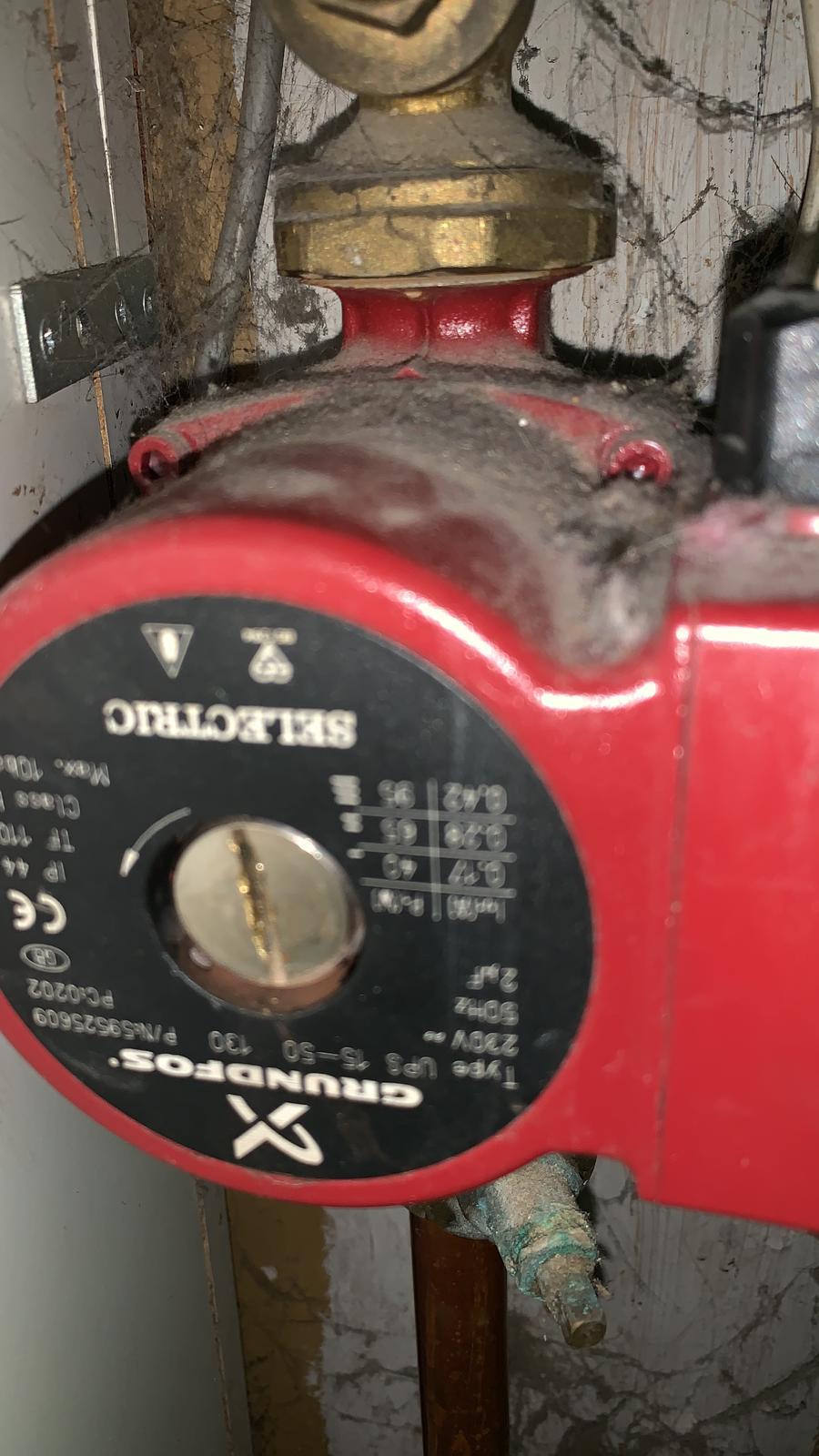

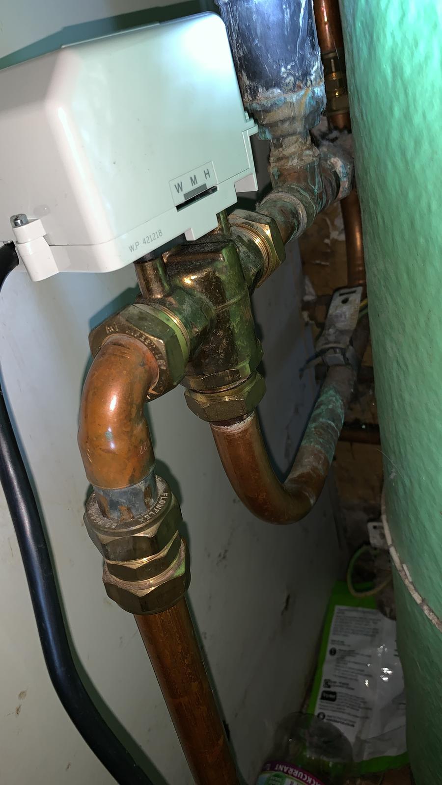

Onoff Posted February 2, 2019 Share Posted February 2, 2019 One of the kid's friend's CH/DHW has packed up. Single mum etc. Traditional pumped system, gas boiler, copper cylinder, 3-way valve. She's getting HW but only the 1st rad is getting warm and the second a bit warm. She reckons it sounds like there's a "nut" loose in what I assume is the air separator. Not sure on the valve make but the actuator is apparently easily removeable as in clip on/off: Existing pump. Assume the air separator above? The existing mid position valve: I have this Drayton one in the spares box. It's actuator clips on/off too. Would it be interchangeable? Cheers Link to comment Share on other sites More sharing options...
ProDave Posted February 2, 2019 Share Posted February 2, 2019 Start by removing the existing actuator and checking the mechanical part of the valve is free to rotate. Link to comment Share on other sites More sharing options...

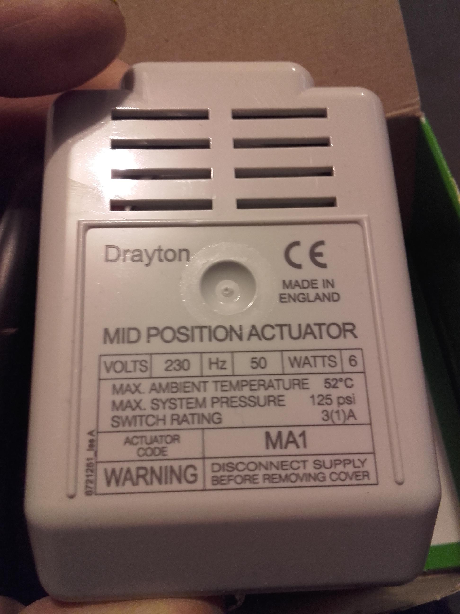

Onoff Posted February 2, 2019 Author Share Posted February 2, 2019 3 minutes ago, ProDave said: Start by removing the existing actuator and checking the mechanical part of the valve is free to rotate. They don't move a lot do they? Just had a look at this (new) Drayton one. Link to comment Share on other sites More sharing options...
ProDave Posted February 2, 2019 Share Posted February 2, 2019 Yes but check it is free to move not stiff. If it is stiff some oil and exercise it with pliers will often free it off. I think these ones only go a quarter turn. Link to comment Share on other sites More sharing options...
Onoff Posted February 2, 2019 Author Share Posted February 2, 2019 (edited) 14 minutes ago, ProDave said: Yes but check it is free to move not stiff. If it is stiff some oil and exercise it with pliers will often free it off. I think these ones only go a quarter turn. Yep told her that. I reckon this Drayton one moves about 10-15deg either way if that. She's just Whatsapp'd me a minute ago and said she's whipped the actuator off and the spindle moves. Seems this Drayton one is a direct replacement for the BG one from what I've read. Actuators are interchangeable too it seems. Edited February 2, 2019 by Onoff Link to comment Share on other sites More sharing options...
Onoff Posted February 3, 2019 Author Share Posted February 3, 2019 Gave her the new Drayton mid-port valve, she wanted to try and fit it herself. Fair play. Just messaged me. Reckons the bleed valve on the pump is leaking - she did undo it. She's just sent me this video. Sounds to me the system is running dry - but the pump bleed valve leaks? Suggest she checks the header tank ball cock? Link to comment Share on other sites More sharing options...
Onoff Posted February 3, 2019 Author Share Posted February 3, 2019 Pump has stopped leaking. She's been in the loft. Both header and cws tanks full and ball cocks working. Reckons loft is soaking wet with the smaller header tank "steaming". "Like a Turkish bath up there" she says. (It's a prefab, concrete ceilings so will take a while to come through if ever). Thinking pump gone u/s? Link to comment Share on other sites More sharing options...

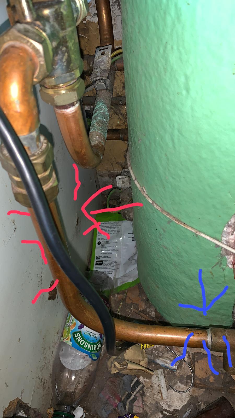

Onoff Posted February 3, 2019 Author Share Posted February 3, 2019 She keeps buggering about putting the acuator on either way. Seemingly it will but will only engage on the two lugs one way. Told her to put it on properly and diagnose from there. On the valve, port B is to the cylinder coil, port A to the rads which is correct. Reckons it's hot where red but cool where blue: Link to comment Share on other sites More sharing options...
ProDave Posted February 3, 2019 Share Posted February 3, 2019 I would take the head off, turn the spindle fully one way, try it. Then turn the spindle fully the other way and try it. If neither results in hot radiators the problem is something else like a blockage. Link to comment Share on other sites More sharing options...
