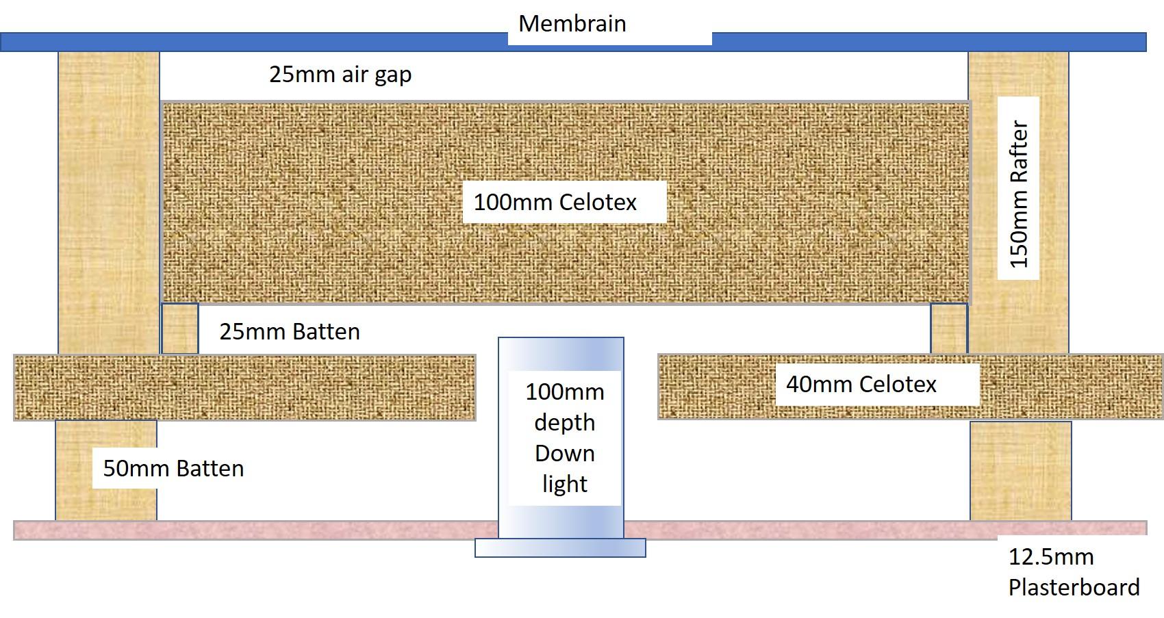

Russell griffiths Posted February 2, 2019 Posted February 2, 2019 IMHO that looks like a really stupid design so yo install bloody expensive insulation and then cut a hole in it for a light DUR. might as well leave the window open pull the 100mm celotex down and touch the 40 mm against it, then find a shallow light or increase the batten depth, how is she proposing to provide your airtight layer if your going to cut a sodding great hole in it. Sorry that’s rubbish. You can have the best insulation in the world, but if it’s leaky and gappy you might as well leave it out. 1 1
Ferdinand Posted February 2, 2019 Posted February 2, 2019 (edited) 19 minutes ago, Russell griffiths said: so yo install bloody expensive insulation and then cut a hole in it for a light Agree with @Russell griffiths on this point. Surely that will be a large number of "bloody great holes" ! (Personally I think that recessed spotlights are the spawn of the devil; I have about 70 installed by the previous owner, and the lecky will charge you One Point for wiring each one.) In my view Occam says use either multispot fittings or the more modern LED panels. Plus perhaps spend the recessed spotlght money on a feature light fitting for the hall, an artwork, or whisky. Ferdinand Edited February 2, 2019 by Ferdinand Further enlightenment 1 1

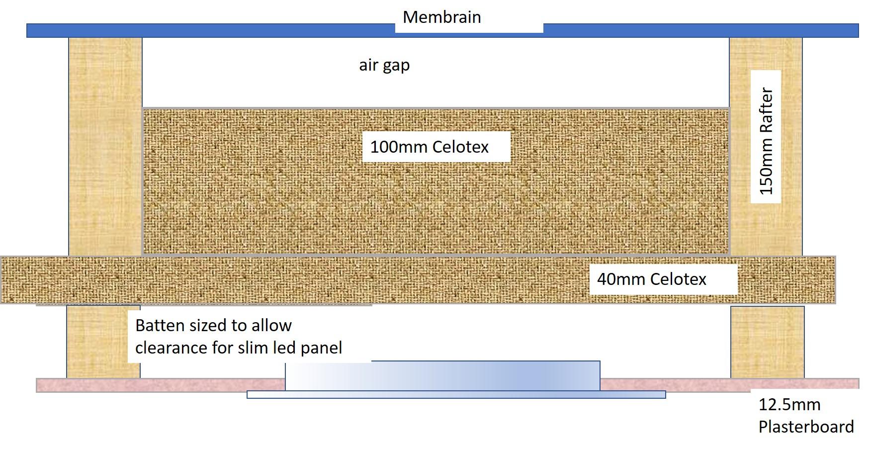

wozza Posted February 2, 2019 Author Posted February 2, 2019 The diagram was drawn by me - I was trying to see how it would all work ? So would this be better?
Russell griffiths Posted February 2, 2019 Posted February 2, 2019 You need to add a vapour control layer between the 40mm celotex and the batten this can be achieved many ways a vapour control membrane taped on with all joints taped and taped to walls or tape all joins in 40mm celotex with the aluminium tape and seal to walls. That second roof makeup is probably a million times better than the first with just a little bit of juggling. 1
wozza Posted February 2, 2019 Author Posted February 2, 2019 (edited) Thanks Russell. Off to look for Led Panels now. Edited February 2, 2019 by wozza
