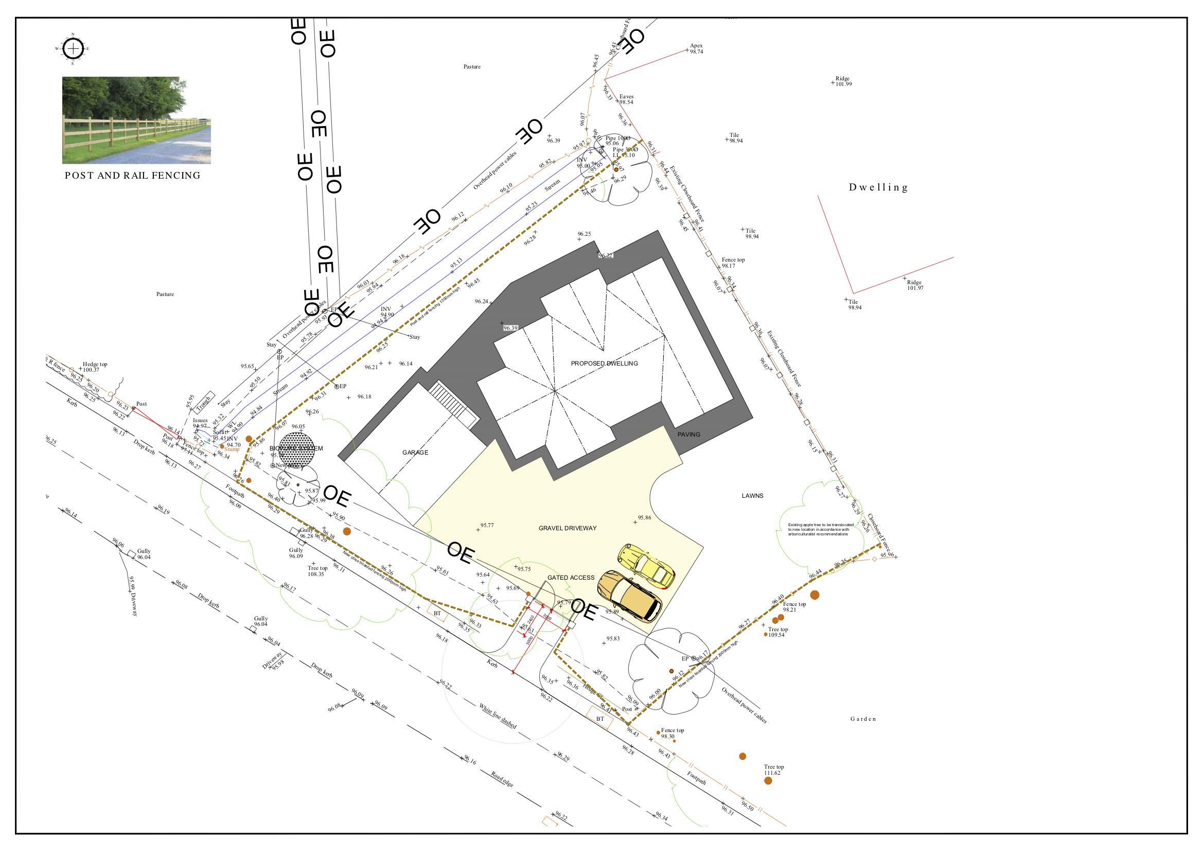

Andrew Posted January 29, 2019 Share Posted January 29, 2019 We have a large detached double garage planned as part of our build with a 42m2 studio space in the roof above. This is mostly an open room but there's a small toilet and shower room in there too. I work from home two or three days a week and the idea is this will be my office so will be used quite frequently - it can also double up as extra guest accommodation if needed (sofa bed). Due to the frequent use the plan is to insulate it and make it as airtight as the main house. It's only approx 3-4m from the plant room in the main house at its closest point (as shown on the plan, obviously longer to run the pipes underground and up into the studio) so the plan is to bring the services from the house in terms of UFH and DHW. However I don't think it's practical to run MVHR ducting underground to service the room above the garage? So, is there a small MVHR unit that would be suitable for the studio space or perhaps some other solution? Or perhaps there's no point with such a small space and I should have trickle vents? I've attached a site plan for context. Link to comment Share on other sites More sharing options...
Jeremy Harris Posted January 29, 2019 Share Posted January 29, 2019 There are several single room MVHR units available that might be worth considering, but care is needed to ensure that building regs can be complied with, especially with regard to the ventilation rate for the WC and shower room. The inability to comply with building regs was the thing that stopped me from exploring the use of a very neat wall-mounted MVHR solution. It may have been OK in other countries but couldn't be made to comply here. However, it should be fairly simple to install a small MVHR with extracts from the shower and WC and fresh air feeds into the working area without too much trouble. If you're going to be using this area for long periods every day then it makes sense to try and make the environment in there as pleasant as possible, plus there should be a useful saving in heating cost. 1 Link to comment Share on other sites More sharing options...

Andrew Posted January 29, 2019 Author Share Posted January 29, 2019 Thanks both, I'll take a look at the Fresh R. As @JSHarris says there are several single room units and actually they are quite good value - e.g. https://www.blauberg.co.uk/en/blauberg-komfort-ultra-d105-a-single-room-heat-recovery-unit. If an extract in the bathroom and a supply in the main office is able to meet building regs then this would be quite a neat solution. The ceilings are vaulted but there will be some storage in the eaves which I'm sure could accommodate a single room unit and ducting. Link to comment Share on other sites More sharing options...
