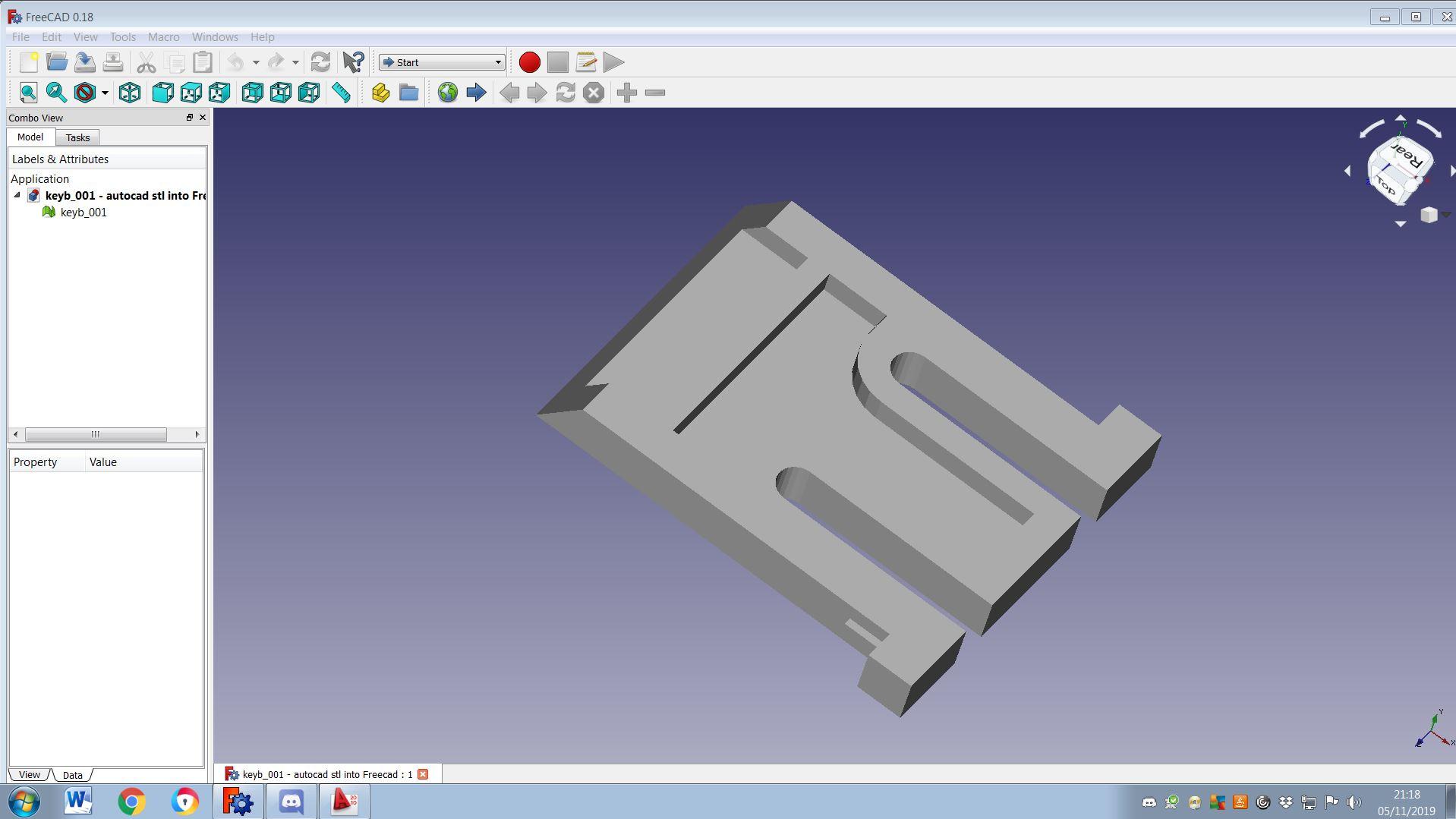

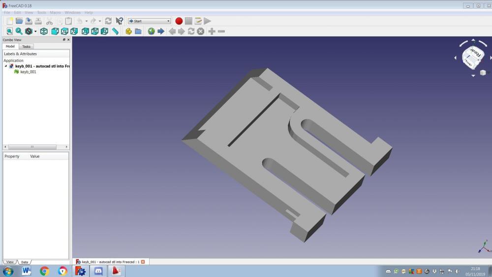

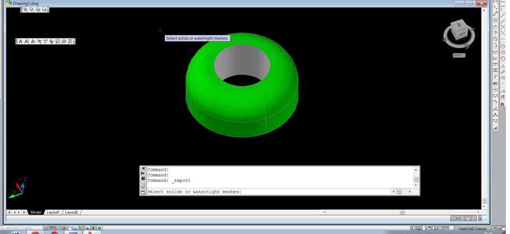

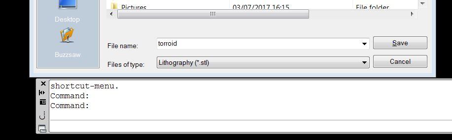

Onoff Posted November 5, 2019 Share Posted November 5, 2019 Success I think. Managed to export the AutoCAD 2010 .dwg as an stl file into FreeCAD. Jeremy, I'll send you the file. 1 Link to comment Share on other sites More sharing options...
Jeremy Harris Posted November 5, 2019 Share Posted November 5, 2019 Brilliant! Like to know how you did it, as I tried a few tricks to try and get the file into FreeCAD without luck. .stl files from FreeCAD I know work fine, as I've printed a couple of dozen or so parts that way. I'll print it off in the morning, if all goes well. Link to comment Share on other sites More sharing options...
Onoff Posted November 5, 2019 Share Posted November 5, 2019 (edited) 22 minutes ago, Jeremy Harris said: Brilliant! Like to know how you did it, as I tried a few tricks to try and get the file into FreeCAD without luck. .stl files from FreeCAD I know work fine, as I've printed a couple of dozen or so parts that way. I'll print it off in the morning, if all goes well. Create your solid in AutoCAD, a couple of circles in this case, extruded into cylinders then the smaller one subtracted from the larger one: Render it to make it look pretty (don't think this step is essential): File, Export, changing to an stl from the drop down menu with whatever destination folder you want: Simply click on the solid when prompted, it auto saves to what folder etc you've chosen: In this case I saved to the Desktop: Open FreeCAD and Open the stl: Edited November 5, 2019 by Onoff 1 Link to comment Share on other sites More sharing options...
Onoff Posted November 5, 2019 Share Posted November 5, 2019 Just thinking...maybe I don't even need to use FreeCAD...I'll send you the raw .stl I produced in AutoCAD to try. Link to comment Share on other sites More sharing options...
Jeremy Harris Posted November 5, 2019 Share Posted November 5, 2019 3 minutes ago, Onoff said: Just thinking...maybe I don't even need to use FreeCAD...I'll send you the raw .stl I produced in AutoCAD to try. If you send both, I can double check, but any .stl should work OK. It only takes a few seconds to load an .stl file into the slicer and see if it looks OK. Link to comment Share on other sites More sharing options...
Onoff Posted November 5, 2019 Share Posted November 5, 2019 10 minutes ago, Jeremy Harris said: If you send both, I can double check, but any .stl should work OK. It only takes a few seconds to load an .stl file into the slicer and see if it looks OK. Ta. Done so. I emailed you a FreeCAD file first...that was the AutoCAD stl imported into FreeCAD then saved in FreeCAD format. The last email I sent is the stl file straight from AutoCAD. I figured what I did wrong yesterday when trying to export the stl. I was trying to select the AutoCAD solid by drawing around with the selection tool. I should have simply clicked on the solid! Ignore the earlier batch of .dwgs and .dxfs. Hopefully this'll save me having to learn a new CAD package! Link to comment Share on other sites More sharing options...

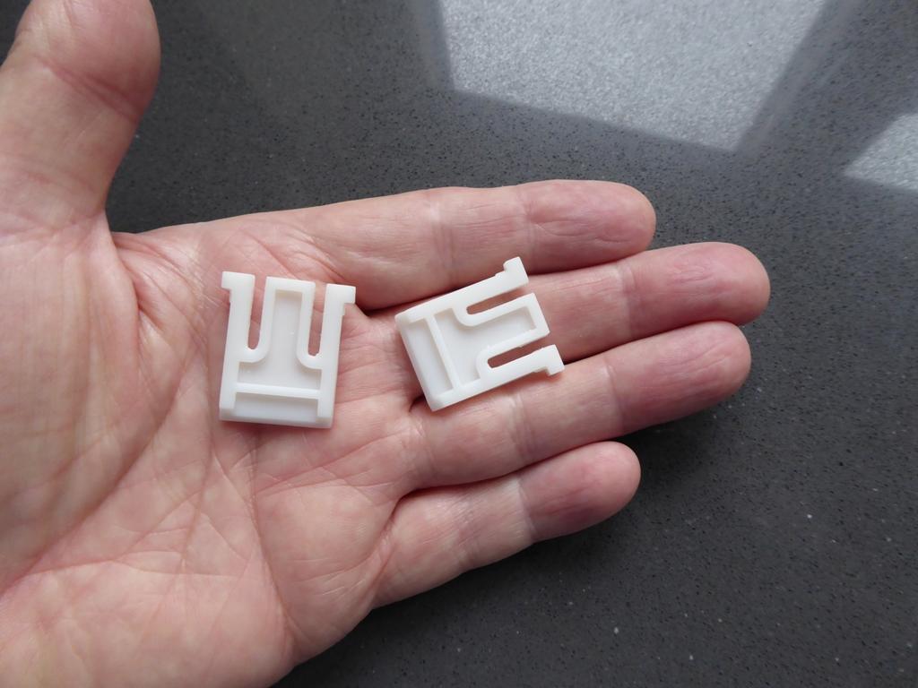

Jeremy Harris Posted November 6, 2019 Share Posted November 6, 2019 They seem to have printed OK, just a small bit of "flash" where they were sat on the printer bed, but otherwise OK. 1 Link to comment Share on other sites More sharing options...
Onoff Posted November 6, 2019 Share Posted November 6, 2019 14 minutes ago, Jeremy Harris said: They seem to have printed OK, just a small bit of "flash" where they were sat on the printer bed, but otherwise OK. That's brilliant. Thanks very much. What's the material btw? Link to comment Share on other sites More sharing options...
Jeremy Harris Posted November 6, 2019 Share Posted November 6, 2019 It's a generic white UV curing resin, this stuff: https://technologyoutlet.co.uk/products/technologyoutlet-premium-3d-printer-resin?variant=12582237372528 I'm pretty sure it's an acrylic of some sort. When cured it seems to behave very much like Perspex. Should catch the post this afternoon, with luck. Link to comment Share on other sites More sharing options...

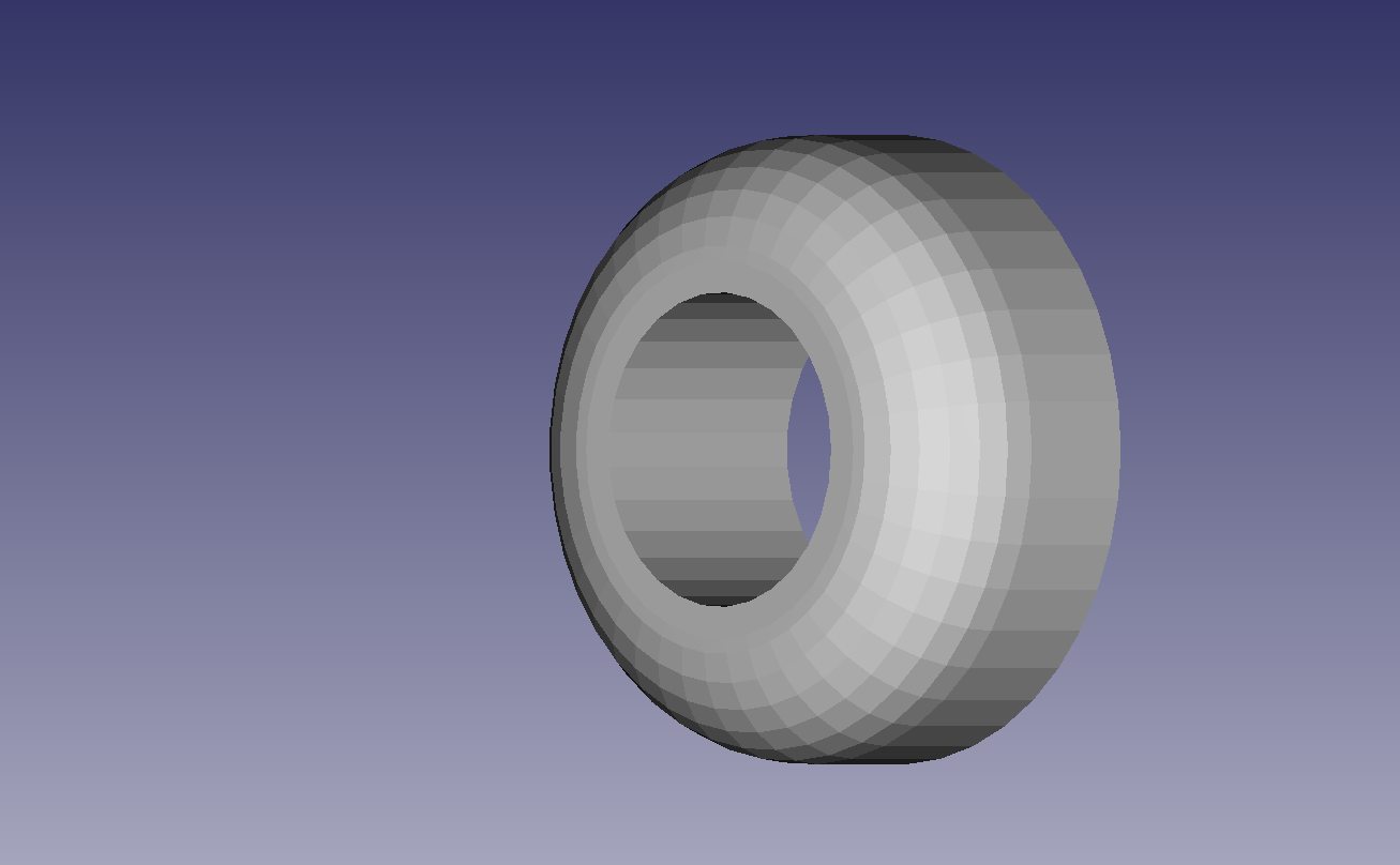

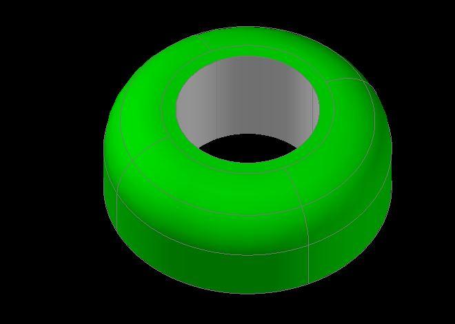

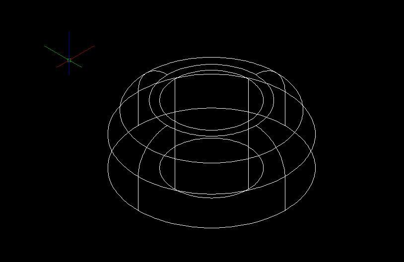

Onoff Posted November 6, 2019 Share Posted November 6, 2019 Bearing in mind what you said about printing "flat" I think, I modelled the little "stub axles" that poke out of the sides as an arch shape rather than cylinders... Or could it have printed them as cylinders? Link to comment Share on other sites More sharing options...
Jeremy Harris Posted November 6, 2019 Share Posted November 6, 2019 5 minutes ago, Onoff said: Bearing in mind what you said about printing "flat" I think, I modelled the little "stub axles" that poke out of the sides as an arch shape rather than cylinders... Or could it have printed them as cylinders? The files I got were like this, with the little pegs square: The printer could have printed them as round pegs, just a matter of angling the piece up off the build plate and adding some supports. This stuff gets done in the slicer (Cura is one such product, I use the slicer that came bundled with the Photon). Most slicer programmes seem able to rotate parts, add supports, add a printing base, etc, either automatically or manually. The only slight downside of using supports is that they leave little marks on the print, rather like the sprue marks on an Airfix kit. Link to comment Share on other sites More sharing options...
Onoff Posted November 6, 2019 Share Posted November 6, 2019 2 minutes ago, Jeremy Harris said: The files I got were like this, with the little pegs square: The printer could have printed them as round pegs, just a matter of angling the piece up off the build plate and adding some supports. This stuff gets done in the slicer (Cura is one such product, I use the slicer that came bundled with the Photon). Most slicer programmes seem able to rotate parts, add supports, add a printing base, etc, either automatically or manually. The only slight downside of using supports is that they leave little marks on the print, rather like the sprue marks on an Airfix kit. Interesting...the conversion to .stl has maybe "lost" the radiused edges of the original model? Link to comment Share on other sites More sharing options...
Jeremy Harris Posted November 6, 2019 Share Posted November 6, 2019 Just now, Onoff said: Interesting...the conversion to .stl has maybe "lost" the radiused edges of the original model? May be, I've seen a few odd things happen, but nothing quite as clear cut as this. Hopefully you can just file the corners off the pegs to get them to fit. Link to comment Share on other sites More sharing options...
