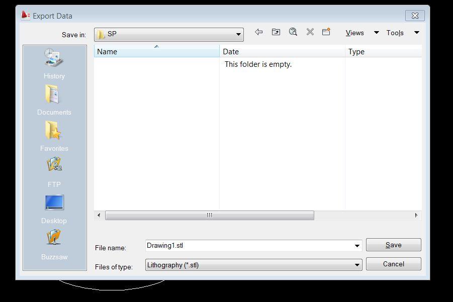

Onoff Posted November 4, 2019 Posted November 4, 2019 (edited) 33 minutes ago, Temp said: I Google translated the text on that Tinkercad page and it said... "With this adapter 20V Ferrex machines from Aldi can be operated with Makita 18V batteries. I developed it for the battery blower and the battery compressor. The contacts in the adapter come from a 2.0Ah Ferrexakku." Is that the right way around for you? Or has Google translate messed up? My apologies...it was ME that messed up! Yes it is the right way around. Makita battery to Ferrex tool. I looked at so many Parkside, Einhell, Ferrex, Workzone. Could have sworn it was the "wrong way around! Seems my AutoCAD 2010 offers the ability to export as a Lithography (*.stl) file, is this the correct format? Edited November 4, 2019 by Onoff
Jeremy Harris Posted November 4, 2019 Posted November 4, 2019 22 minutes ago, Onoff said: Seems my AutoCAD 2010 offers the ability to export as a Lithography (*.stl) file, is this the correct format? Yes, should be fine. My version of AutoCAD is older, and doesn't have this option... If you want to draw up something small (no wider than about 65mm) then I could do a test print for you to check.

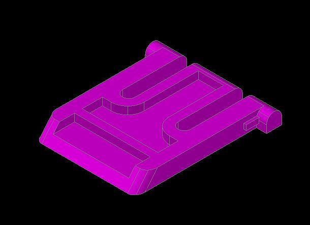

Onoff Posted November 4, 2019 Posted November 4, 2019 45 minutes ago, Jeremy Harris said: Yes, or a bit larger if you like. Ideally it needs to have a flat base, as that saves having to add a support layer where the part attaches to the base plate at the start of the print. A polo with a flat base, or something with a bit more shape to it if you like. To avoid supports it needs to be a shape that doesn't have any isolated areas when sliced, so that the bit that's already been printed can hold the next layer to be printed, if you get what I mean. How about this? I quickly knocked up my missing keyboard leg! Nom 27 x 24 x 3.
Jeremy Harris Posted November 4, 2019 Posted November 4, 2019 18 minutes ago, Onoff said: How about this? I quickly knocked up my missing keyboard leg! Nom 27 x 24 x 3. That'd be fine, ping me the .stl and I'll get it printed tomorrow.

Onoff Posted November 4, 2019 Posted November 4, 2019 35 minutes ago, Jeremy Harris said: I'll PM you. Thanks got the pm. I'm not hopeful, AutoCAD has saved the file with a weird .sv$ extenstion??? I'll send it anyway shortly, maybe it needs a package that reads STL files? Any colour's fine! Just seemed sensible to print something practical if we're going to try it so I grabbed the vernier and measured the remaining keyboard foot! Cheers

Onoff Posted November 5, 2019 Posted November 5, 2019 Jeremy, thanks for having a go with that file, sorry it didn't appear to work. I'll have another go tonight to try and save it as in .stl format.
Jeremy Harris Posted November 5, 2019 Posted November 5, 2019 I tried changing the suffix to .dwg then converting it to .dxf, with the intention of opening it in FreeCAD so that it could be exported as a .stl file but for some reason that didn't work either. According to AutoDesk, all that should be needed to convert an autosave file to a .dwg should be to edit the suffix, but for some reason that doesn't seem to work. I can't open .dwg files in the newer format, unfortunately, as my copy of AutoCAD is an older one.
