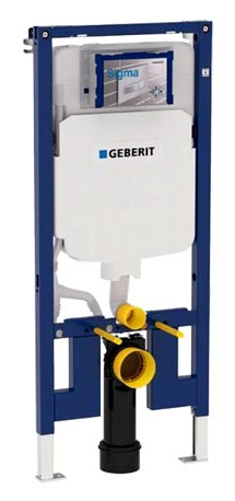

oranjeboom Posted January 14, 2019 Posted January 14, 2019 I have a smallish downstairs bathroom that will only be 1.7m in width and therefore trying to push the toilet as far 'into the wall' as possible and also give the illusion of space (therefore going for wall hung rather than back to the wall toilet). Geberit or Grohe seem to be the best in terms of fitting. Worth paying the extra it seems over some makes. I like the Geberit up720 frame as it's only 80mm in depth plus boxing in/tiling depth. However, I don't particularly like their small projection ("iCon") toilet (490mm). How easy is it to match up with another toilet, e.g. shanks, twyford etc? "For installation of a wall-hung WC with bolt fixings set at 180 or 230 mm centres" So that means I need to ensure that whatever pan I have on the wife's wishlist needs to be fixable at either 180 or 230mm centres, correct? I don't want to have a garden full of non-compatible toilets that I need to sell on/return! If that is the case there is a Vitra short projection toilet (48mm) with 180mm fixings that could be in the running (subject to wife approval status). I then spotted that Vitra also do a Vitra frame that is 80mm: Vitra are Turkish and their warranties actually are better than other makes: Their range seems decent: https://www.ergonomicdesigns.co.uk/uploads/brochure/54.pdf and VP sell their toilets and frames also, so I can't imagine they would be doing that if they are complete crap. Has anyone have experience, especially the wall hung frame? Installation vid seems uncomplicated (no surprise) https://vitra-fitandforget.co.uk/fit-with-confidence/. Although it may need a bigger area than just the flush plate that needs to be removable for any maintenance issues (compared to Grohe/Geberit). TIA
Moira Niedzwiecka Posted January 14, 2019 Posted January 14, 2019 I have one vitra frame and one geberit frame as above both with duravit toilets. It is the flush plates that seem to be specific to each cistern. Roca also do a slimline wall hung cistern.

oranjeboom Posted January 14, 2019 Author Posted January 14, 2019 47 minutes ago, Moira Niedzwiecka said: I have one vitra frame and one geberit frame No issues with install or maintenance with either? 47 minutes ago, Moira Niedzwiecka said: Roca also do a slimline wall hung cistern. Thanks - not a bad price either! https://www.ukbathrooms.com/products/roca-duplo-wall-hung-toilet-frame-and-cistern.html 32 minutes ago, Onoff said: I'll hopefully be fitting a Berstein wc to Geberit frame shortly. One of these: https://www.ebay.co.uk/itm/RIMLESS-WALL-HUNG-WALL-MOUNTED-TOILET-NT2038-Ceramic-Soft-close-duroplast-seat/282355252671? Not a bad look with 480mm projection. Did that come from Germany in the end?

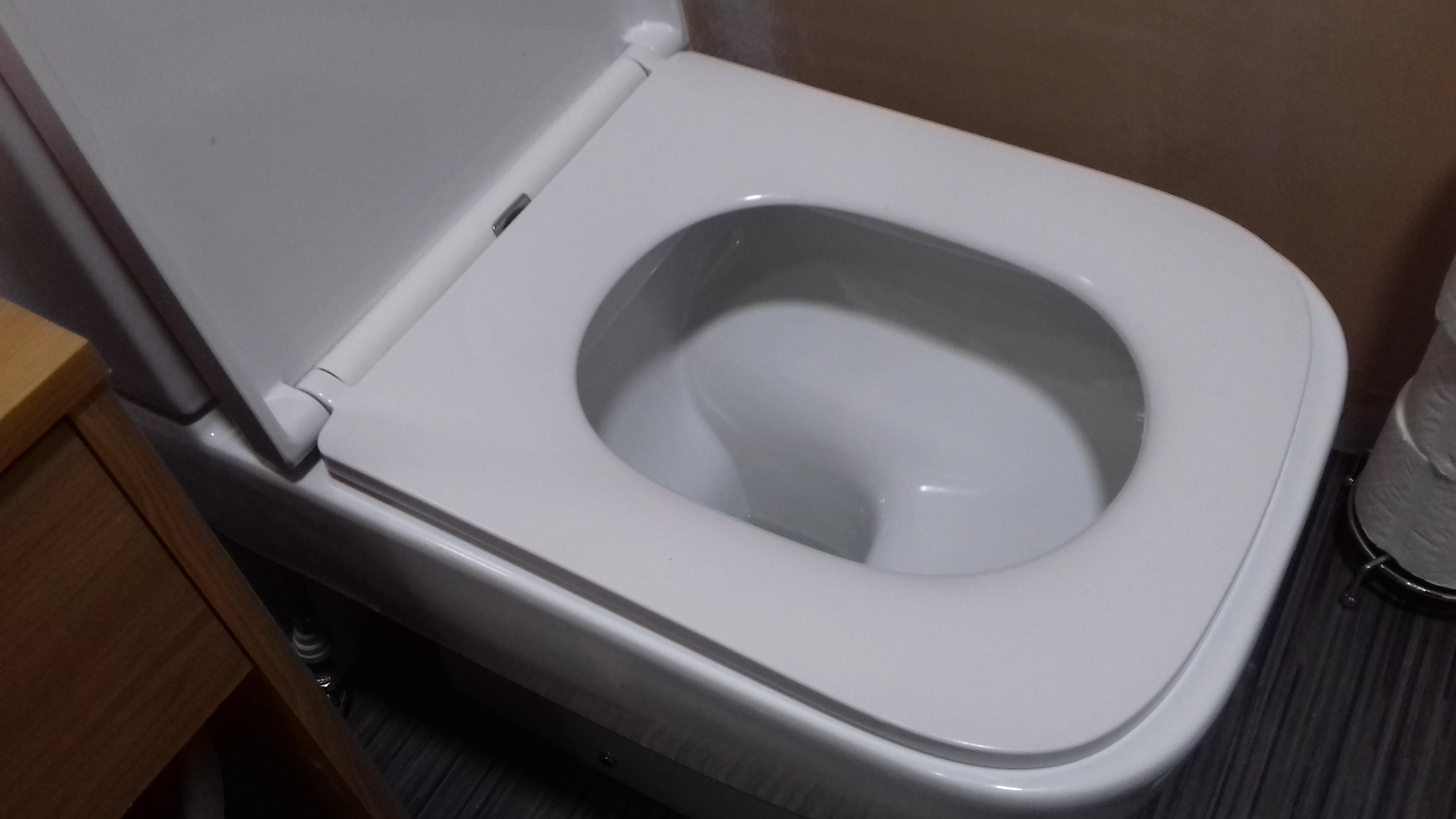

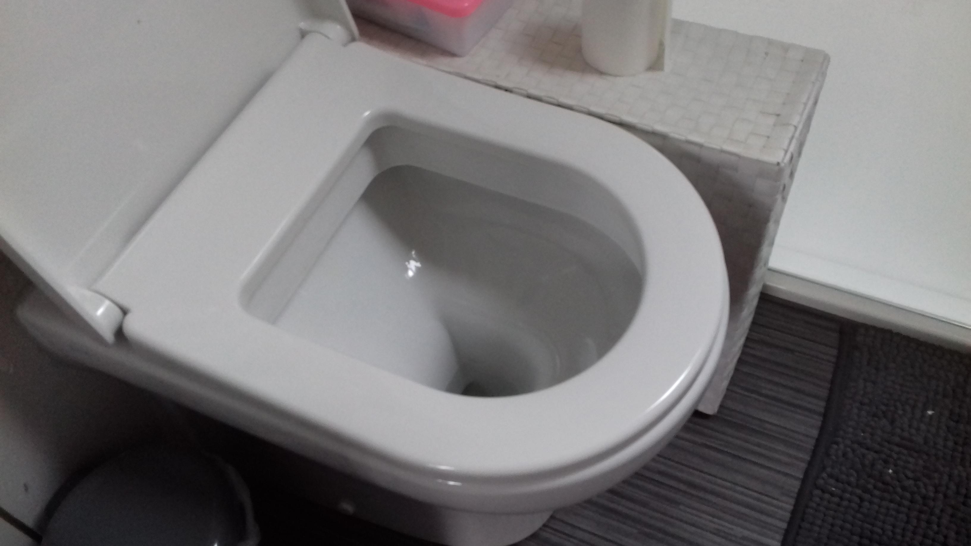

Hecateh Posted January 18, 2019 Posted January 18, 2019 1 hour ago, oranjeboom said: My pocket prefers the cheaper ones too. Are your cheapo's wall hung also? Any links? Taking the wife out this weekend (lucky her) to some showrooms so hoping to check their website out tonight and ready to butter her up for the cheaper range.... No unfortunately not wall hung. I did want wall hung but had overspent so much by then, and with plumbers saying the fitting would be more expensive (- and not really sounding as if they had any idea what they were talking about). I opted for a back to wall with concealed cistern for my ensuite and basic ones for the bathroom and cloakroom. This is the en suite one. The seat is much narrower than the other - so less comfortable for my generous posterior. In the loo the back slopes in quite steeply meaning ((TMI WARNING) solid matter sticks on the way down) and the surface doesn't appear to get well washed when flushed. This is the cheaper one The broader seat is more comfortable and back is more or less vertical which works better. The cloakroom one is better as the seat is better adjusted, this one need bringing slightly further forward. I just need to adjust it.
