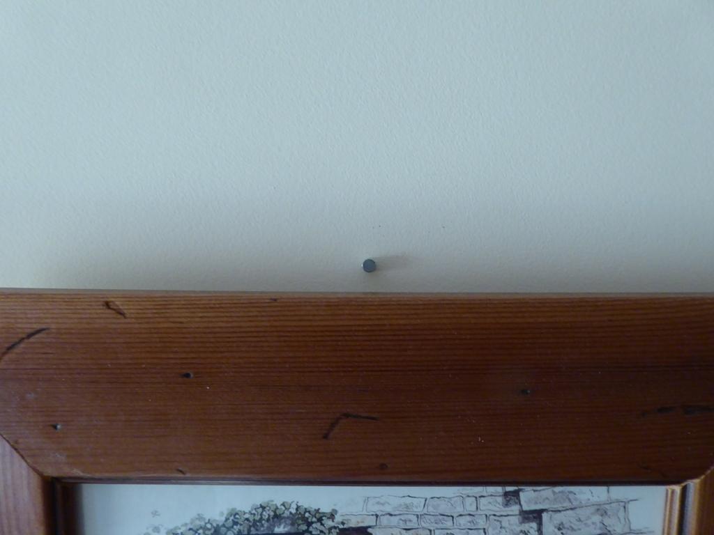

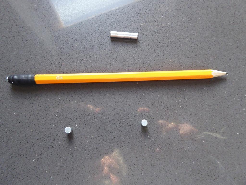

Jeremy Harris Posted January 8, 2019 Share Posted January 8, 2019 If you want to find the studs after the plasterboard is up, and you haven't marked the floor, then magnets work well. I have some pencils where I fitted neodymium magnets to the end, and these are great for finding plasterboard screws and a lot more accurate than using a stud finder. I also have a dozen or so left over magnets (small ones, around 6mm diameter x 6mm long, IIRC) that I use as markers. They will just stick to the wall wherever there is a plasterboard screw, so I can put several in place to show where all the screws/studs are without marking the paint finish. 1 3 Link to comment Share on other sites More sharing options...
Jeremy Harris Posted January 9, 2019 Share Posted January 9, 2019 Here are some photos I've just taken showing the small magnets being used to find the centre of a stud: and this is one of the pencils I made up with a magnet in the end to find screws, pick up dropped screws etc, plus some of the small magnets: 4 Link to comment Share on other sites More sharing options...
