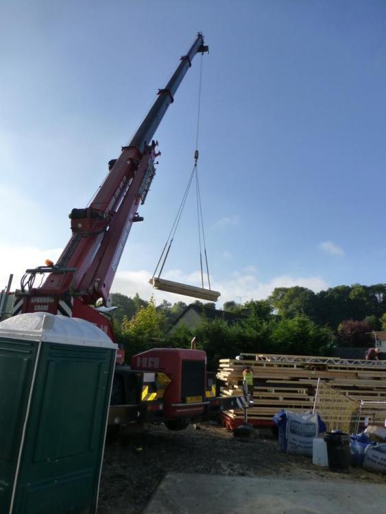

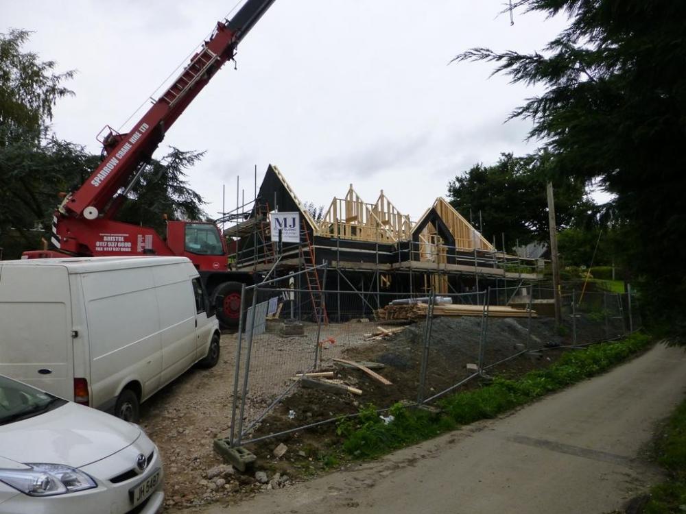

Jeremy Harris Posted January 6, 2019 Share Posted January 6, 2019 5 minutes ago, Dreadnaught said: I have a mere single ticket price for the whole shebang, no breakdown. Same deal for us, five years ago. MBC provided everything except the scaffolding, skips and toilet. They organised the short wheelbase, long jib crane (drove all the way down here from Bristol) and measured up to make sure their artic could get down the very narrow lane (we had ~100mm of clearance either side at one point) and over the narrow bridge over the stream in front of our plot. I warned the neighbours that we were going to block the (very) narrow single track lane for a few hours beforehand, and all were OK. They shifted their cars out and parked them around the corner so they could get to them whilst we were faffing around getting the artic unloaded. FWIW, our lane is just about 2.75 to 2.8m wide where that 2.55m wide truck is backing in, so not exactly a lot of room to spare. The driver was damned good though, and made backing into that narrow space seem easy. The hardest part of the whole job was getting the crane into the site the evening before the truck arrived. The front of the crane was up tight against the scaff around the house, the back of the crane was right up against the garage slab. The crane managed to get up the 1:6 slope of our "drive" too... 1 Link to comment Share on other sites More sharing options...

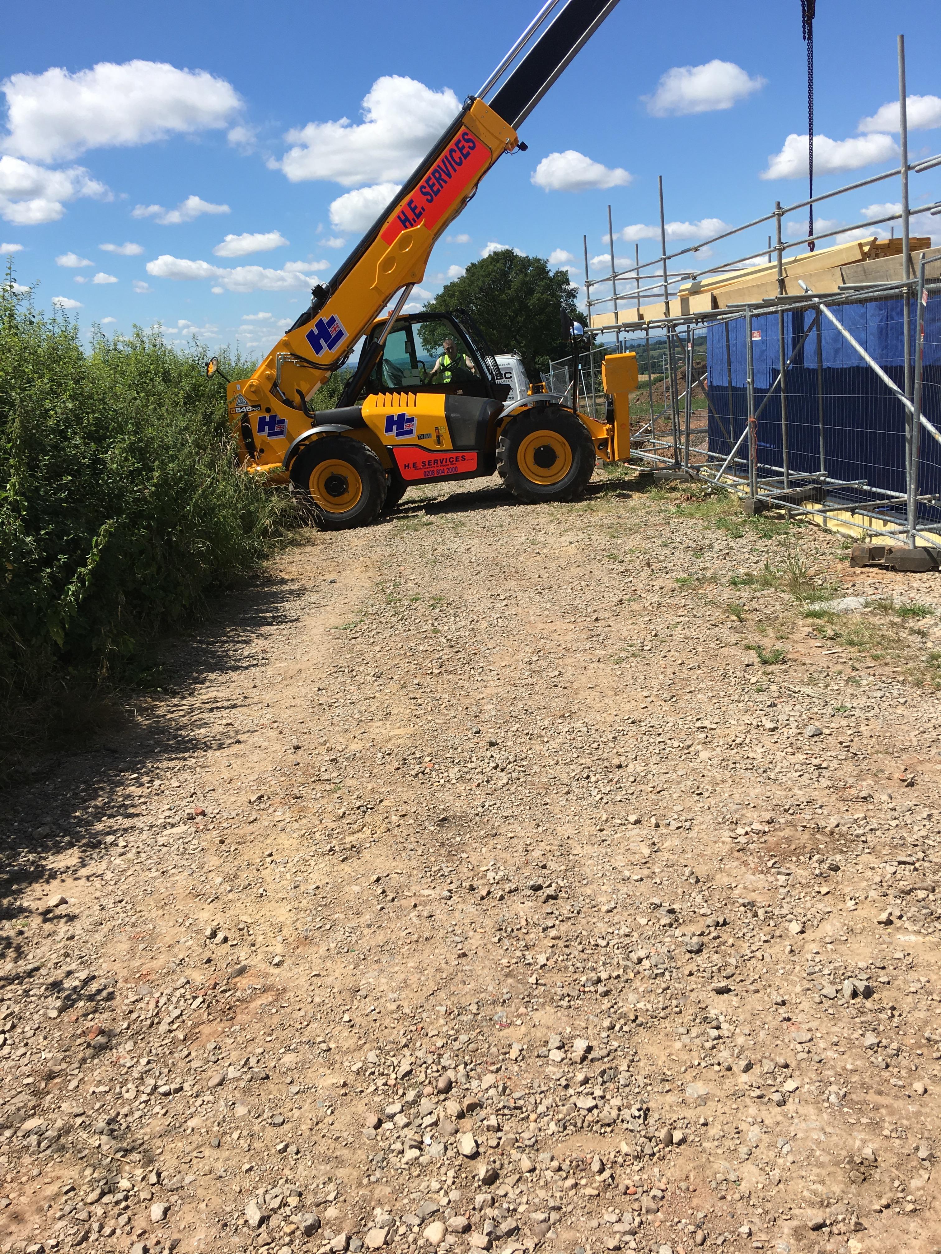

lizzie Posted January 6, 2019 Share Posted January 6, 2019 This was the machinery that was used by MBC to lift ours...quite small due to access restriction. Link to comment Share on other sites More sharing options...
Dreadnaught Posted January 6, 2019 Author Share Posted January 6, 2019 8 minutes ago, lizzie said: This was the machinery that was used by MBC to lift ours...quite small due to access restriction. Interesting. I don't think even that would fit on my site. 1 Link to comment Share on other sites More sharing options...
