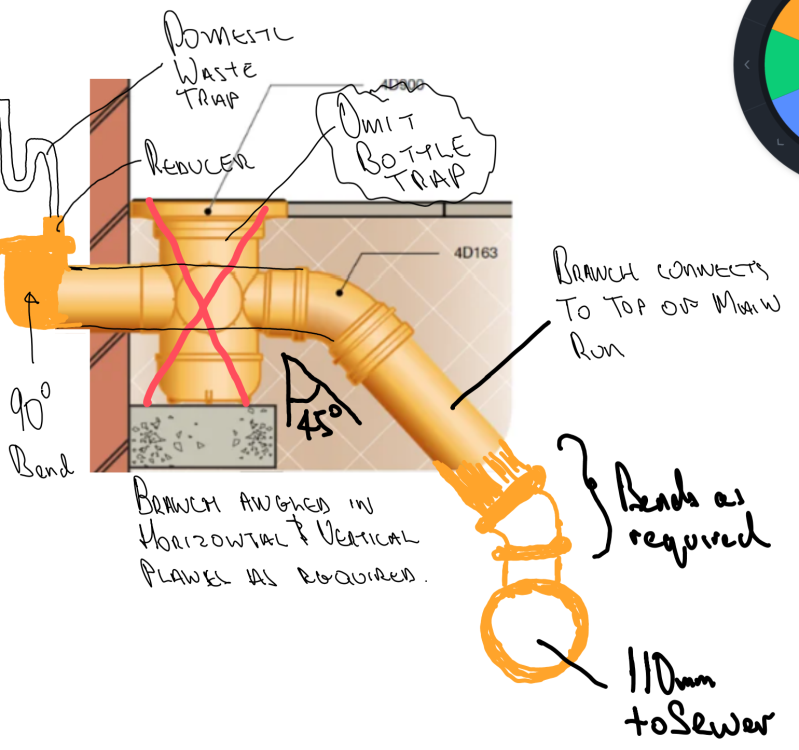

Looking to do a sanity check on the drainage arrangement above as its one I'd like to use in my current project.
Do I understand correctly that the domestic waste traps (kitchen sink, DW and washing machine) can be directly connected to a main sewer run via a suitable sized reducer on to a 110mm branch?
I imagine that the reducer provides a sealed connection and the trap on the domestic waste prevents foul gases escaping?
Yes 110mm to 40mm reducers are standard items and all sealed.  It does not even need a branch straight into the top of the 110mm might be okay in some situations.

Thanks Dave
That's very useful to know, helps my design along.
So I imagine my other arrangement will remain for RWPs and the version below (if I have interpreted correctly) will works for domestics
