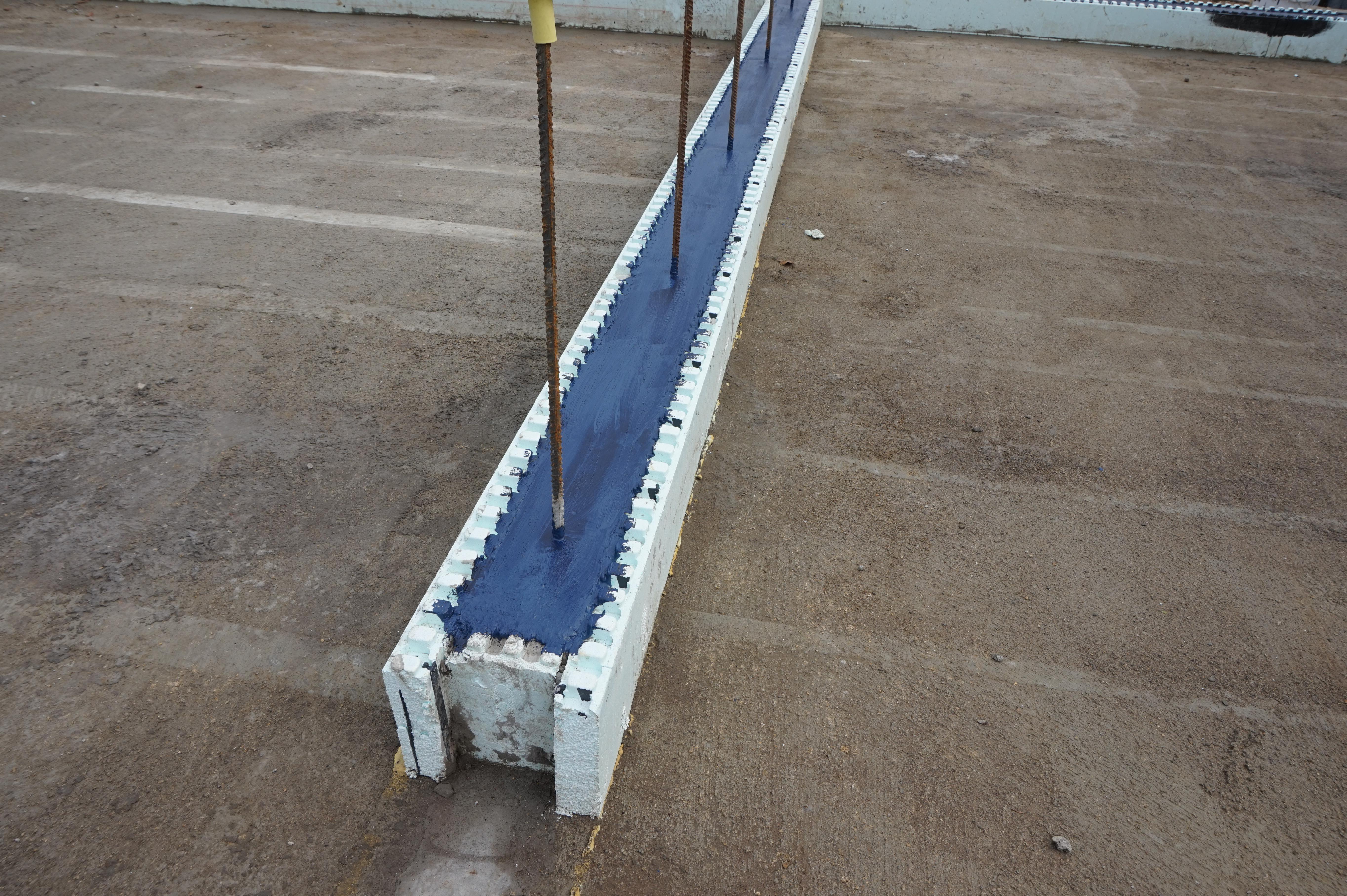

Morning one and all. For anyone who has already poured or are planning to for this construction type, in stages, have you employed a mechanical method to tie in one pour to the next, such as bar poked into the top of one pour which would then come through into the next?

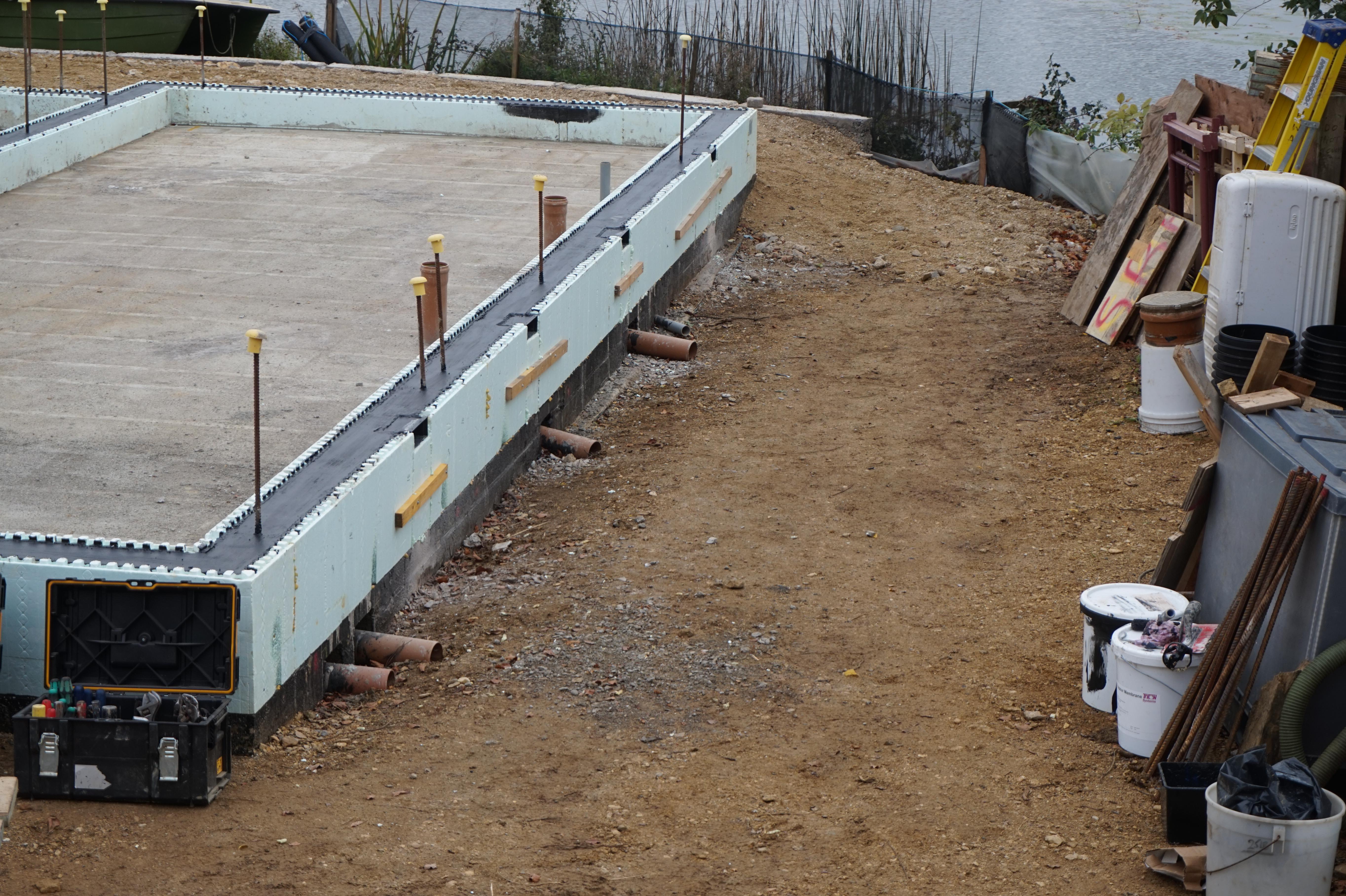

In the first pic these bars are not just pushed into the wet concrete, they are actually resin set into the foundation, and the concrete poured around them.
Random placing of rebar was dictated by window openings and small pillars of wall between windows. FC09CAB4-B17D-489E-9E94-6246CDBFB3FF.thumb.jpeg.c9b1fb9116267d75c758ae700ed75742.jpeg6AA5946C-3FE4-4D9F-9F22-16CB7BC1440A.thumb.jpeg.141b54a26fb15a88fa3b1a05c99b43f1.jpegHas your structural engineer not specifically asked for anything,
i put 16mm bar at the sides of all openings and at 1200mm spaces, if a small pier 3-400mm I have 2 vertices as you can see in first pic.
We have just just done our first pour at 2.7m above ffl and installed 12mm bar at 1m centres around the whole perimeter, but changed this out for 16 mm bar at window reveals for the second lift.
Hope that makes sense.

Seems like a prudent thing to do even if the SE doesn't require it. @Vijay other than around the openings and as you have described above, are you throwing any reinforcement at it. I know polarwall don't require it, but I can't myself get away from thinking that there's no harm in (figuratively speaking of course) throwing some in there, with the guidance of an SE, as a belt and braces approach.
