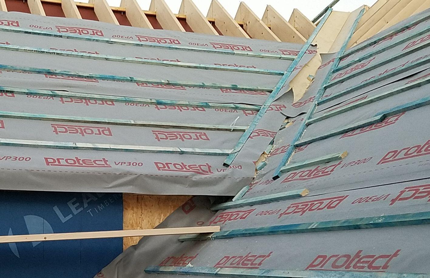

dpmiller Posted December 17, 2018 Posted December 17, 2018 Well not really, but this is the closest section I can think of to put the Q... Above our porch- and in a similar fashion at the rear of the house- we've small triangular areas that need building up as spandrel panels to continue a return block wall. Crappy photo of the scenario below, the blockwork will rise as a vertical edge to the left. So I've 150mm of depth to fill (100mm block + 50mm cavity). The outside will be half inch renderboard but what else? 140mm treated CLS straight onto the TF, or is some counterbatten a Good Idea? Studs are all 400ctrs max...

Mr Punter Posted December 20, 2018 Posted December 20, 2018 From outside render, renderboard, 38 x 50 counterbatten fixed with long screws through, membrane, Celotex - thickness to suit, existing timber frame.
dpmiller Posted December 21, 2018 Author Posted December 21, 2018 @Mr Punter I'm intrigued- why the Celotex? Seems like an expensive way just to make up depth and as all the specc'ed insulation is on the inside of the frame would this not require reconsideration of condensation risk? I presume that any airgaps in this built panel don't have to align with the TF-block cavity? On the render side of things, as we're undecided as to whether it'll be a simple sand and cement affair or a monocouche would it be safest to site the renderboard back behind the block a bit with EML on?
Mr Punter Posted December 21, 2018 Posted December 21, 2018 I suggested Celotex as dormer cheeks are often a lighter weight construction than the main walls - maybe 89mm - so sometimes the extra insulation can help prevent a cold spot. If you are planning on the render being continuous from blockwork to render board then you could look at stainless eml over the render board with a big lap onto the blocks or an expansion gap bead between the 2 materials. Another option may be to tile hang or lead clad this bit but it may look a bit crap.
dpmiller Posted December 21, 2018 Author Posted December 21, 2018 Rendered over with EML sounds like a plan... The portions I'm looking at are part of the main TF so 140mm with all the insulation package inside, so it really is just choosing a means of standing the render clear of the frame a distance to match the blockwork. They aren't even massive areas, perhaps 1.5m2 each panel. I do have one "normal" dormer to deal with at the back but that'll be easier to detail as there's nothing it needs to align with.
