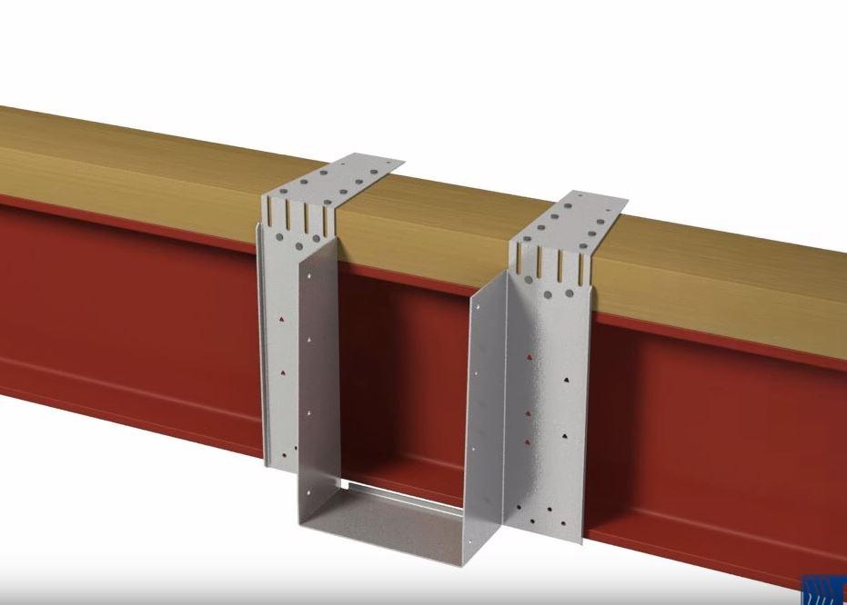

willbish Posted December 13, 2018 Share Posted December 13, 2018 (edited) Anybody have an opinion on this method fixing posi-joists to steel? I thought I would have to use a packer in the flange of the steel but seems not. Edited December 13, 2018 by willbish added tags Link to comment Share on other sites More sharing options...
Russell griffiths Posted December 13, 2018 Share Posted December 13, 2018 In my opinion Cullen make some fantastic products. I believe you would only need a packer if the hanger and joist did not extend down past the bottom flange if you read their Manuel carefully you will see each product needs to be used in strict accordance with its intended use. 1 Link to comment Share on other sites More sharing options...
Russell griffiths Posted December 13, 2018 Share Posted December 13, 2018 Can you not top hang them to save buying all the hangers. Link to comment Share on other sites More sharing options...
willbish Posted December 13, 2018 Author Share Posted December 13, 2018 2 minutes ago, Russell griffiths said: Can you not top hang them to save buying all the hangers. The bottoms of steel and joists are to be level 202mm joists high 162mm steel Link to comment Share on other sites More sharing options...
nod Posted December 14, 2018 Share Posted December 14, 2018 10 hours ago, willbish said: Anybody have an opinion on this method fixing posi-joists to steel? I thought I would have to use a packer in the flange of the steel but seems not. I used exactly this method on our floor joists But chose to bolt a timber in the rsj More for ease of fixing than anything else I asked the steel supplier to pre drill the holes prior to dipping and it took about 15 minutes per beam to bolt timbers in Once we had the in place Link to comment Share on other sites More sharing options...
Mr Punter Posted December 14, 2018 Share Posted December 14, 2018 We have done similar where we had some steel framework from the ground up to the first floor floor zone. We packed the webs with timber - shot fired - and face fixed the joist hangers so they could be levelled with the other ends of the joists which were sitting on a soleplate on masonry. Link to comment Share on other sites More sharing options...
