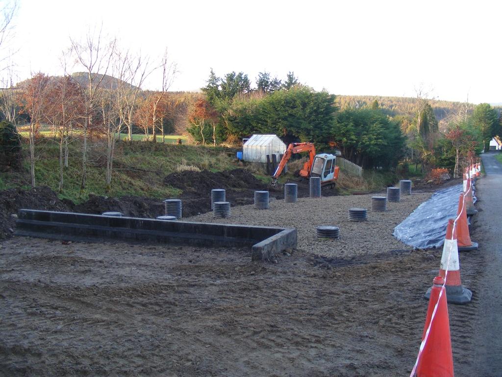

ProDave Posted November 30, 2018 Share Posted November 30, 2018 Your site looks similar to mine, except my slope was less, and the trees and the stream a bit further away. I considered a passive slab. The big problem for me, was you have to build up the ground with crushed stone etc and that has to extend a bit beyond the house area. So it would have ended up having raised ground all around the house, then sloping down further out to the lower ground level. In the end I did pretty normal strip foundations and a suspended insulated timber floor. The foundations were specified by the structural engineer and the only things he did a bit different to normal were a reinforcing mesh in the concrete pour of the foundations, and a strong concrete mix specified. A near neighbour to here built his house on a much more challenging small plot close to the burn and on a much steeper slope, he built his on piles. The builders dug down to pour a 1 metre square pad for each pile, then cast concrete piers using plastic drainage pipe as a former. I don't know the cost but I suspect not cheap, largely because they had to remove a lot of soil, store it elsewhere, then bring most of it back (I would have asked the local farmer if we could rent the corner of a field to store it locally instead) This is a picture of his piles before the house went on top: 1 Link to comment Share on other sites More sharing options...

PeterW Posted November 30, 2018 Share Posted November 30, 2018 Could build a retaining wall of gabions down toward the watercourse and then backfill for the slab - won’t go anywhere and it’s used fairly widely as a retaining section. Link to comment Share on other sites More sharing options...
Patrick Posted November 30, 2018 Author Share Posted November 30, 2018 6 minutes ago, PeterW said: Could build a retaining wall of gabions down toward the watercourse and then backfill for the slab - won’t go anywhere and it’s used fairly widely as a retaining section. That would be a great option, it is a bit similar then @JSHarrisdone it with his Wall in order to get the plot level. I think the small problem I have got is space- there is around 0.5-1 meter between the building and the Watercourse and there is a drop of around 0.8-1.2 meters . Would be obviously better to build a bit further away, but thats also not possible. I do however follow up on some advice and get Guys from MSS `mini`soil surveys in to give me advice with how to proceed . He has been recommended more then once on here . Link to comment Share on other sites More sharing options...
PeterW Posted November 30, 2018 Share Posted November 30, 2018 Is that a moving water course or a lake ..?? If it’s moving you will need to go with piles or similar as you will need to ensure the water can’t erode the bank. I’d be inclined to use shuttering piles to create the retaining wall and put the slab on top and you can go pretty much to the waters edge. Link to comment Share on other sites More sharing options...
Patrick Posted November 30, 2018 Author Share Posted November 30, 2018 16 minutes ago, PeterW said: Is that a moving water course or a lake ..?? If it’s moving you will need to go with piles or similar as you will need to ensure the water can’t erode the bank. I’d be inclined to use shuttering piles to create the retaining wall and put the slab on top and you can go pretty much to the waters edge. it s moving water, even though very small ( it s a little stream , around 0.5meters wide, 0.3m deep max.) . Good Idea , I will look into this Link to comment Share on other sites More sharing options...
