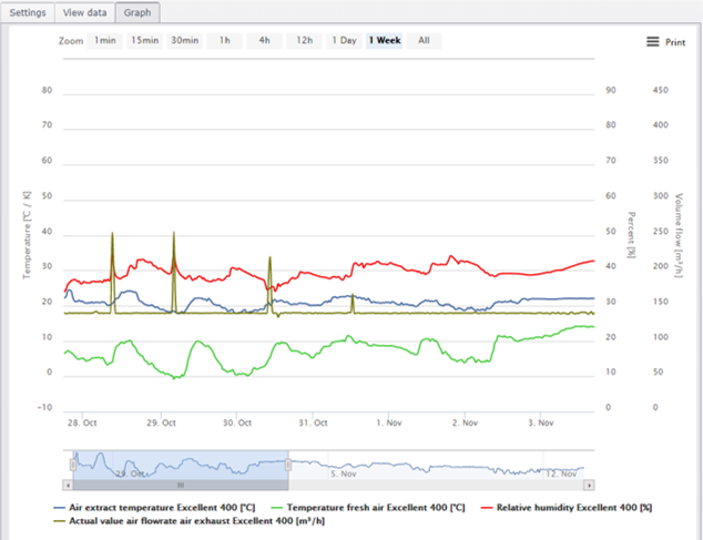

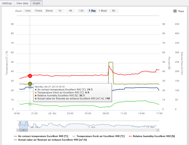

le-cerveau Posted November 13, 2018 Posted November 13, 2018 (edited) I use RH sensors, I have 2 x Brink Renovent Excellent 400 Plus models one for Upstairs one for Downstairs with the options RH sensors fitted into the extract duct just before the unit. The first diagram shows a weeks recordings of the downstairs unit and you can see my mum going into the shower each morning and the MVHR ramping up. The second is an expansion of the first 24 hours: This works perfectly for me and allows me to run the system at a lower rate, it ramps up to the Building regs required extract rates. and still has more if required. The house was over warm at this point and I have since corrected the temperature to a more norman 21oC from 24oC Edited November 13, 2018 by le-cerveau
