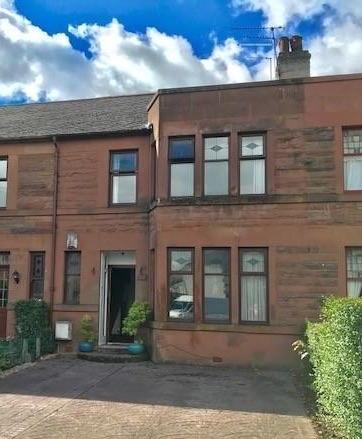

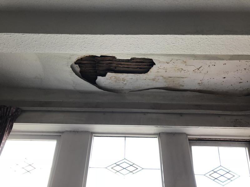

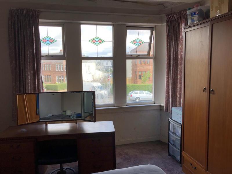

Iain M Posted November 6, 2018 Author Share Posted November 6, 2018 It's a mid-terrace sandstone house. Here's the estate agent's picture, on a suspiciously bright sunny day: Definitely needs a lot of TLC inside: That flat roof section at the front had a serious leak, which is the main reason the house was relatively affordable: We've fixed that leak and had the timbers surveyed, and it should be safe for the winter. So now we can concentrate on what kind of renovation we want. Looks like the work might divide into two parts: - Renovate the upper floor and the front (can be started ASAP) - New kitchen and extension at the rear (building regs required) Being a mid-terrace has upsides and downsides. In terms of insulation, I think we mainly just need it at the front (since the rear extension will be to higher modern specs). So I think we just go with internal insulation and lose a little bit of length. New windows throughout, better loft insulation, and we should be in a good place. Link to comment Share on other sites More sharing options...
