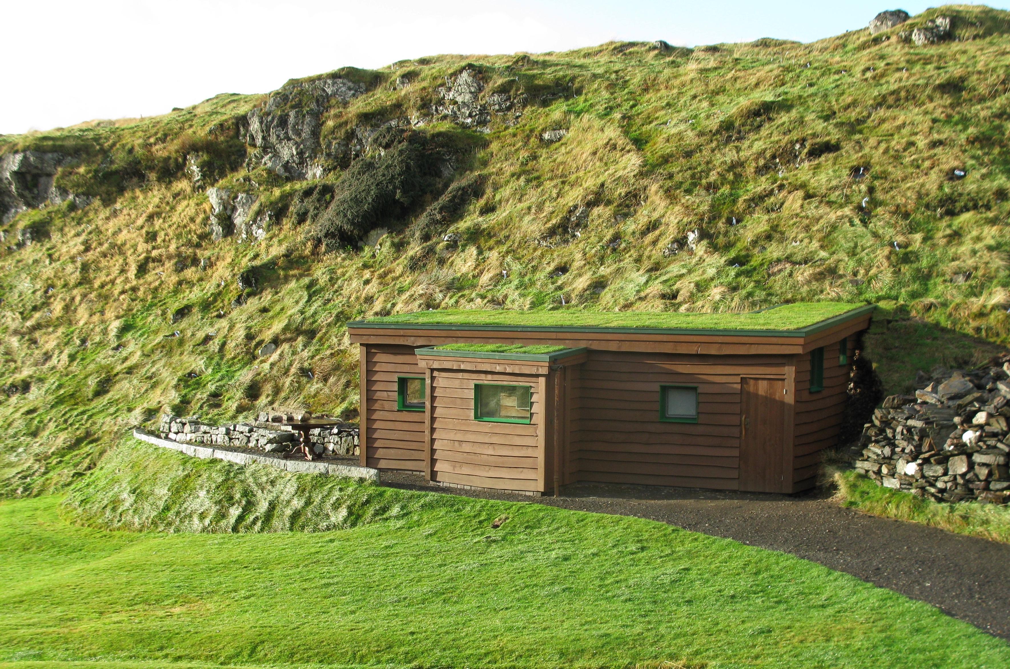

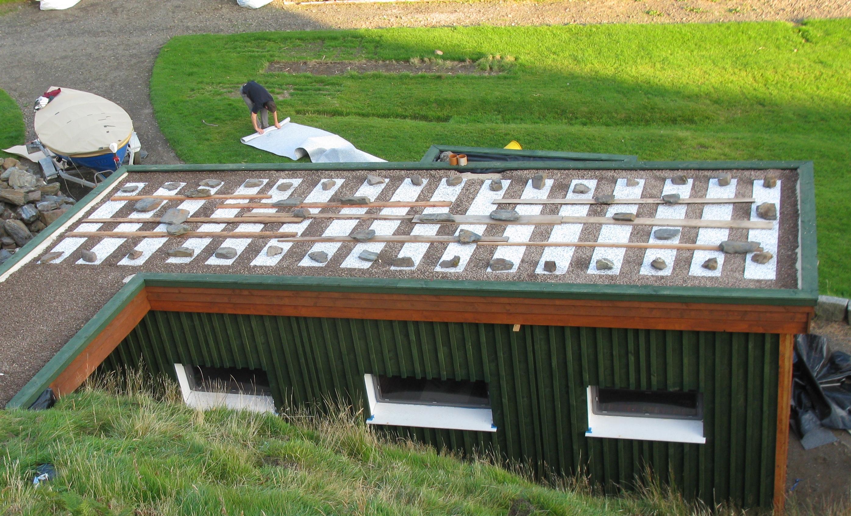

Cpd Posted November 2, 2018 Share Posted November 2, 2018 I turfed my cabin roof, the build up was. Vented void sarking boards underlay heavy gauge plastic x2 layer pond liner x 1 layer old wool carpet Ground fabric 25mm pea gravel for drainage and polystyrene to reduce weight More ground fabric 70mm turf this was a total diy job and done as a bit of fun. It works great and yes it dies back in drought but regrows within weeks. Stops the sound of rain and helps to keep temperatures stable. Heath Robinson but works great and people love the look. 2 Link to comment Share on other sites More sharing options...

kaygoo Posted December 24, 2018 Author Share Posted December 24, 2018 (edited) On 02/11/2018 at 21:12, Cpd said: I turfed my cabin roof, the build up was. Vented void sarking boards underlay heavy gauge plastic x2 layer pond liner x 1 layer old wool carpet Ground fabric 25mm pea gravel for drainage and polystyrene to reduce weight More ground fabric 70mm turf this was a total diy job and done as a bit of fun. It works great and yes it dies back in drought but regrows within weeks. Stops the sound of rain and helps to keep temperatures stable. Heath Robinson but works great and people love the look. Thanks for that - that's really useful Sorry about the delay in replying. Not getting notifications for some reason. Edited December 24, 2018 by kaygoo Link to comment Share on other sites More sharing options...
