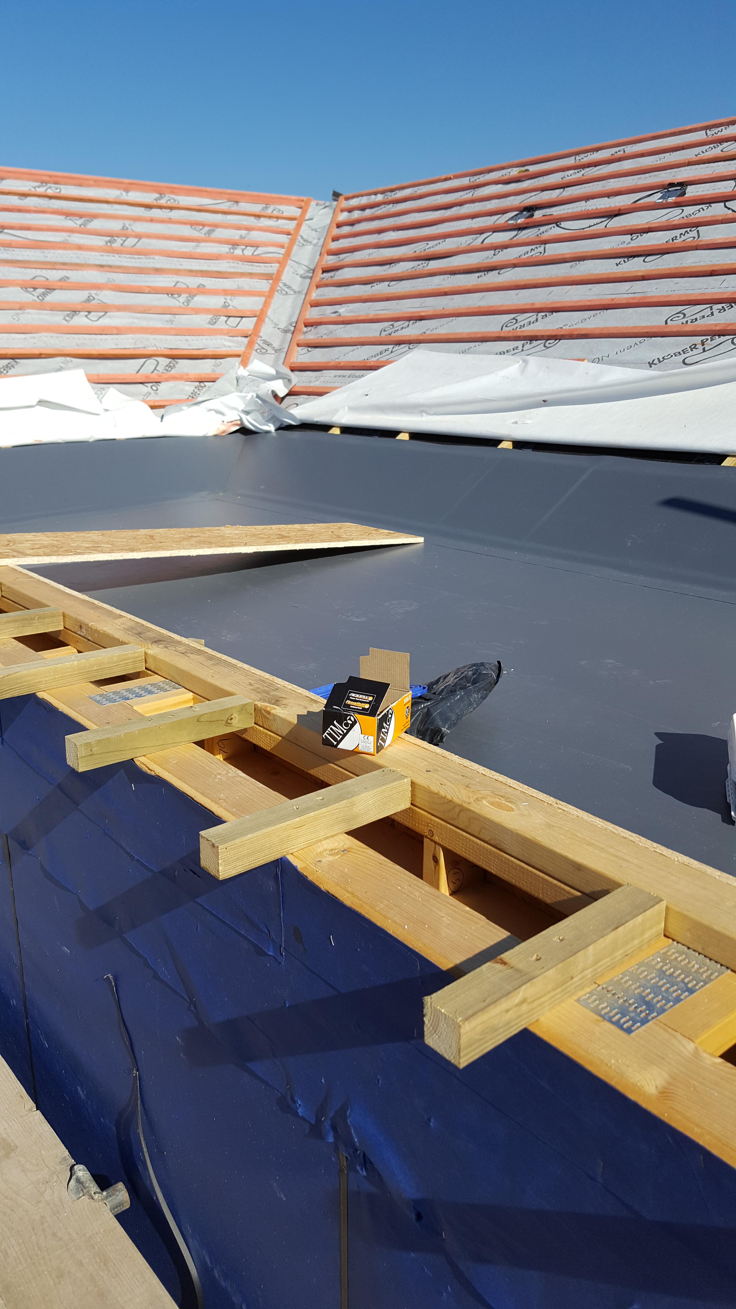

vivienz Posted November 1, 2018 Share Posted November 1, 2018 Following on from the insect mesh query, before I put that up I want to do a bit of cosmetic work on the battens that support the parapet capping. These can be seen from the underside and the untreated timber will be visible even through the insect mesh so I want to paint it dark grey. Is there any particular procedure or paint type that I need to use for this? This a photo of the battens as they were being put on and it's the underside ends that can be seen. Link to comment Share on other sites More sharing options...
Nickfromwales Posted November 1, 2018 Share Posted November 1, 2018 Wrap them in off cuts of the flat roofing grey membrane ? Link to comment Share on other sites More sharing options...
Ferdinand Posted November 1, 2018 Share Posted November 1, 2018 (edited) Personally I wouldn't paint them. Blowtorch to scorch? Or an external beathable dark stain? I think the stain would last better, and would darken further over time. (test first on an offcut) Edited November 1, 2018 by Ferdinand 1 Link to comment Share on other sites More sharing options...
Onoff Posted November 1, 2018 Share Posted November 1, 2018 Bedec been paint? Reassuringly expensive... Link to comment Share on other sites More sharing options...
lizzie Posted November 1, 2018 Share Posted November 1, 2018 (edited) We used Dulux weathershield had it mixed to ral colour - your grey looks similar to ours. Ours mix was for Ral 7012. We had 7016 on windows etc but roof a lighter grey...lead grey which is 7012. Edited November 1, 2018 by lizzie 1 Link to comment Share on other sites More sharing options...
