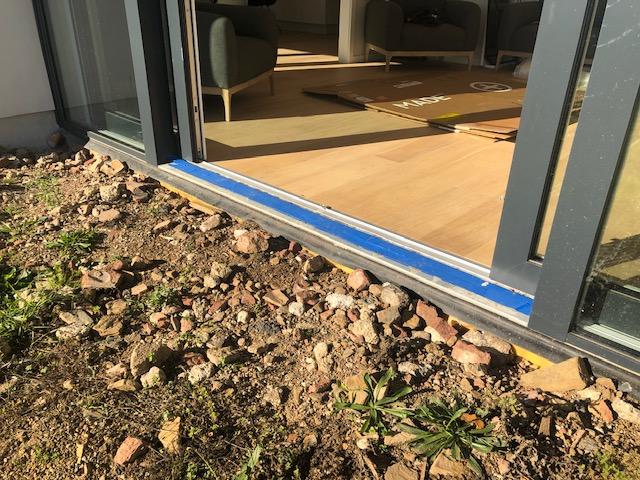

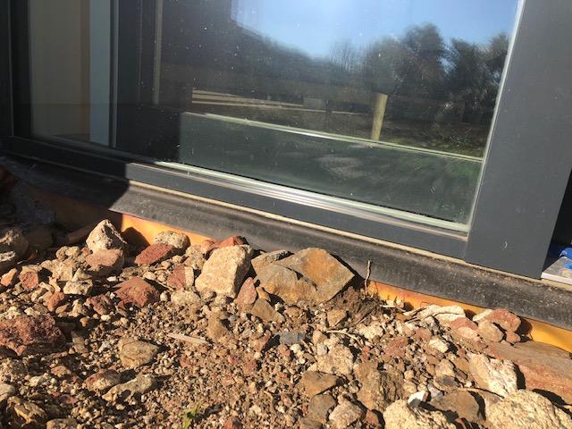

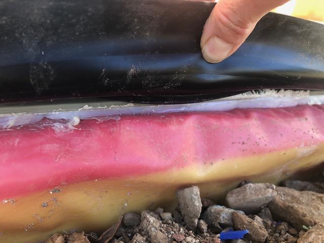

Barney12 Posted October 30, 2018 Share Posted October 30, 2018 OK, so the short answer to your question is; I don't have any drainage! I'm wondering if your sliders are a different design/specification as the more I look at mine I just cant see why any drainage is required. Unlike the patio doors (and windows) which open inwards there isn't the opportunity for water to get past the external seals and into the void/gap before the next set of seals. Here are some photo's: You can see in the above image that my internal floor is flush with the cill/frame. Here's the outside. The patio slabs will sit flush with bottom of the silver threshold you can just see to the right. In between the two will be a micro slot drainage system just so any water that does head in that direction is diverted away. Although not required I've also specified free draining gravel around the entire perimeter of the house. This is a view under that black rubber skirt (which is simply a strip bonded on with silicone, fairly pants design really!). The slider is sat bridged between the concrete slab and the EPS. The red membrane you can see is our radon barrier. Link to comment Share on other sites More sharing options...

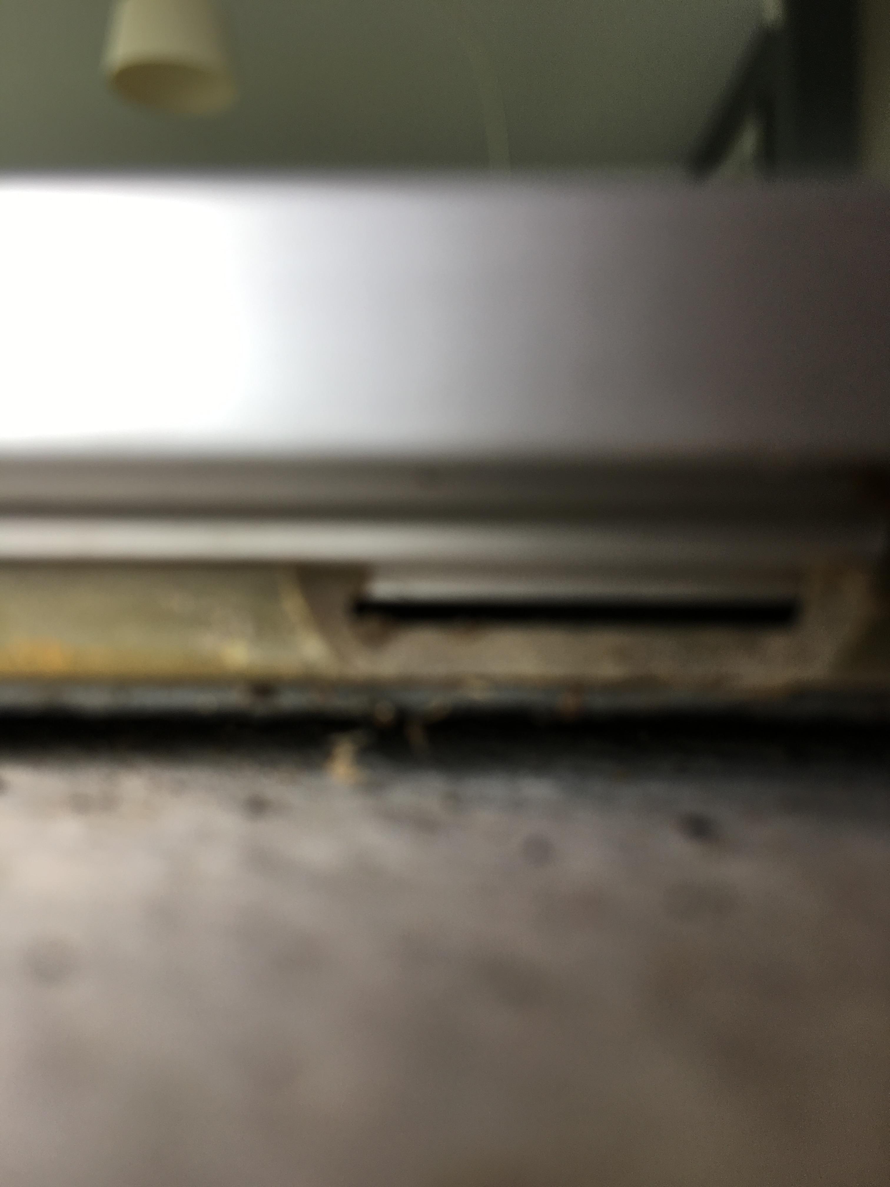

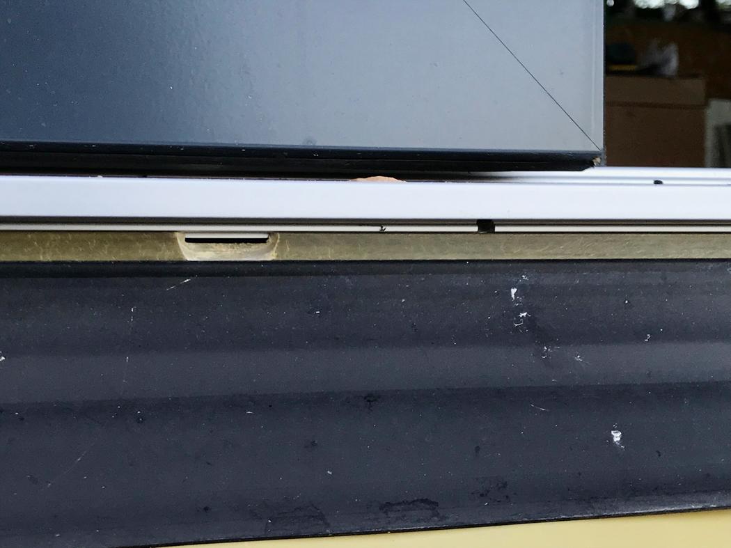

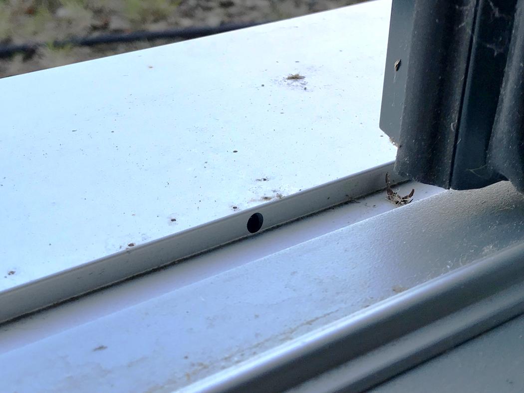

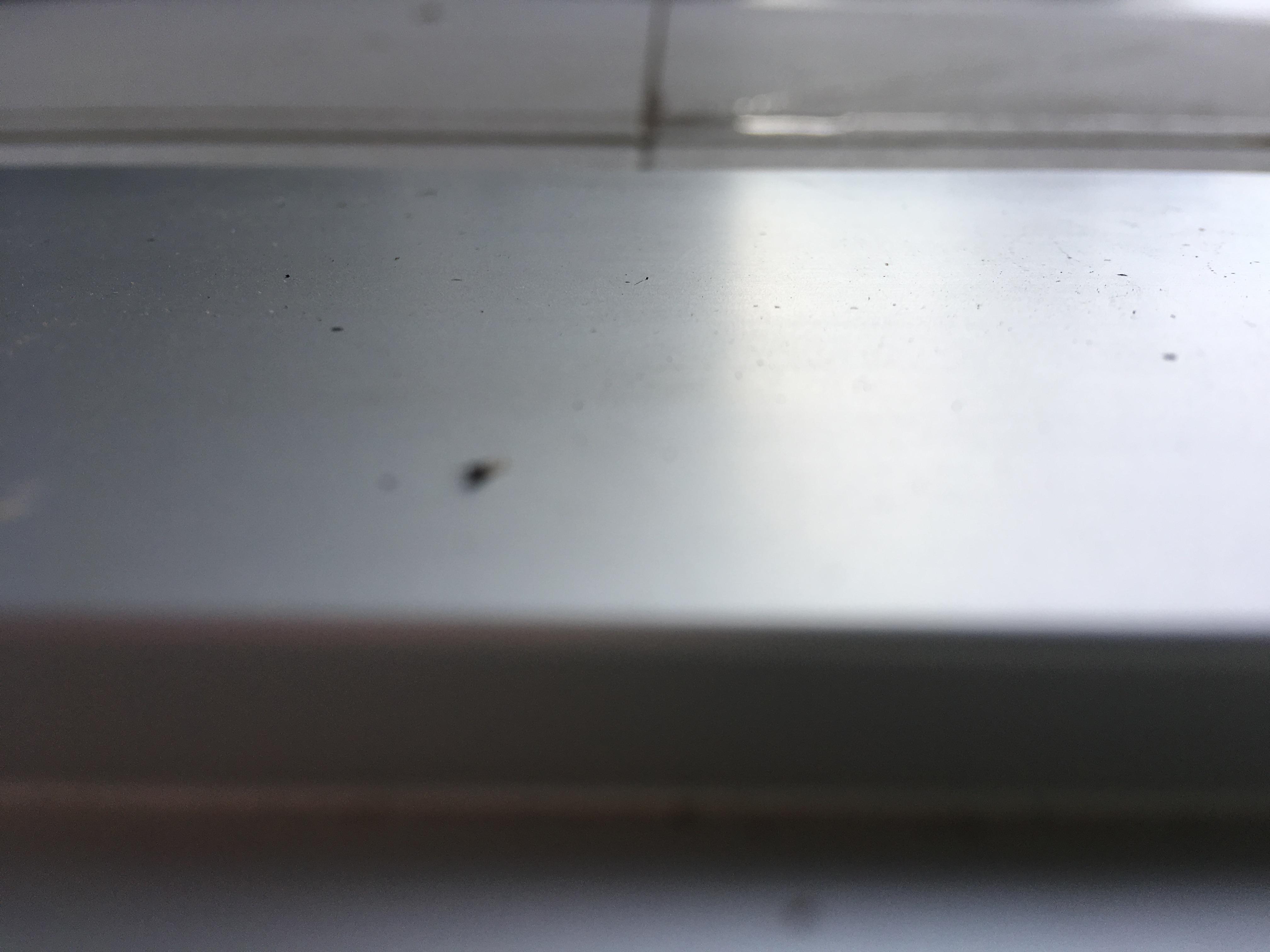

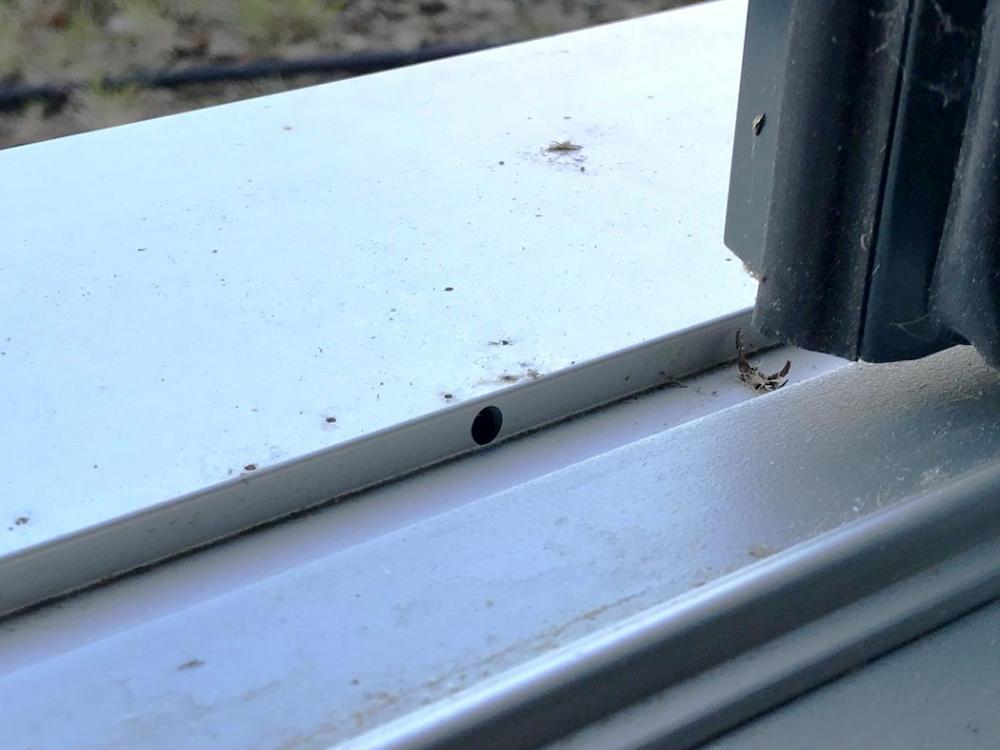

JamesP Posted October 30, 2018 Share Posted October 30, 2018 @lizzie @Barney12 Thought I would join in as I have Internorm HS330 sliders. Enclosed are 2 photographs. 1547 is shot from inside looking out and shows a small circular hole. I assume this is to drain any rain which hits the glass and drains outside above the rubber strip. 1544 the drainage slot to the outside and runs down the outside of the rubber curtain. Does this help? Link to comment Share on other sites More sharing options...
lizzie Posted October 30, 2018 Author Share Posted October 30, 2018 (edited) 5 minutes ago, JamesP said: @lizzie @Barney12 Thought I would join in as I have Internorm HS330 sliders. Enclosed are 2 photographs. 1547 is shot from inside looking out and shows a small circular hole. I assume this is to drain any rain which hits the glass and drains outside above the rubber strip. 1544 the drainage slot to the outside and runs down the outside of the rubber curtain. Does this help? perfect pictures of the drainage thank you and actually it is showing some more holes on the underside I have not yet seen on mine...I have to lie on floor with torch to spot them. Will go out tomorrow and see if I can get them all marked up. Your is very neat mine is extremely battered and rough underneath. See you got the membrane on too. Must have had decent installers! Edited October 30, 2018 by lizzie Link to comment Share on other sites More sharing options...
