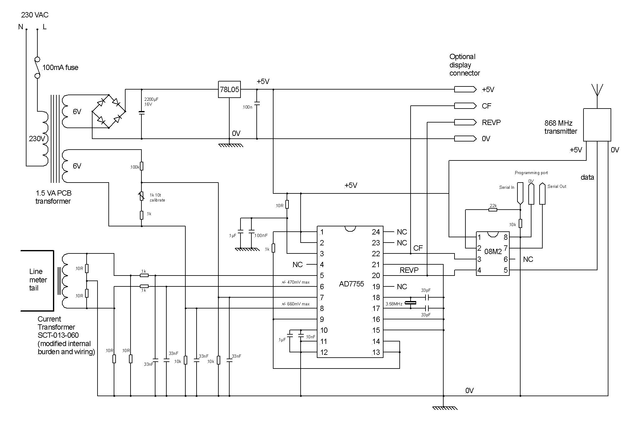

You might also want to look at energy metering chips, as used in electricity meters.  They are dirt cheap (around 50p or so) and have pretty accurate 16 bit A/Ds for measuring voltage and current at a fast sample rate (much, much faster than something like the Open Energy Monitor, that uses the Arduino A/Ds).  I'm using an Analog Devices AD7755 (now obsolete, but there are loads of others around) which measures current and voltage right at the meter and sends instantaneous power data back to the house via an 868 MHz data link.  Anything can then use that data.  I have a display unit built in to a plug top that shows import/export plus the power, the house data logging system records the data and also the PV diverter unit uses the data to turn the Sunamp heating element on and off, via a 20 A SSR.
It would be dead easy to add one of these metering chips to something like an ESP8266, as the output is a pulse train with the frequency proportional to power plus a pin that indicates direction.  No need to break into the meter tails, either; I use a 100 A current transformer for the current signal and a small mains transformer to give the voltage signal.  This old datasheet for the AD7755 might be of interest: AD7755.pdf

Guest Alphonsox
They are still available - I bought a bunch from China via Ebay a month or so ago. The big advantage is that they are still available in DIP packages rather than the more modern versions which only seem to be available in surface mount.
https://www.ebay.co.uk/itm/1PCS-AD7755AAN-AD7755-Energy-Metering-IC-with-Pulse-Output-/221119026566?hash=item337bb89586

Yes, you can.  The only thing to watch is the effect of small changes in current demand by the electronics, which changes the sampled voltage.  I got around this by using a transformer with two separate secondary windings for the power supply, as the voltage drop is almost entirely due to the winding resistance.  This is the circuit diagram for my unit; the PIC outputs serial data to the wireless link.  The local display port connects to a small LCD with another PIC that translates the frequency and direction signals into import/export power:

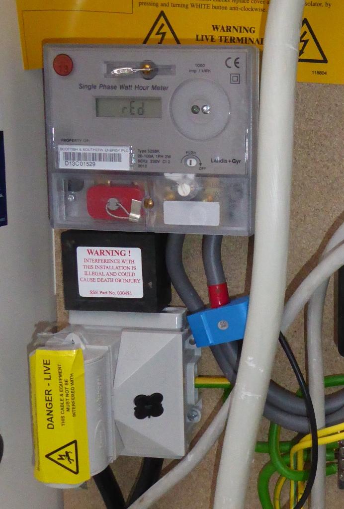

Jeremy's solution is very elegant but is also invasive in that it involves intervention in the primary power circuit, and this is something that I would prefer to avoid which is why I tend towards pulse counting as this still gives me 0.001kWh granularity.
No, it doesn't require anything other than clipping a current transformer core around the meter tail.  I have the power cable for the unit hard wired to a 6 A DP RCBO, but it could just as easily be wired to a 13 A plug to power the unit and obtain a voltage reference.
This is the clip-on current transformer I used, which is similar to those used by PV diverters: http://vctec.co.kr/web/product/yhdc/pdf/SCT013.pdf
Here's a photo of the (blue) clip-on current transformer in the meter cabinet:
622864063_Clip-oncurrenttransformeronmetertail.thumb.JPG.17a8666609bd40be1c5c22f0d71d7478.JPG

How easy was it to modify the internal resistors in the current transformer? The ones I've come across seem to be entirely sealed.
Link to comment
Share on other sites
Dead easy on this one, as the case is just clipped together.  Inside there is a small circuit board with the burden resistor and lugs and strain relief for the two core cable that's normally fitted.  I removed the cable and burden resistor and fitted a three core screened cable and two burden resistors in order to get the balanced signal needed to feed the AD7755.  These current transformers are readily available on eBay, just search for SCT-013 and loads will pop up, with different current ranges.
