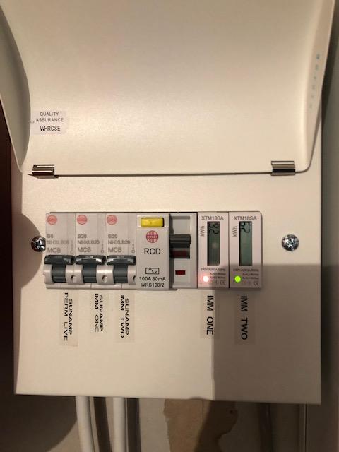

Barney12 Posted October 24, 2018 Posted October 24, 2018 So it looks like I’m going to need to get two 16amp immersion’s circuits into the plant room. Currently it’s just one fed from a 2.5mm radial on its own 20amp RCBO. The cable run is pretty short only about 4m. I don’t have any spare RCBO spaces in the consumer unit so Im thinking a few possible options: 1. Make the circuit a ring and upgrade the RCBO to 32amp 2. Upgrade the cable to 4mm and keep it as a radial with a 32amp RCBO 3. Upgrade the cable to a 4mm ring with a 40amp RCBO I think technically the RCBO needs to be 40amp as the circuit would have two 20amp double pole switch. Thoughts?
Jeremy Harris Posted October 24, 2018 Posted October 24, 2018 Firstly, the RCBO is primarily there to protect the cable running from it, so needs to be a lower current than the maximum rating for the cable, allowing for derating factors that are determined by the mounting and location of the cable. A ring final is not a good idea, or normal practice, for a heating circuit, it needs to be a radial. Two immersion heaters will draw less than 30 A in practice, under any condition, but 30 A is above the rating for 2.5mm² T&E cable when clipped directly (maximum is 27 A if there is no insulation around the cable). 4mm² T&E is rated at 37 A when clipped directly (installation type C), but that drops to 27 A if it is behind plasterboard that has insulation against the cable (mounting type 100), so before determining the cable size the mounting method needs to be known. If you can run the cable using either type A, B or C mounting, (in conduit, enclosed in conduit in a wall or clipped directly), then 4mm² is OK, but the RCBO needs to be 32 A, not 40 A, as 40 A isn't a low enough rating to protect the cable.

Onoff Posted October 24, 2018 Posted October 24, 2018 You could likely replace the rcbo with a suitable sized breaker then feed a small local cu incorporating a couple of rcbos... Then if one goes down it won't affect the other. 1
Nickfromwales Posted October 24, 2018 Posted October 24, 2018 On 24/10/2018 at 07:56, Onoff said: You could likely replace the rcbo with a suitable sized breaker then feed a small local cu incorporating a couple of rcbos... Then if one goes down it won't affect the other. Expand I was just about to say that One 32a / 4mm2 cable and split them locally.
Onoff Posted October 24, 2018 Posted October 24, 2018 On 24/10/2018 at 08:28, Nickfromwales said: I was just about to say that One 32a / 4mm2 cable and split them locally. Expand Don't know what his earthing system is but it might be advisable to run that 4m of cable in "earthed metallic" something as it won't be rcd protected if off a breaker. Pedantic?

Barney12 Posted November 10, 2018 Author Posted November 10, 2018 Job done as per the recommendations on this thread. There's a fair bit of thread cross over with the thread on energy monitors (here) I'm not so happy that the 4mm cable seems to run "warm" when pulling for both immersions. Is that normal?
Onoff Posted November 10, 2018 Posted November 10, 2018 You could slap a clamp meter on an d see what the cable is taking in reality if worried.What's the nominal A requirement quoted for the Sunamp's permanent live?
Jeremy Harris Posted November 10, 2018 Posted November 10, 2018 The permanent line is internally fused at 3 A. The heating element switched line runs a 2.8 kW at 230 VAC heating element, so around 13 A at 240 VAC. I doubt that the permanent line current ever gets over around 100 mA, despite being fused at 3 A, as all it runs is the 6 W nominal control circuitry plus the relay that switches the heater on and off. Two Sunamps charging at the same time will draw around 26 A or so, well within the rating for 4mm2 T&E, clipped direct, and just about OK for 2.5mm2, although too damned close to be used in practice.
