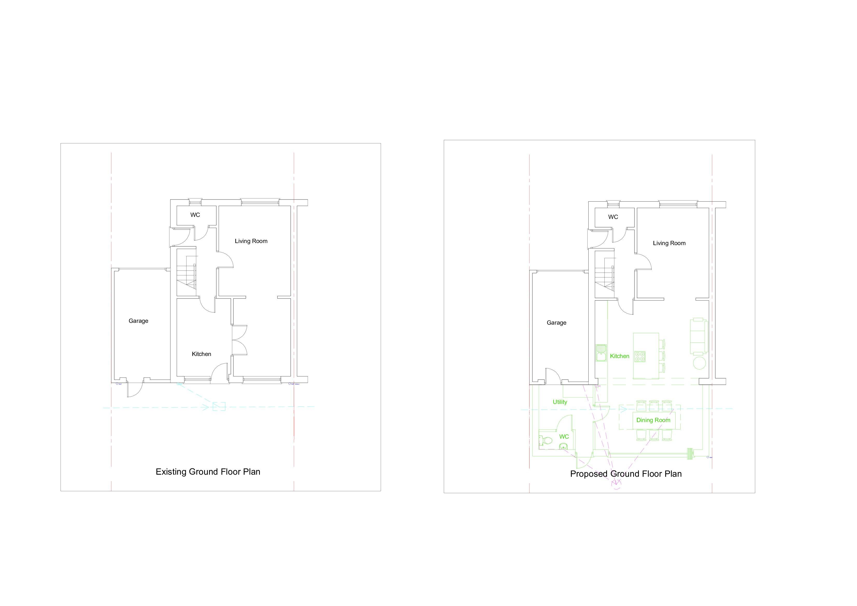

JGB Posted October 21, 2018 Posted October 21, 2018 Hello I have an issue that I am unsure how to solve. I am looking to get a single storey extension added onto my property. Please see attached floor plans, existing and proposed. The extension would be over a public sewer (blue), therefore I need a build over agreement. I have decided to have the manhole moved to form a new y junction onto the main public sewer. I have new foul water pipes (pink) going to the new inspection chamber from the 1 Existing SVP pipe 2 New Utility (I was told by my architect that I could not simply join it to the existing SVP for some reason, blockage) 3 New WC. I noticed that a lot of the new pipes are going either under or over the existing public sewer pipe. Is that acceptable or even possible?? Would it be possible to simply join the utility piping to the WC piping and route the foul water out that way? Will and inspection chamber actually be able to accommodate that many pipes at that angle? All seems a bit confusing to me so any help would be greatly appreciated.
Mr Punter Posted October 21, 2018 Posted October 21, 2018 The new IC will be fine in terms of inlet numbers and angles. It is important to check invert levels but the connections from the utils and kitchen will be above the main sewer pipe and the connection from the new IC to the sewer will either be at the same level or on top if it is a saddle onto a larger pipe.

Mr Punter Posted October 21, 2018 Posted October 21, 2018 Most of the plastic 450 chambers have inlets at 90 deg to the main channel. The outlet has to be from the main channel but you can put a 45 deg bend on it and still rod OK. You can also put a 45 on the inlets, so lots of flexibility. 1

Russell griffiths Posted October 22, 2018 Posted October 22, 2018 a modern plastic chamber looks like this, so as @Mr Punter said pipes can enter at 90 to the main drain run, you can also add an angle joint on the entry and exit pipes to vary the inlet route. the ic in the pic is a 320mm a 450mm looks a little different as they can have a lower exit pipe. Have a look for some images and it will give you a feel for the parts available. 1

PeterW Posted October 22, 2018 Posted October 22, 2018 Chambers such as the one linked usually come with 4 or 5 bungs fitted as it’s rare to use all of the inlets. Bear in mind it all has to be a minimum of 50mm above the main sewer level - you can’t rest pipes on each other so all of your house levels have to come in I would expect 200mm above sewer level to start with. I would also put long slow bends on any run into the chamber so they can be rodded easily from the chamber. No idea why your architect is saying use separate flows for the stacks either - I prefer using a combined stack as you know it’s going to be continually flushed through and less likely to get blocked by infrequent use. 1

PeterW Posted October 22, 2018 Posted October 22, 2018 Decent rods will flex - I would be running straight from the IC and the only angle would be the 45 going into the main sewer run.
