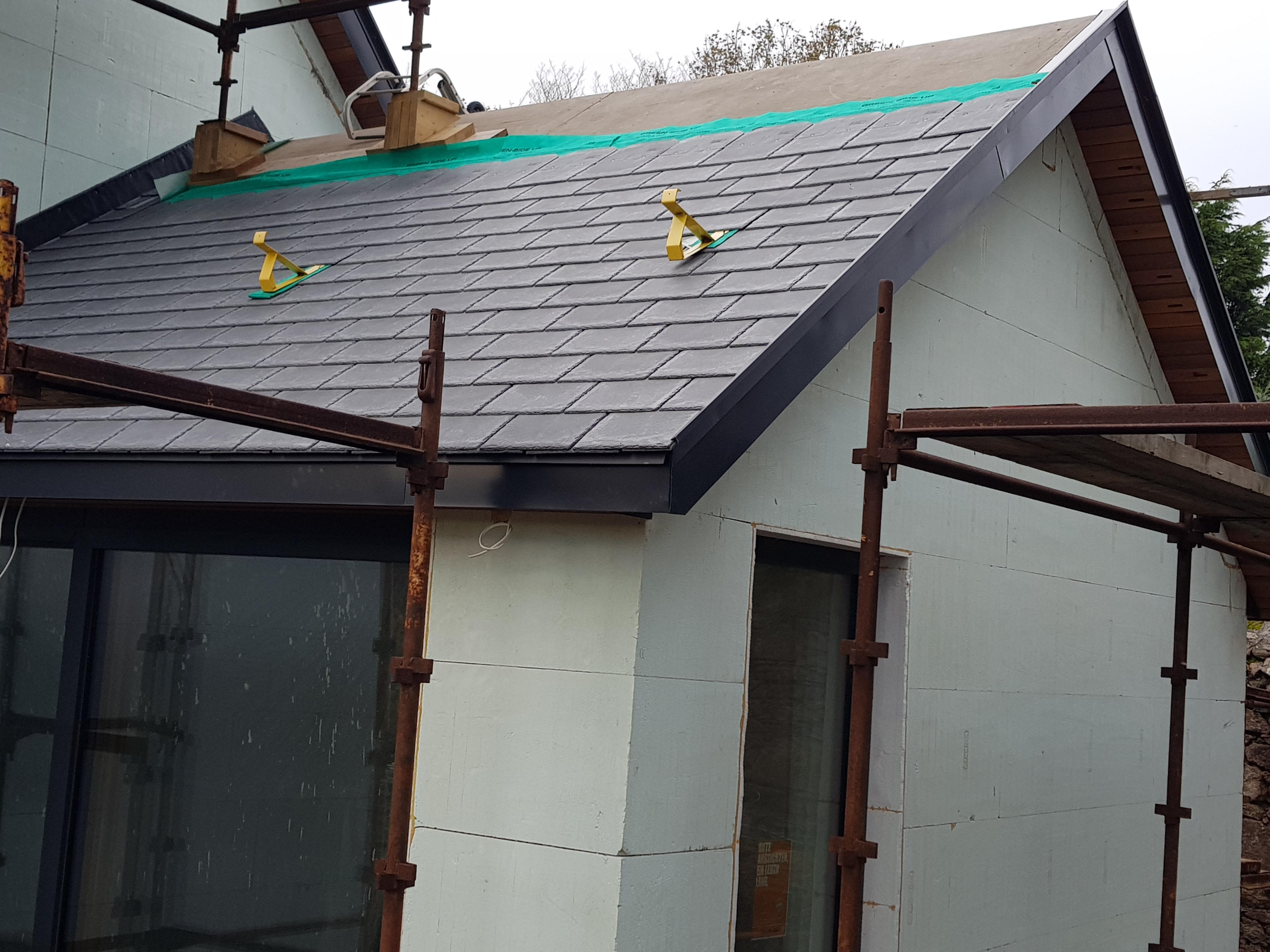

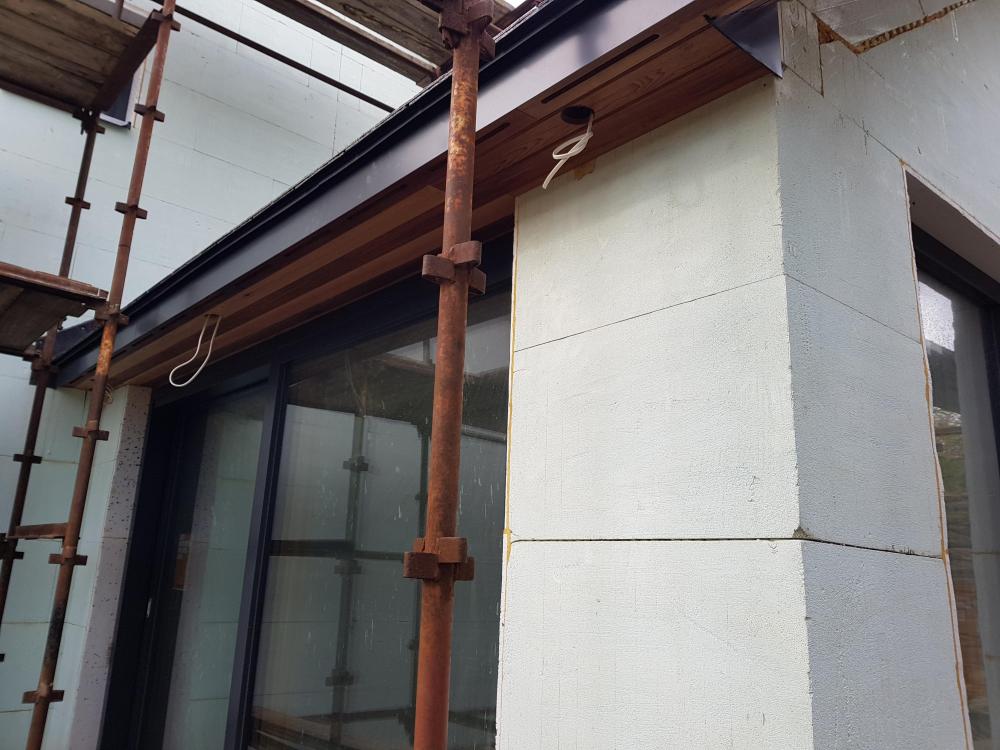

Posted
We used two suppliers but kytun was better as the metal was thicker and there was a slight difference in RAL7016 from both suppliers. I designed a profile that hide all nail heads. The corners where very tricky as we folded them on site.
Tbh we where making it up as we went along and made a few mistakes Inc our woodwork not being perfectly straight.
