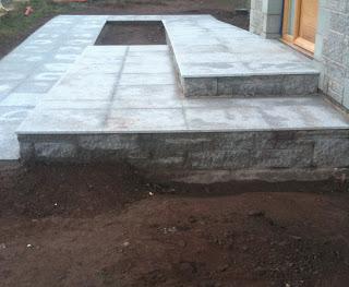

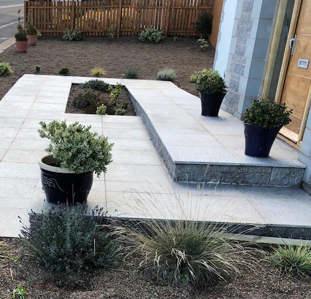

We had to do something a bit more ramp like as the incline was too great for a single gentle ramp. It doesn't look too bad now that there is gravel and plants however. It's been used a couple of times for deliveries but other than that no one has been here in a wheelchair in 8 years.
