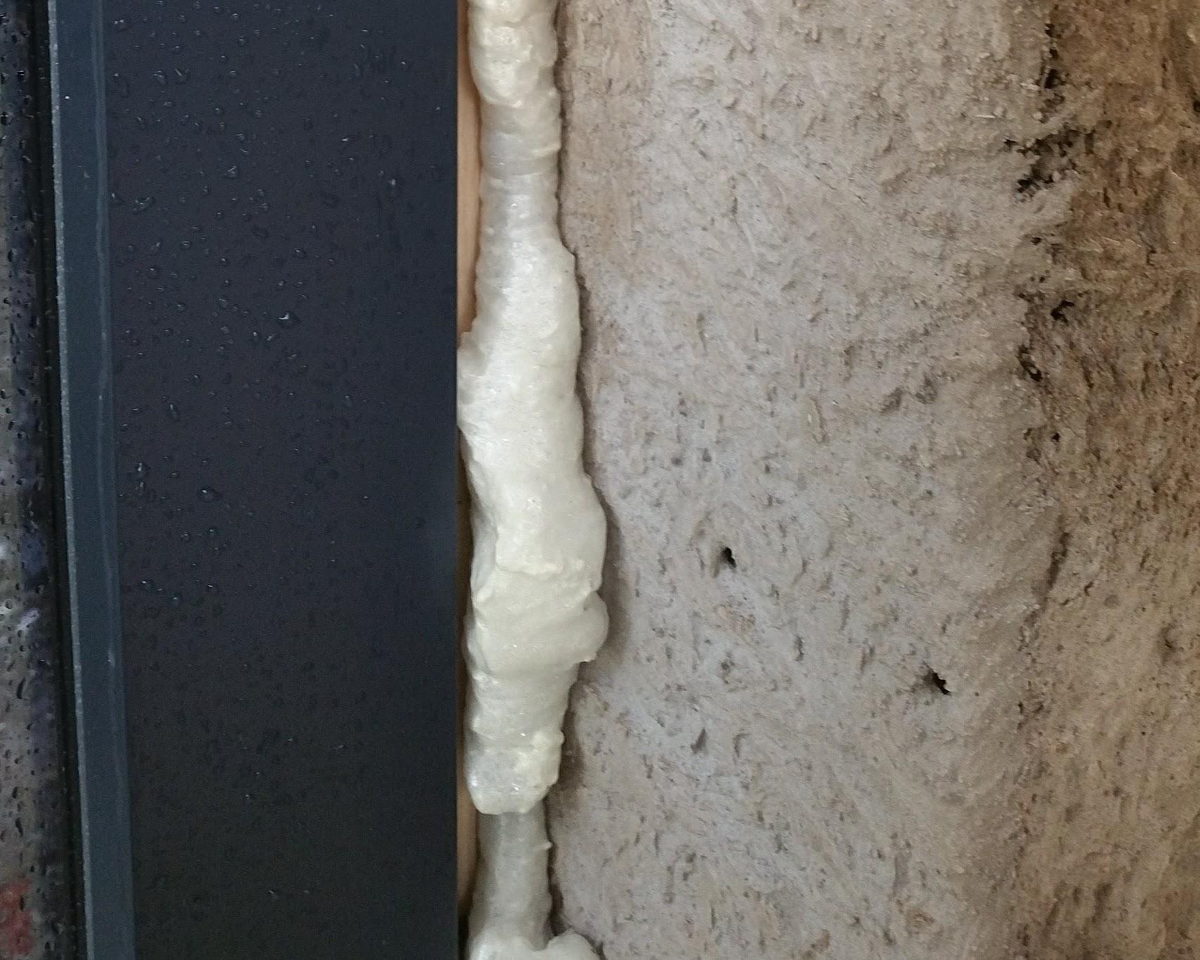

We have an issue with how our windows are to be sealed into the window frame.

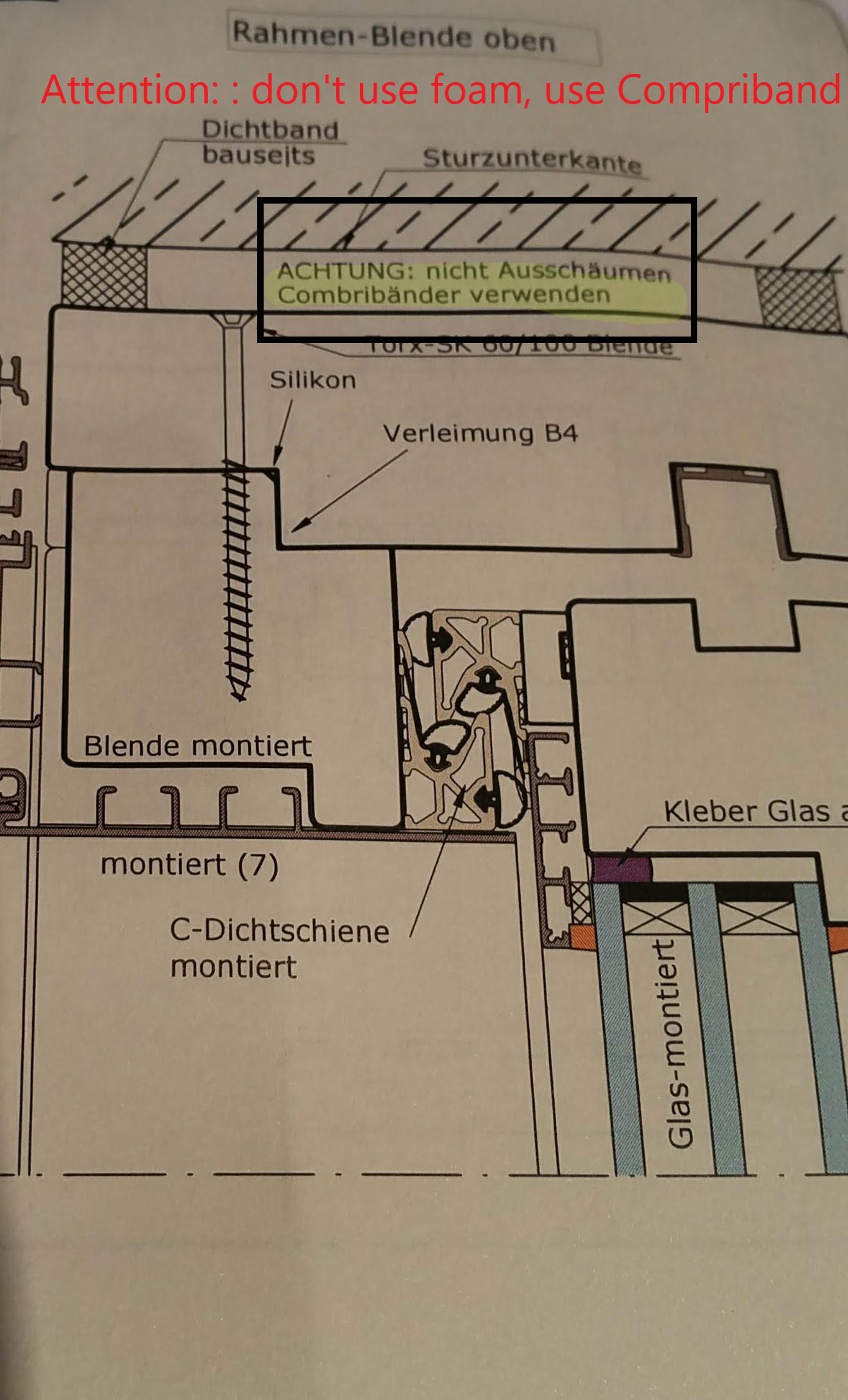

Today I got round to reading the instructions on how to seal our windows in and was surprised to read the following;
The instructions (highlighted in yellow translated above) show that Compriband should have been used between the window and the frame. It wasn't. The installers simply foamed them in, like this;
The point made by the installer is that Durisol isn't air-tight enough - and importantly smooth enough - to make a proper seal between the window and the wall with Compriband. The fact that this should have been picked up before is no longer relevant. Shit happens.
I have asked for help from Durisol: none forthcoming yet.... This can't be the first time someone has faced this issue.
Which  products would be likely to compensate for the leakiness and roughness of the Durisol / window interface?
I don't want to get to to air-tightness testing to find that the windows are allowing a gale through..... I will have paid for them by then - and nobody will be interested in helping solve the issue at that stage.

Trim the foam back.
Seal with a good Quality mastic/silicone suitable for outside.
Use air tightness tape with the spilt so half sticks to your window a few mm and the other side can be glued to the block work.
Inside the plaster/plasterboard will cover it and your cladding?? Will cover the tape on the outside.
Treat it like sealing up a normal blockwork window.
You could run a skin tight skim down the revels to give the tape something better to stick to. Although the glue I used was really really sticky and mine have been draught free 4 years now.

12 minutes ago, Declan52 said:
Trim the foam back.
Thanks Declan.
Air tightness tape : in or outside?
Product trade names?

What are you putting on the out side of the house, cladding???
https://passivehousesystems.co.uk/product/winflex-airtight-window-tape/
https://passivehousesystems.co.uk/product/gerband-fortax-6400-airtight-sealant/
That's the tape and adhesive I used for my inside walls.
If you are sealing the inside with tape maybe just silicone the outside.
