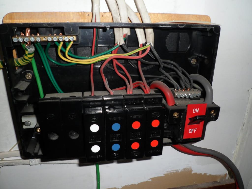

Onoff Posted September 5, 2018 Author Share Posted September 5, 2018 (edited) 2 hours ago, JSHarris said: Sounds a bit implausible, but stranger things have happened. I'll give you implausible: Working on a ring once in an empty house. Old Wylex board.Fuse pulled and in my pocket. The biggest electrical storm right overhead the house. TN-S system & v close to the substation. I was changing the face place so had the two legs of the ring exposed and hanging out of the back box. A lightning strike and a foot long blue "spark" came out of the back box next to me. People don't believe me. Dread to think if I'd have been touching it all. Still got a pic of the old board: EDIT: My bad just realised that's a MEM! Edited September 5, 2018 by Onoff Link to comment Share on other sites More sharing options...
