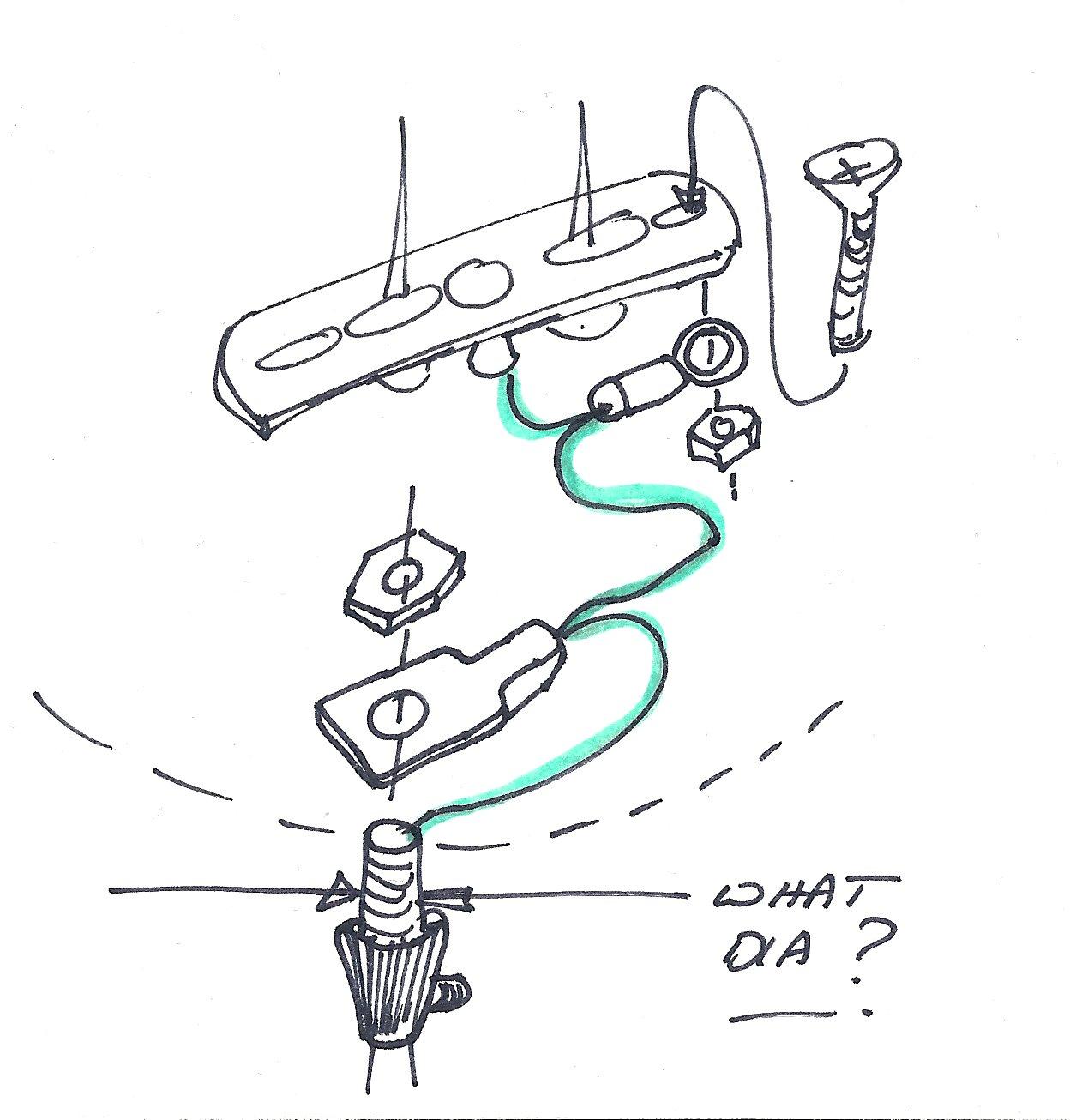

j_s Posted August 25, 2018 Posted August 25, 2018 (edited) Hi guys I've bought a basic single metal e27 pendant. It's got neutral, line and earth but the metal rose requires earthing and no fitting (usually ring attached with earth lead to casing all done) is provided. It's just an earth wire and instructions just say make sure rose is earthed. I'll need some connectors to attach to house wiring but what is the best way to go about sorting out the rose? I've googled but you just can't seem to buy a small earth lead with ring as normally seen in other light fittings. I'll probably get the electrician to do it but I like to get all parts ready before he gets here. Thanks James Edited August 25, 2018 by j_s

ProDave Posted August 26, 2018 Posted August 26, 2018 God I hate light fittings like that. INCOMPLETE. They expect you to make it up as you go along. WHAT secures and takes the strain of the flex? WHAT connects the flex to the fixed wiring? I would take it back as not fit for purpose unless you are prepared to sort out the missing bits. Earthing, which is the original question, you could to a lot worse than a ring terminal under one of the screws that fixed the bracket thing to the ceiling.
Onoff Posted August 26, 2018 Posted August 26, 2018 Usual cheap Chinese sh!t! You need to earth both ceiling bracket and that black cover imo. Something like this...green highlighter looks blue for some reason... If you don't earth both, either could become live when separated. Does the grub screw in that conical black bit just "crush" the 3 core cable to secure it?
j_s Posted August 26, 2018 Author Posted August 26, 2018 Yes onoff, it crushes the 3 core to hold it. I'll look at getting something else I think Anyone know of a better supplier of single pendants like this please?
