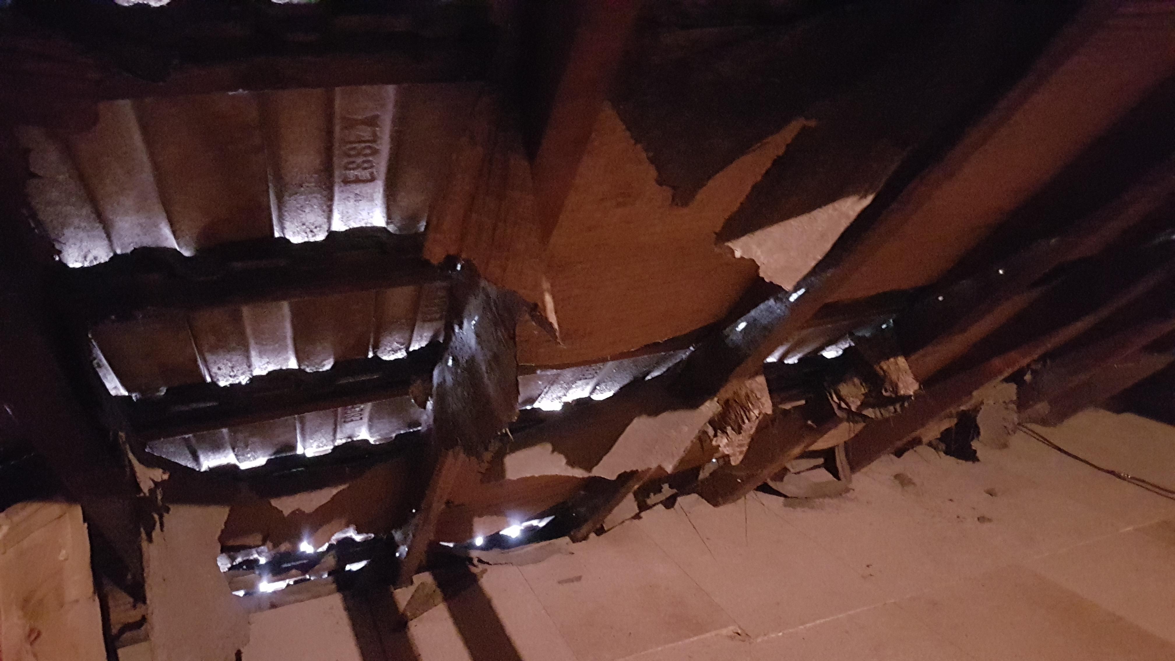

wooju Posted August 10, 2018 Share Posted August 10, 2018 Hello all, I bought a house few years ago and the roof membrane was already not in the best state. Now there is few holes and during last winter, when the wind was quite strong, it was blew a bit of snow here and there. Now I know the proper way would be to remove the tiles and replace the whole membrane, but I doubt i will be able to afford it at the moment.Could you please let me know:- what cost do I face to do it properly inc the scaffolding (it's a semi detached, 2 storey house)- do I need the membrane at all- could I possibly "replace/fix" the membrane from inside, so cut it to smaller bits and attach in between rafters, to the side of the rafter using tape etc.Thanks in advancePeter Link to comment Share on other sites More sharing options...
Cpd Posted August 10, 2018 Share Posted August 10, 2018 21 minutes ago, wooju said: what cost do I face to do it properly inc the scaffolding (it's a semi detached, 2 storey house)- do I need the membrane at all- could I possibly "replace/fix" the membrane from inside, so cut it to smaller bits and attach in between rafters, to the side of the rafter using tape etc. 1. Impossible to know without more detail. Size of building, ease of location for scaffolding, condition of existing tiles and other parts of roof like flashings. There are a number of diffrent roofing membranes that may or may not work depending on the roof makeup. Search forum for more info. 2. Yes you need a membrane as it’s there as a secondary protection layer for things like “snow blowing in” and and leaks due to tile damage. 3. I would say NO it’s not possible to fix from the inside, yes you could possibly do an emergency repair to a known location but beyond that would be a waste of time and money. Some photos of the roof from inside and outside would help to visualise what the problem is and if it can be fixed without a full re-roof. Link to comment Share on other sites More sharing options...

Declan52 Posted August 10, 2018 Share Posted August 10, 2018 How big are the holes?? A few pics would help. I repaired mine from the inside in my last house. I cut a thin slice horizontal just above the hole. Put a long rectangle shape piece of membrane down through the slit and pulled it down so it covered the hole on the outside with a flap sticking through the slit on the inside. Used some silicone and glued the flap on the inside and the 3 sides of the underneath of the rectangle to the existing felt. Then cut a patch and glued in on from the inside over the hole. It was not a handy job at all to do and it was between the battens so was easier to do as above. Link to comment Share on other sites More sharing options...

wooju Posted August 11, 2018 Author Share Posted August 11, 2018 Thanks everyone for all you replies and comments. I attach a photo of the worst bit but have few more smaller holes here and there I don't think I can patch any of the holes due to the fact the remaining membrane is quite dry and crumbles when touched. In regards to the size of the roof, I will try to calculate it all tomorrow. For now, I would say it is an ‘average’ size and that the house is in Essex. Why cutting the roll of membrane in to few rectangular pieces and sticking it to timber is not ideal? Is it because I lave some exposed pieces of timber? Link to comment Share on other sites More sharing options...
