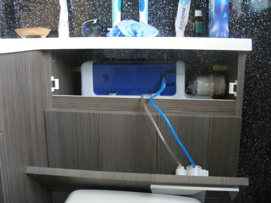

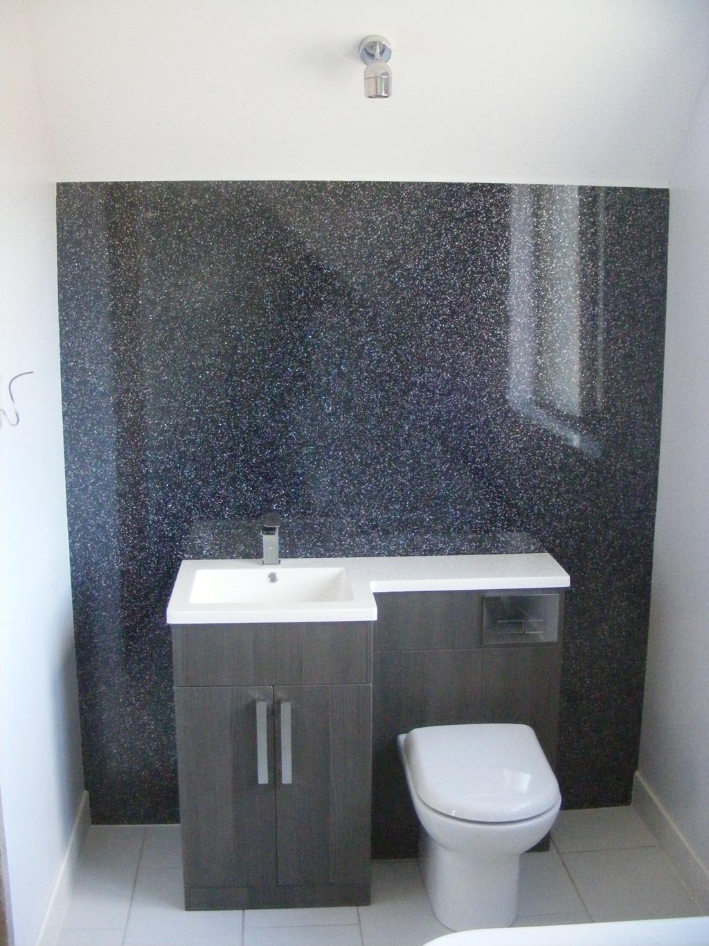

If it is not a wall hung pan, but a simple floor standing back to wall toilet, then you do you want or need the complication of a frame to mount the cistern in.
We just used a simple dual flush concealed cistern with hydraulic flush plate.
And here showing the service access
If we don't have to have the frame, I'd be happy not to have to buy it, but I do want a good quality cistern that can be accessed easily for maintenance and the Geberit seems to provide that.  Thanks for sharing those photos @ProDave  - I presume the cistern is fitted to the wall in some way?

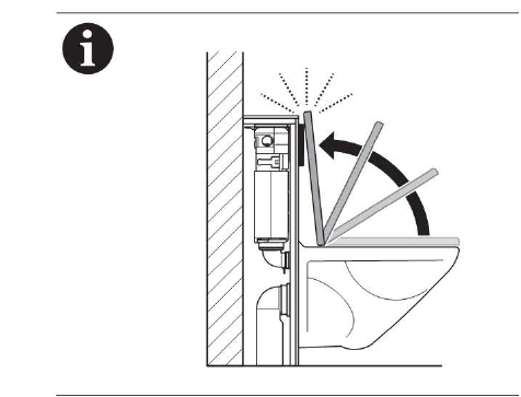

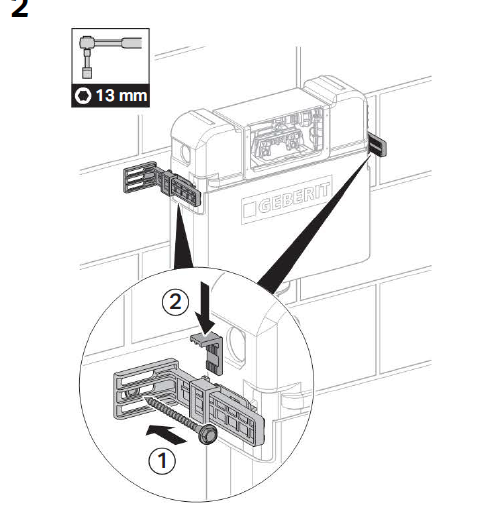

That's the video I found when looking for how to install it @Onoff, but it has the Duofix frame being used rather than just the cistern.  The product installation download also creates some doubt as the diagrams show it being attached to blockwork and used with a wall hung toilet but no Duofix frame!
Edited by ThePoplars
@Onoff  Thank you.  I wasn't looking in the right place, and there is something much clearer about somebody saying what they are doing rather than very fancy computer generated animations.  I'll put my order in now!
Geberit are bombproof.
You wont be disappointed. No need to mount on anything other than a flat, vertical wall. Doesn't need to be on blockwork. ?
