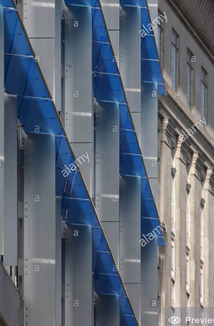

Dreadnaught Posted August 4, 2018 Share Posted August 4, 2018 (edited) 20 minutes ago, JSHarris said: because "normal" glass has a high emissivity, it will absorb a lot of heat when exposed to long wavelength IR from the sun And if they were blue-tinted glass, they could work even better. The 150 Cheapside building in London got there first… 150 Edited August 4, 2018 by Dreadnaught 1 Link to comment Share on other sites More sharing options...
Jeremy Harris Posted August 4, 2018 Share Posted August 4, 2018 The new building that was built at Porton as a part of the rationalisation programme I managed in my last post, used a mix of glass and metal slat brise soleil screening. there was a lot of glazing on one office elevation and the screening helped a great deal to reduce the cooling loads. It's government policy to avoid the need for comfort cooling in all new buildings, as well as reduce the heating demand, which is one reason this was designed in. Clear glass was used for the canopies, and that seemed to work very well. IIRC, it had a very faint greenish tinge, probably just from the thickness and size of some of the glass sheets used (they were very large). 1 Link to comment Share on other sites More sharing options...
