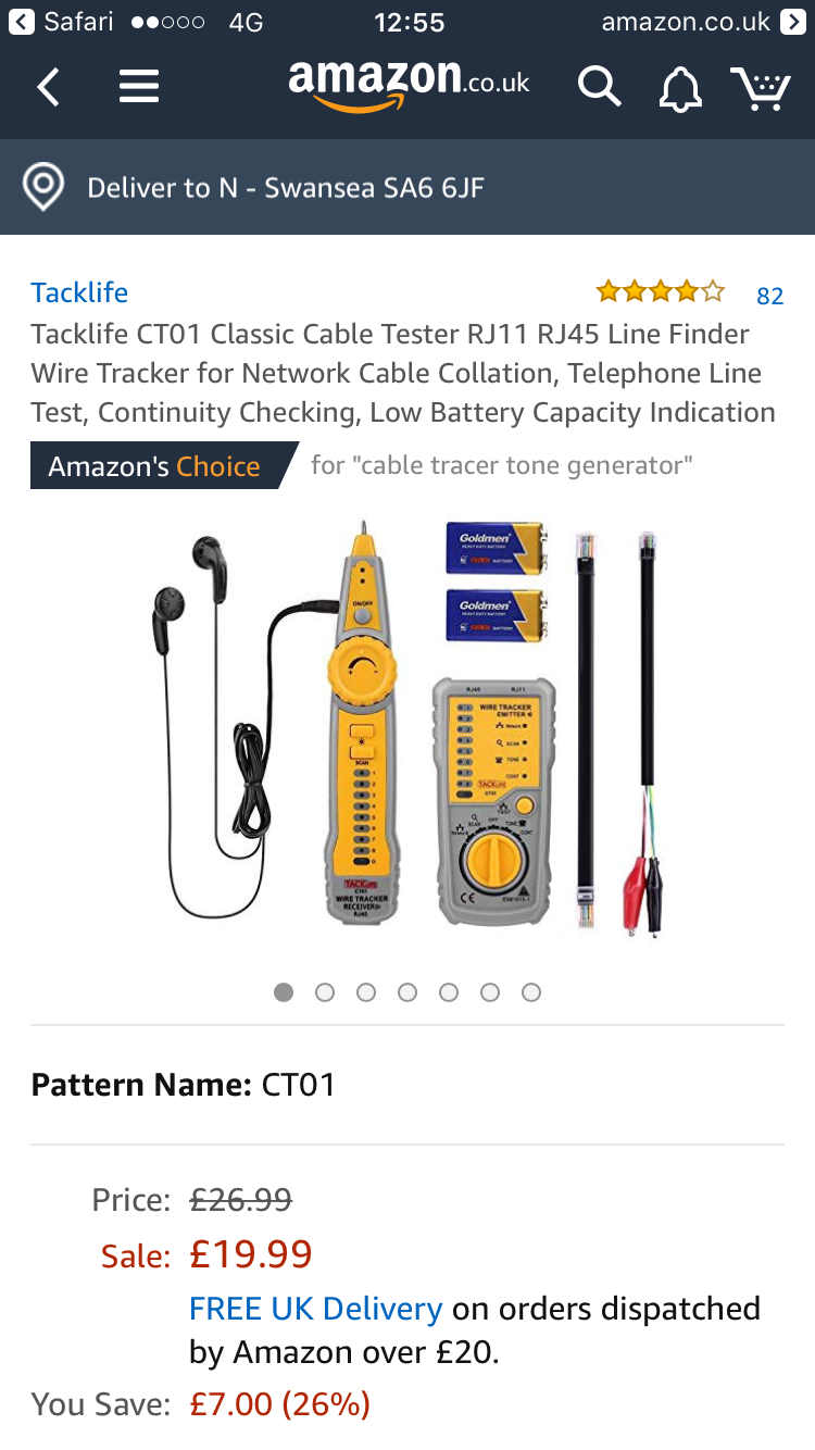

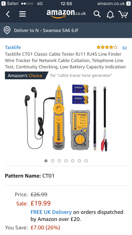

Nickfromwales Posted July 26, 2018 Share Posted July 26, 2018 A tone generator set is what I use. Link to comment Share on other sites More sharing options...
