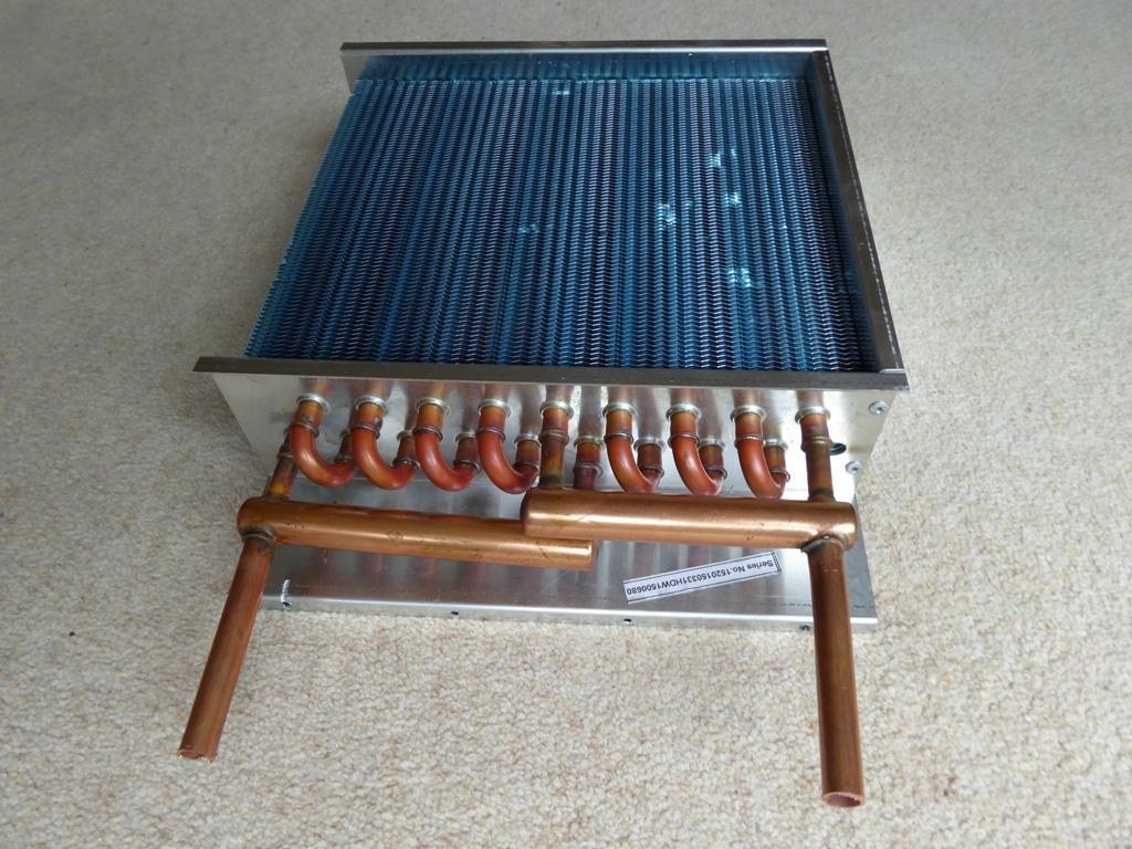

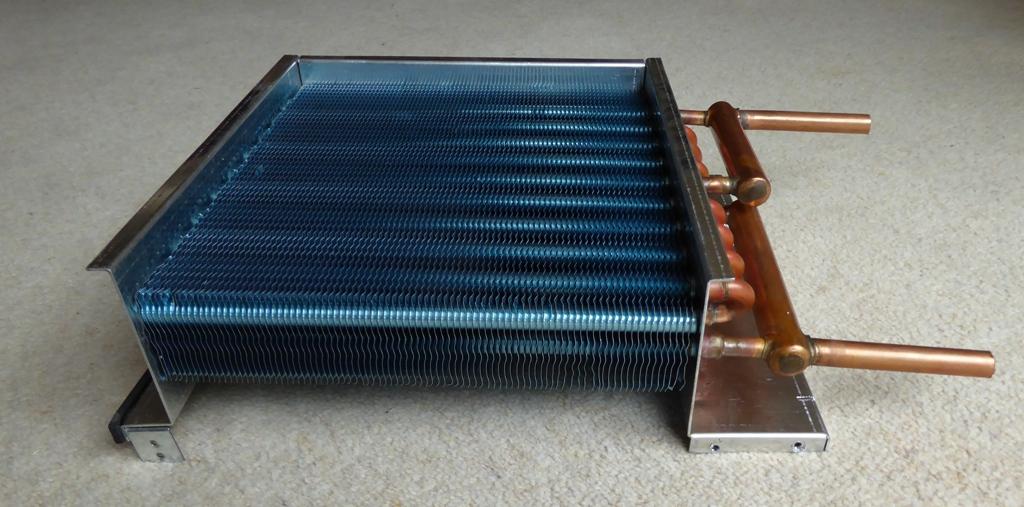

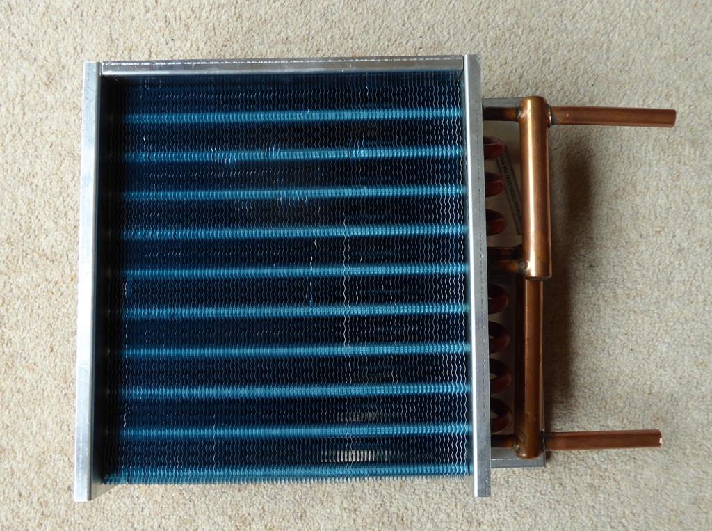

Stones Posted July 25, 2018 Share Posted July 25, 2018 @JSHarris What size is the unit you bought, and can you post a picture? @Dreadnaught In the end I decided to see how the house performed without fitting a duct heater / cooler as it would be easy enough to retrofit as a second zone on our pre-plumb ASHP system. I'm just drafting a blog entry at the moment covering how the system has performed over the course of 12 months. Should be able to post it later today or tomorrow morning. 1 1 Link to comment Share on other sites More sharing options...
Jeremy Harris Posted July 25, 2018 Share Posted July 25, 2018 3 minutes ago, Stones said: @JSHarris What size is the unit you bought, and can you post a picture? I'm just taking a break between house viewings, but will try and take a photo of the heat exchanger core as soon as I get time. Off the top of my head I think it's around 225mm x 250mm x 40mm active finned area, and has two rows, one behind the other. Link to comment Share on other sites More sharing options...

Jeremy Harris Posted July 27, 2018 Share Posted July 27, 2018 On 25/07/2018 at 14:30, Stones said: @JSHarris What size is the unit you bought, and can you post a picture? @Stones, here are the photos of the raw heat exchanger core, waiting to be put in a housing: Link to comment Share on other sites More sharing options...
