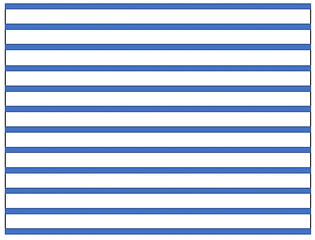

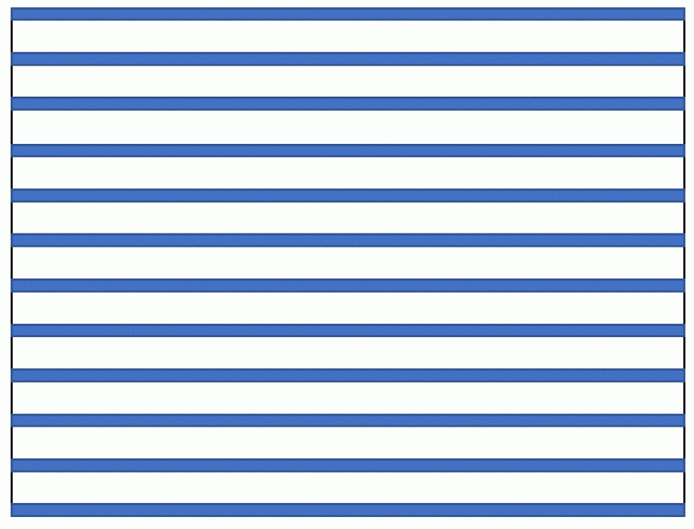

The first two drawings here show the difference. In a counterflow arrangement, the fluids move in opposite directions. Theoretical efficiency is 100%, although more than 90% in the real world is doing well.
Crossflow means the fluids move at 90 degrees to each other. This simplifies the connections in a device like that shown above, but theoretical efficiency drops to 75%.
A parallel flow, where both fluids are moving in the same direction, is at best 50% efficient.

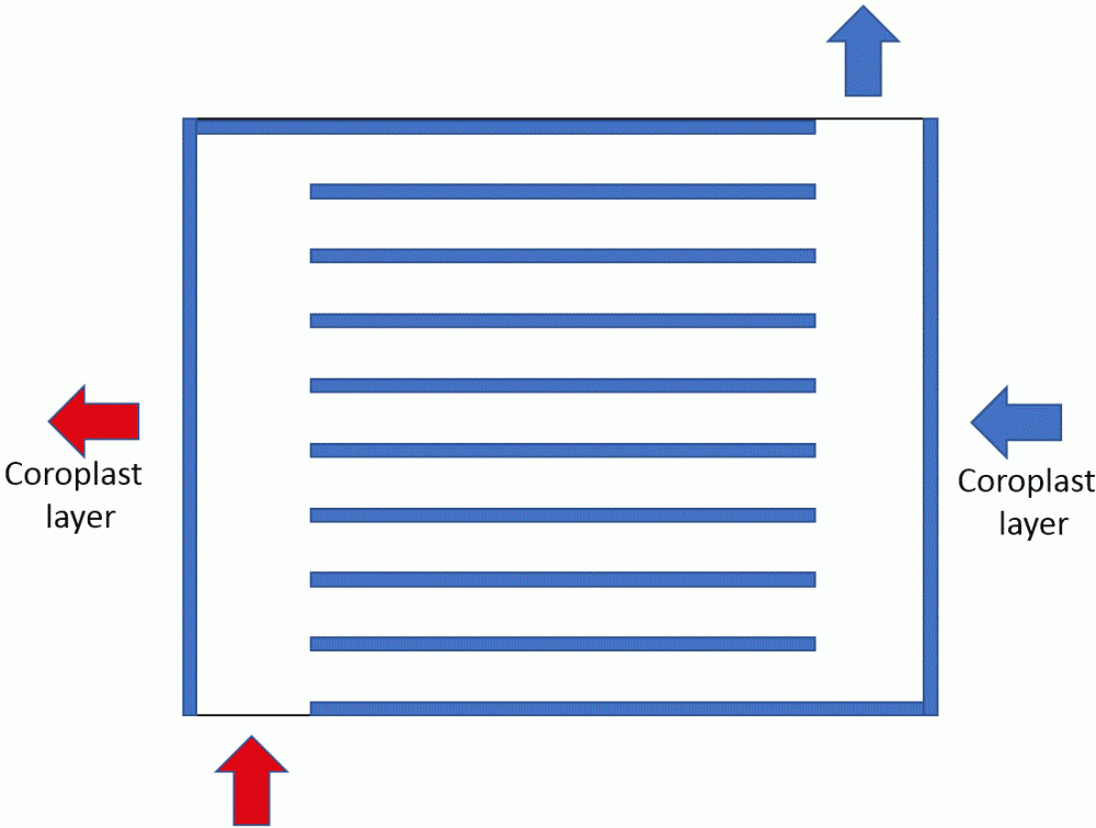

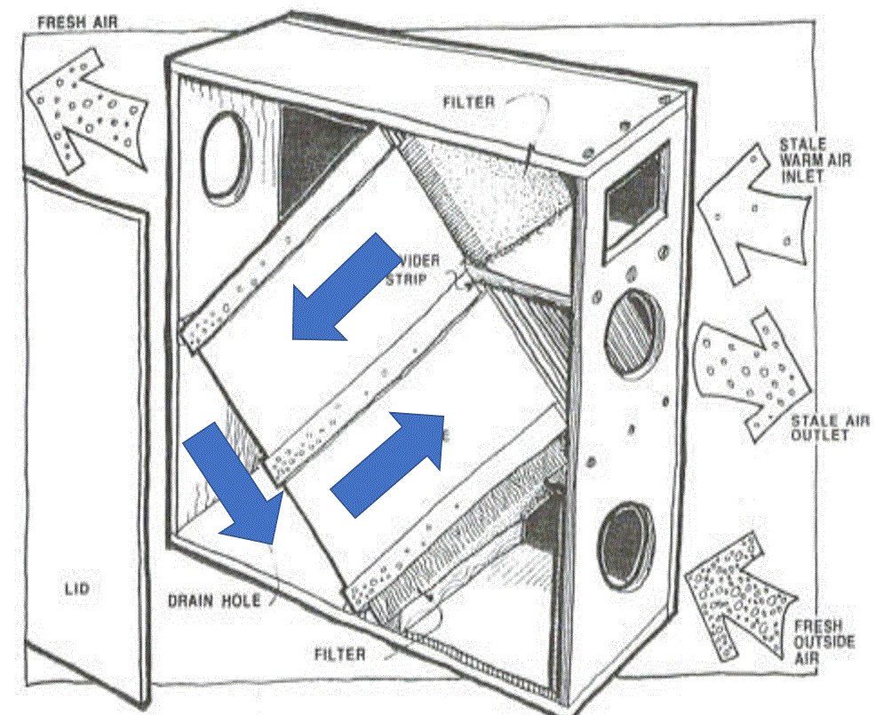

The one linked above is crossflow, but with a double-back path (blue arrows) that will tend to bump the theoretical efficiency up from 75%:

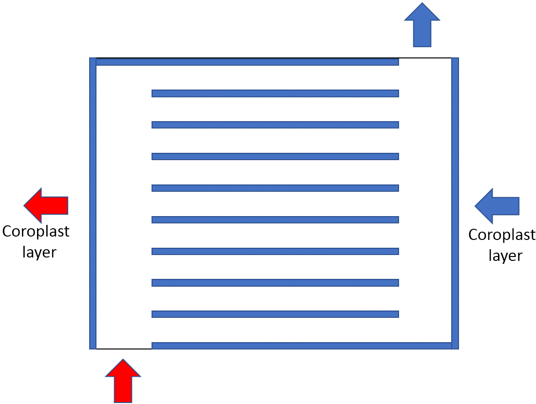

To turn this into a full counterflow unit, you would change the divider strip layer to look like this, with the parallel dividers being parallel to the coroplast tubes:

I'm not sure that a lack of sealing in the channels is likely to be a big issue, but I agree about the thickness. You could always use flat sheets of thinner material and alternate the pattern above with the pattern below:
The problem is that anything thin enough isn't going to be very rigid, so might be annoying to work with. Some sort of jig would help, and once the first few layers are done it should stiffen up and make things easier.
