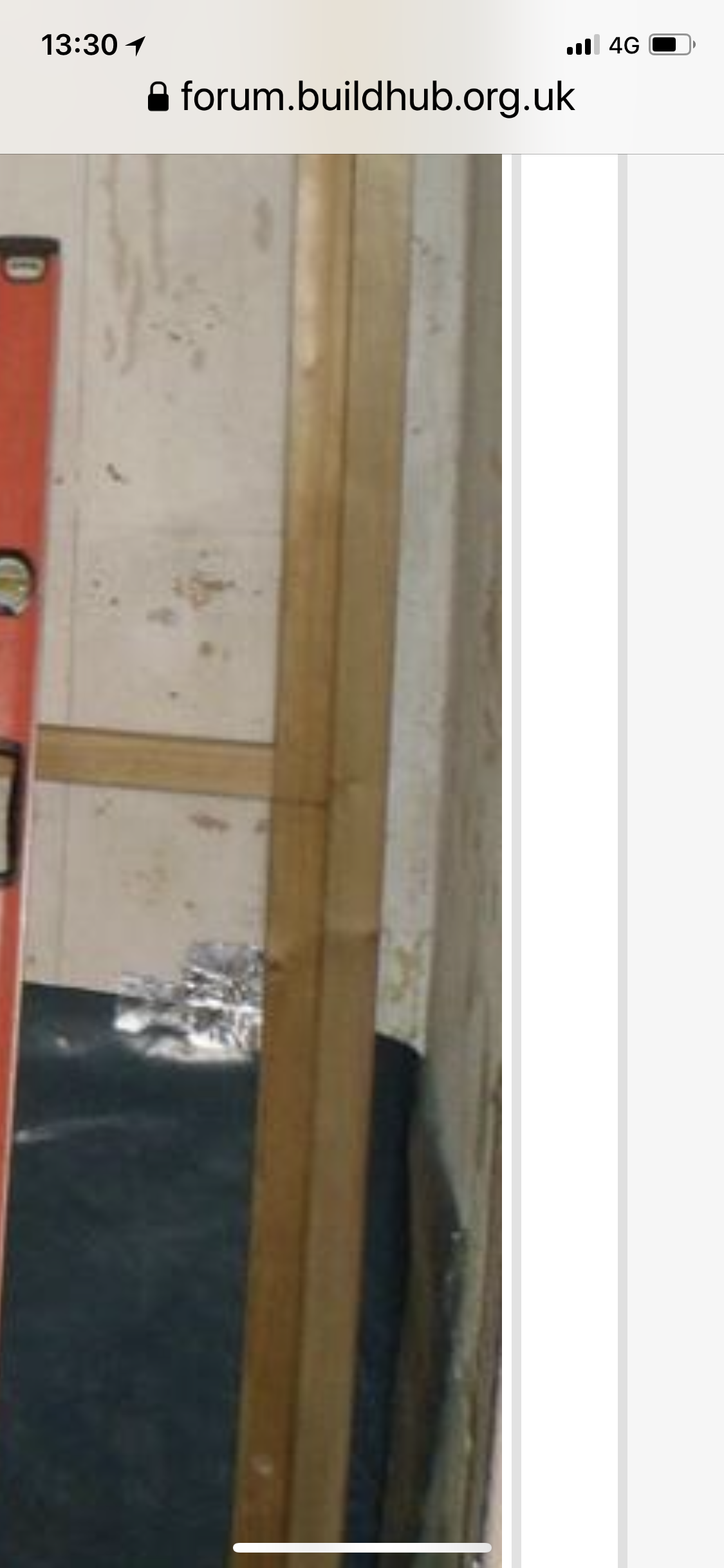

Onoff Posted July 16, 2018 Share Posted July 16, 2018 (edited) A battened wall: A concrete screw (Torx T30 bit I think). They don't always bite! I put mine in with either the 18V impact or 230V pistol drill You shim behind as required with plastic trouser shims, slivers of timber etc. Insulating between Be aware that 25mm pir might be anything from 23-28! I had 45mm battens so figured add a 5mm (brown) pack to give 50mm and my 50mm pir wouldn't project....well in places it did because it was thicker than 50mm! I think I put 5 fixings per batten with a minimum 5mm pack. I also foam gunned behind the batten in between the fixings /packs. Edited July 16, 2018 by Onoff Link to comment Share on other sites More sharing options...

zoothorn Posted July 16, 2018 Author Share Posted July 16, 2018 Onoff.. very helpful thx. do you have any more pics of the rest of the job, or is this as your doing right now.. Those scrtews look terrifyingly nasty to get in.. do you pilot hole a big one > then whack in.. or are they designed to go straight into block? I guess if so you need a particular/ v. high quality drill or you'd be struggling-? So are your battens 400mm apart? & why are your noggins at different heights? Link to comment Share on other sites More sharing options...
zoothorn Posted July 16, 2018 Author Share Posted July 16, 2018 3 minutes ago, PeterW said: 400 centres means you land board joints on a batten. From the corner though you need to go from the outside edge to centre, as otherwise you will end with a 25mm gap with your first board Ah ok.. so plasterboard industry std W is 400mm then, if so I'm getting the idea. Double battens on the outside edges as per onoff's eg.. is this a std method too? reason being.. thanks zoot Link to comment Share on other sites More sharing options...

Onoff Posted July 16, 2018 Share Posted July 16, 2018 (edited) What do you mean by "double battens"? Noggins are staggered as it makes it easier to screw them in. Yep 400 ctrs. Meant my pir was cut into nom 355mm wide strips. I drilled a pilot, 6mm from memory with a Bosch multi construction bit, thru the batten & into the wall. Says they're self drilling here: https://www.screwfix.com/p/easydrive-countersunk-concrete-screws-7-5-x-100mm-100-pack/3839h I never read that! What I did was make "stud walls" in the garden and reassemble in the bathroom. Push against the wall, pack and drill to suit. https://flic.kr/s/aHsk23FYzd Edited July 16, 2018 by Onoff Link to comment Share on other sites More sharing options...

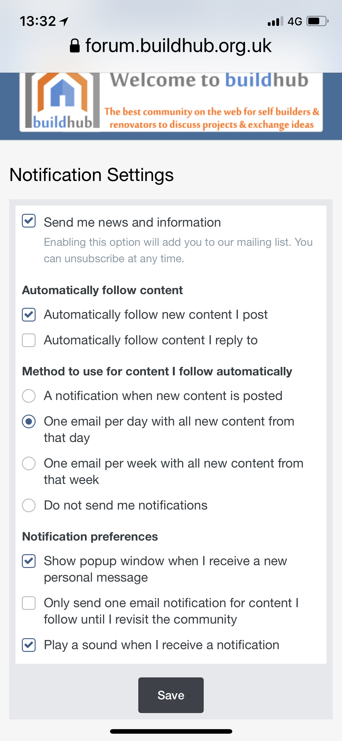

newhome Posted July 16, 2018 Share Posted July 16, 2018 (edited) It’s at the bottom on the mobile view. If you are using a laptop it may be somewhere different. And you need to have the thread open. I can see that you are not following this thread currently. Follow the link below and click to follow content you post or additionally content you replied to. And you will only get 1 email a day, not every time someone posts. https://forum.buildhub.org.uk/notifications/options/ Edited July 16, 2018 by newhome Link to comment Share on other sites More sharing options...
PeterW Posted July 16, 2018 Share Posted July 16, 2018 36 minutes ago, zoothorn said: Ah ok.. so plasterboard industry std W is 400mm then, if so I'm getting the idea. Double battens on the outside edges as per onoff's eg.. is this a std method too? reason being.. thanks zoot PB is 2400x1200 or 1800x900 double battens are only there to give you a corner to work to Link to comment Share on other sites More sharing options...
newhome Posted July 16, 2018 Share Posted July 16, 2018 13 minutes ago, Onoff said: What do you mean by "double battens"? This. 2 battens together. ? Well i assume it’s this. Link to comment Share on other sites More sharing options...
PeterW Posted July 16, 2018 Share Posted July 16, 2018 That's known as poor planning.... ? Link to comment Share on other sites More sharing options...
newhome Posted July 16, 2018 Share Posted July 16, 2018 2 minutes ago, PeterW said: That's known as poor planning.... ? Surely not! It was several months in planning I imagine ? Link to comment Share on other sites More sharing options...
zoothorn Posted July 16, 2018 Author Share Posted July 16, 2018 Yup thats the 2 battens Im on about.. lookslike doubles on your outer 2- normal procedure? why so? Onoff. Im interested to know what you're doing regarding the window areas/ the side wall areas 1 block thick too.. add C'tex here? or too fiddly/ what just ~5" wide board onto to block.. but how to fix? a pic would be great.. lookslike the fiddliest bit. Link to comment Share on other sites More sharing options...

Onoff Posted July 16, 2018 Share Posted July 16, 2018 (edited) 4 hours ago, PeterW said: That's known as poor planning.... ? Not a clue tbh! That's an internal wall there anyway. EDIT: Might be something to do with the bath side pocket...I'm not wading through over 2k photos to see why! Edited July 16, 2018 by Onoff Link to comment Share on other sites More sharing options...
newhome Posted July 16, 2018 Share Posted July 16, 2018 47 minutes ago, Onoff said: Not a clue tbh! That's an internal wall there anyway. EDIT: Might be something to do with the bath side pocket...I'm not wading through over 2k photos to see why! In other words @zoothorn double batten not required! Link to comment Share on other sites More sharing options...
