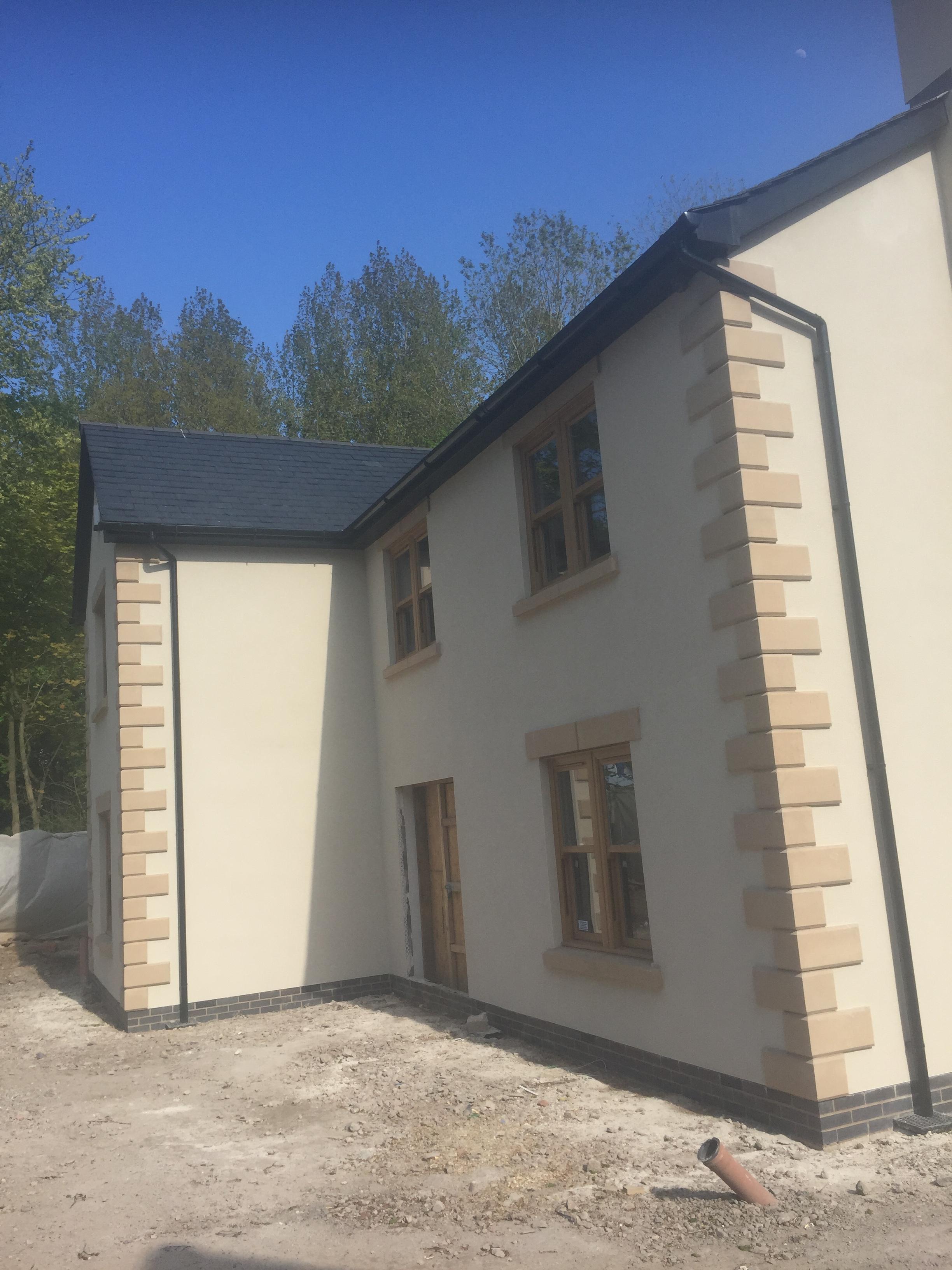

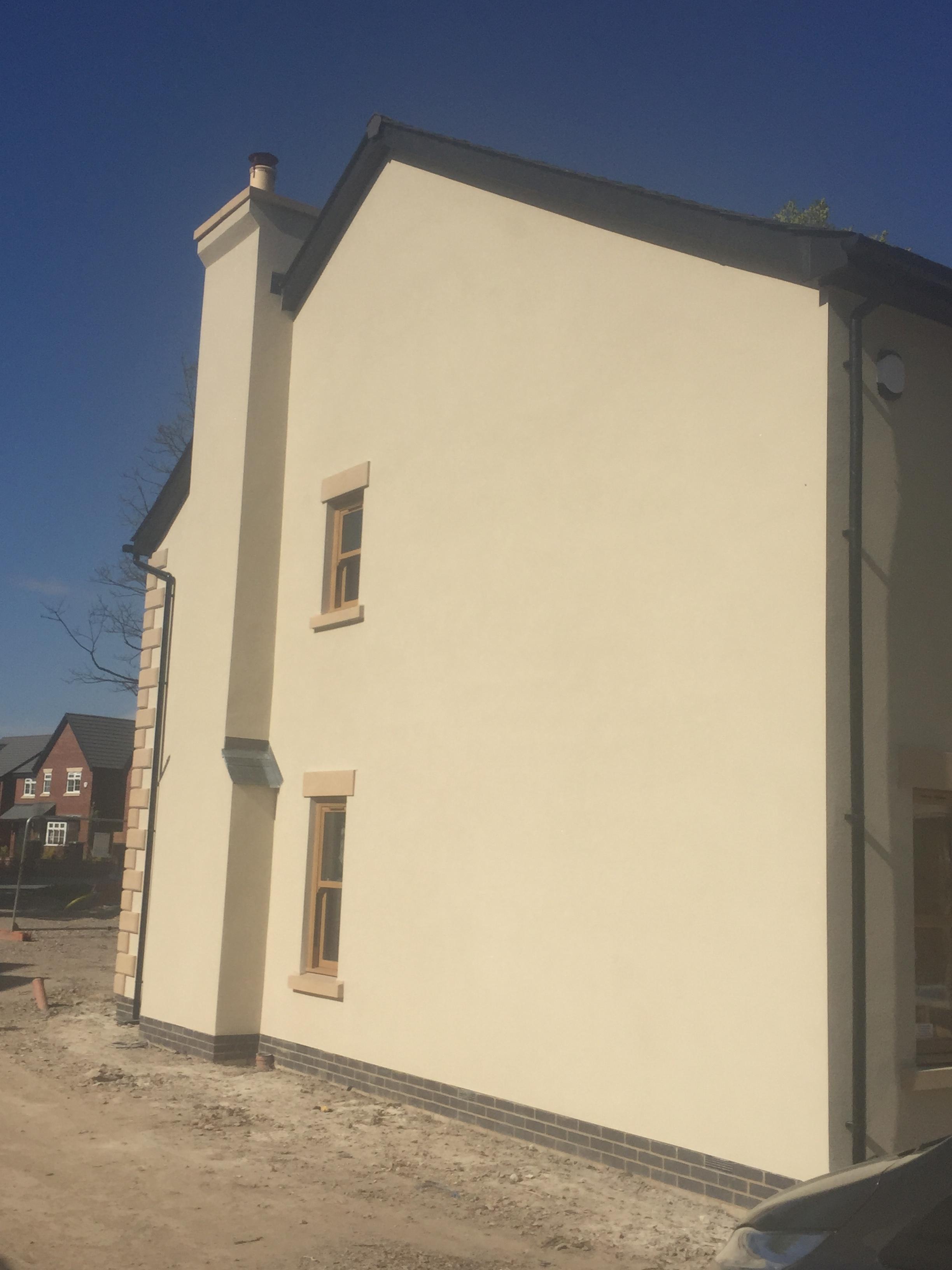

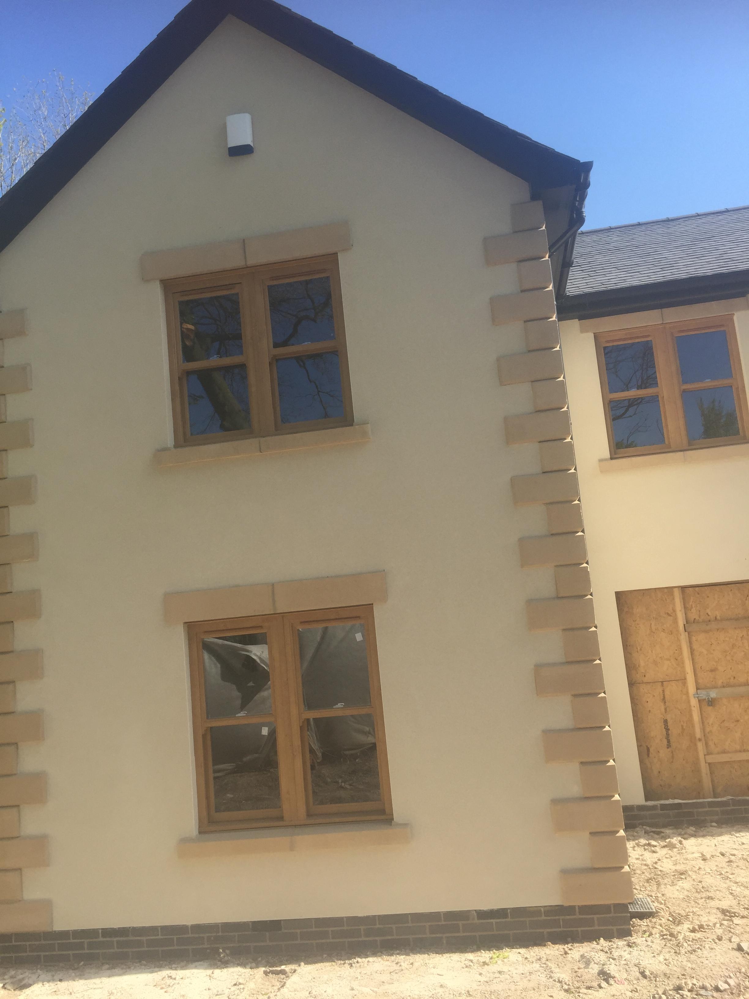

lizzie Posted June 16, 2018 Share Posted June 16, 2018 this is a garden wall in polar white k rend.... I think their whitest white. Whilst its nice its nit as white white as the alumasc silicone stuff on the house. Its not a problem as they are not close together and the light is coming from a different direction but Polar White is not a very white white. You need to go and see some. If you are passing near Stratford on Avon area welcome to look at mine. 1 Link to comment Share on other sites More sharing options...
lizzie Posted June 16, 2018 Share Posted June 16, 2018 This is the very white alumac render 1 Link to comment Share on other sites More sharing options...

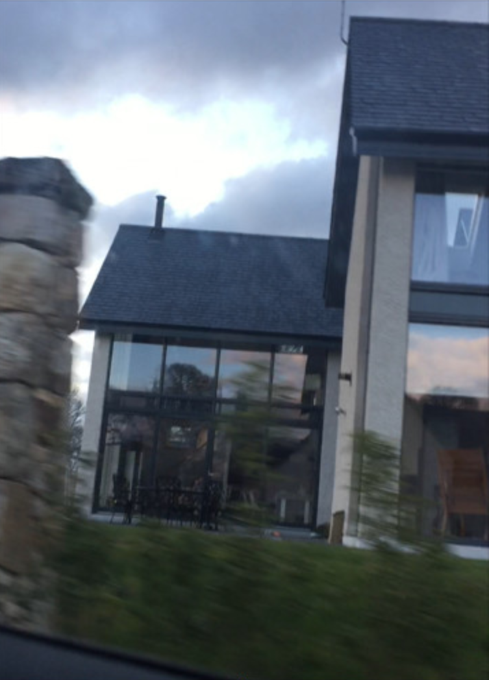

ultramods Posted June 17, 2018 Share Posted June 17, 2018 Sorry I don't know what the colour is, it's an off/grey white. I really liked it especially against the dark woodwork and slate roof. Also sorry for poor image quality, I took it during a "drive by". 1 Link to comment Share on other sites More sharing options...
