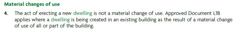

PeterW Posted July 7, 2016 Posted July 7, 2016 I'm ploughing through the final bits for submission of BRegs and I've come across an interesting query.... The build being undertaken is listed as a Conversion and Extension on the planning application, and is effectively the conversion of a large 28sqm footprint double garage, and adding on two extensions of around 30sqm and 45sqm respectively. As its listed as a conversion, and to all intents and purposes the walls will remain from the old garage (it was built for the purpose of conversion in 1992) then its questionable as to whether it needs to follow L1B or L1A. If I read the terms in L1A then the creation of the house from the garage constitutes a material change of use as per the definition. If that is the case, I assuming all of the DER, TER, SAP and Pressure testing goes out of the window and basically I'm on best endeavours in relation to meeting the regs on an elemental method..?? Does that sound reasonable or have I missed something..??!!
Jeremy Harris Posted July 7, 2016 Posted July 7, 2016 Looks to me as if L1B applies for sure. The key is that planning have listed it as a conversion, not a new dwelling, and this then triggers L1B rather than L1A as the applicable energy use standard. Not sure about not needing SAP, though, as isn't there a gotcha when it comes to needing an EPC for a dwelling? This conversion is from a building that was not a dwelling to one that is, so I have a sneaky suspicion that it still needs an EPC to be lodged. The best idea would be to ask the BCO, as they must be familiar with this from other conversions.
ADLIan Posted July 7, 2016 Posted July 7, 2016 (edited) If it's conversion then simple elemental U-values, heating efficiencies etc in Part L1B. No need for DER/TER or DFEE/TFEE or pressure testing but SAP calc is required to generate the EPC on completion. Must be done by on construction energy assessor using full SAP (as its a Reg requirement) rather than RDSAP. Ian Edited July 7, 2016 by ADLIan L1B not L2B!
IanR Posted July 7, 2016 Posted July 7, 2016 My experience has been that, for a Conversion, a Design SAP is not required, and although an as built SAP is also not required to be submitted to BC, it is required to generate the EPC.
