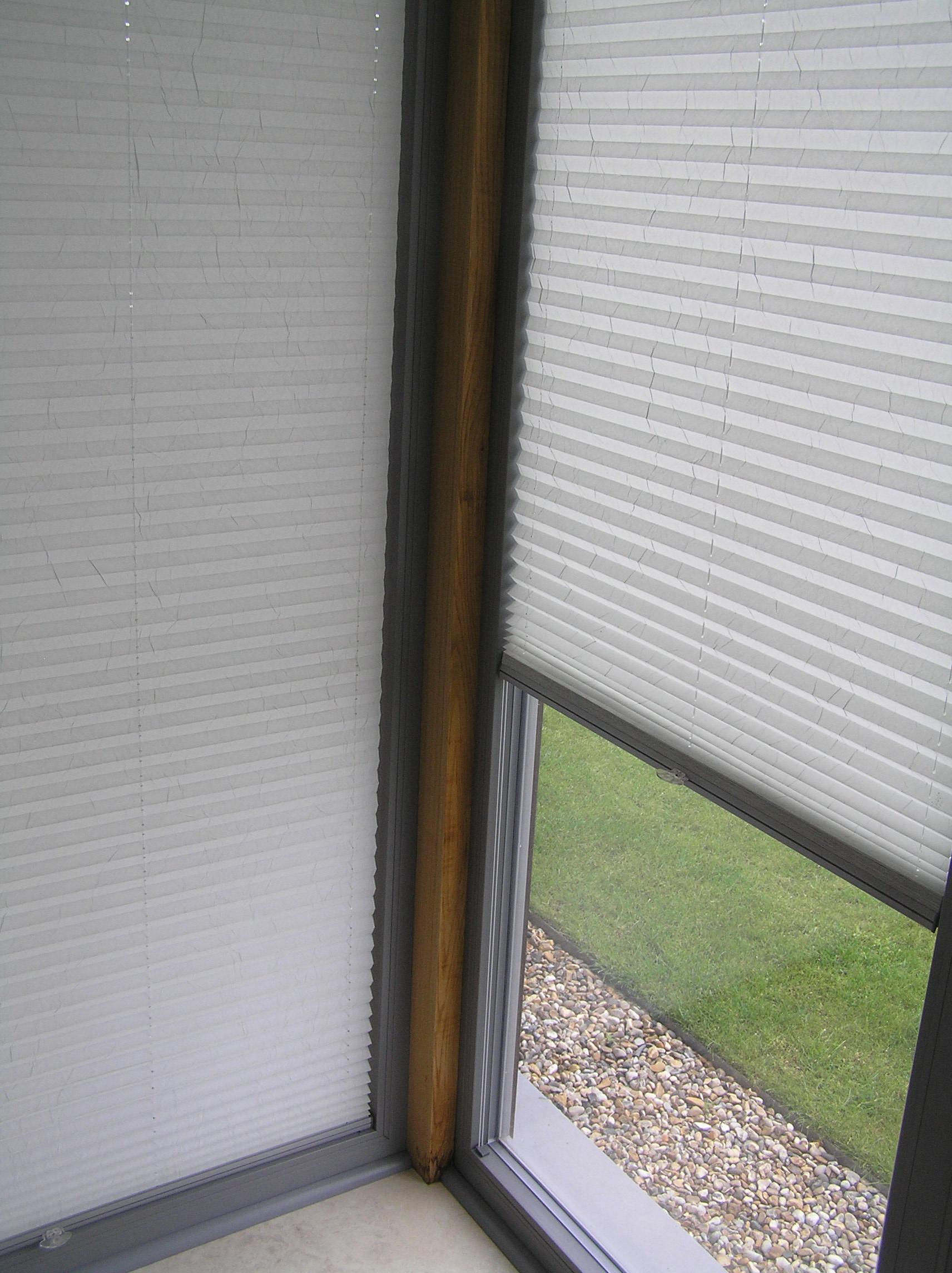

So if I understand you correctly you want something like plisse blinds that fit to the beading rather than say vertical blinds that fit in the reveal. If that is the case I have looked and not been able to find any sort of blinds that are slim enough. Our lift slide doors have 17mm beads and the slimmest plisse blinds I could find were 20mm. We have the 20mm plisse blinds in our porch because we only have double glazing in there and they fit well.
Edited by PeterStarck
Yes they are exactly what I want and you have hit the nail on the head I cannot find anything slim enough to fit the bead on the fixed part of the door.

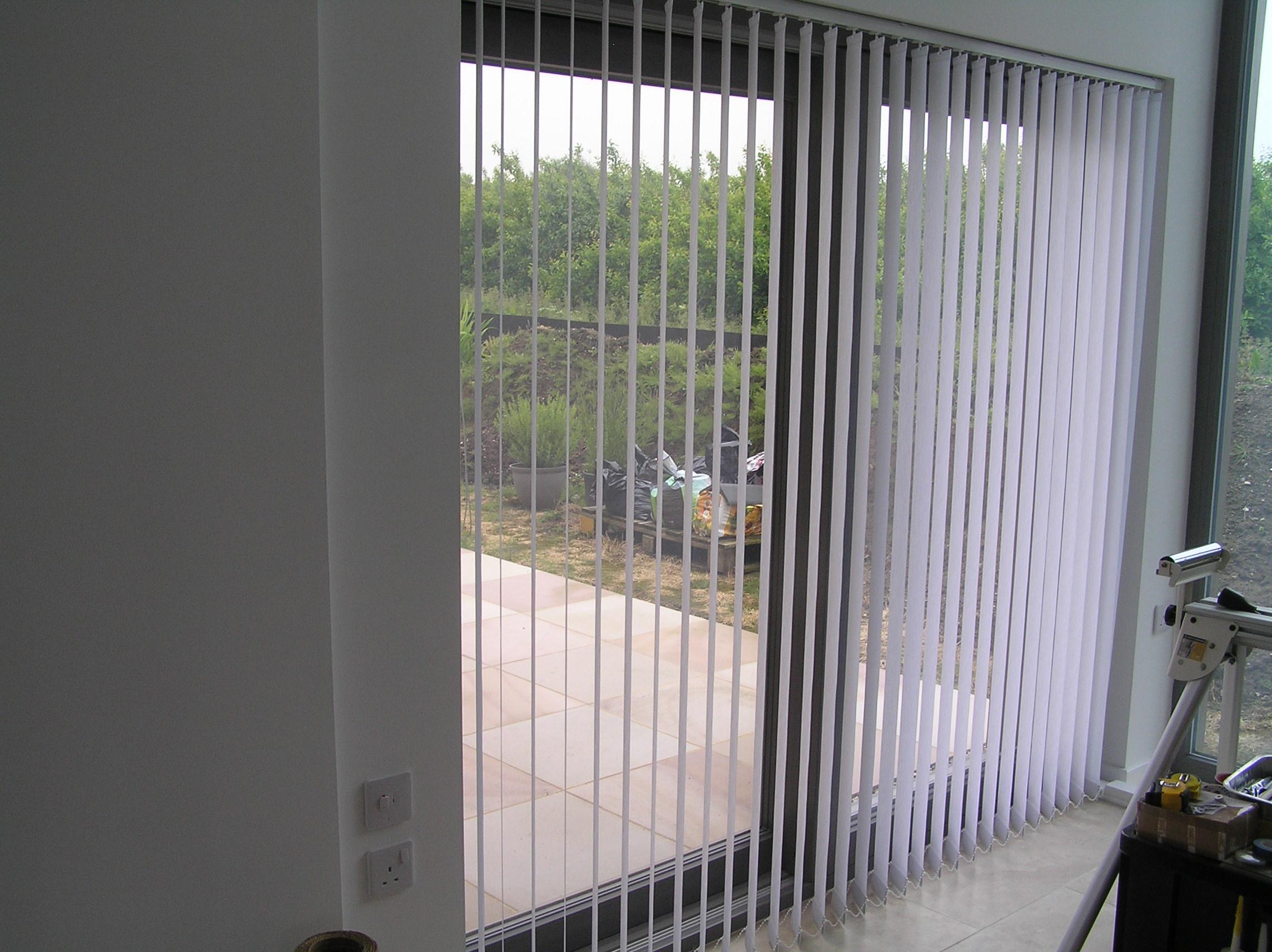

We're lucky in that our reveal is 160mm which is just enough to allow us to have vertical blinds where we have the lift slide door. You'll have to excuse the saw in the sitting room but there isn't anywhere else to store it at the moment.
That looks very neat.....even with the saw LOL

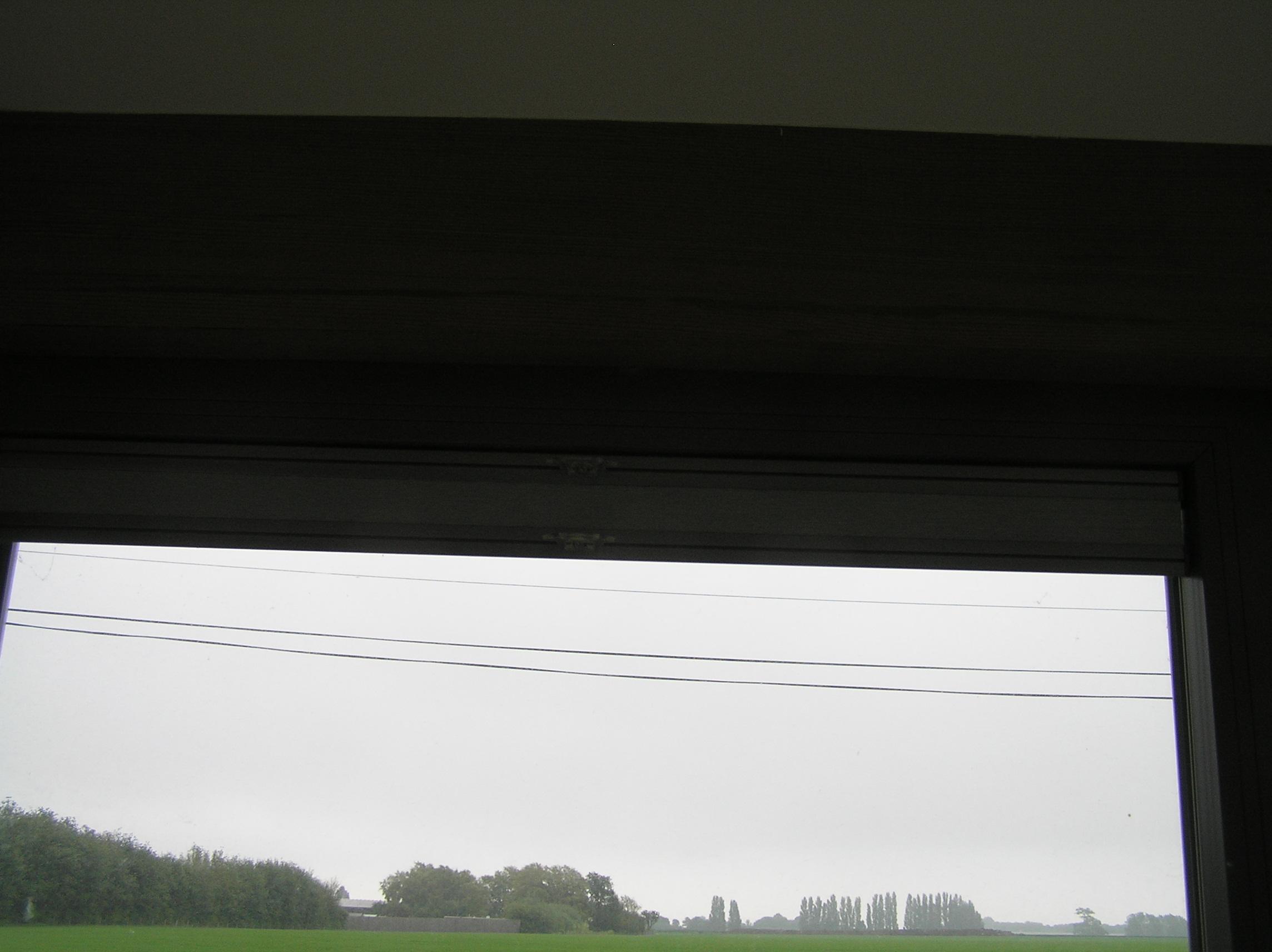

@PeterStarck For your pleated porch blinds, how much do they compress to when fully pulled up at the top? That window is floor to ceiling height at 2.4m? For some windows I only have approx 40mm of window frame at the top and ideally I don't want the blinds hanging below that when fully 'up' (preference is to have the blinds within the window reveal). I'll probably have to go for a bigger pleat in order to reduce the 'compressed height' of the blinds I suspect. TIA!

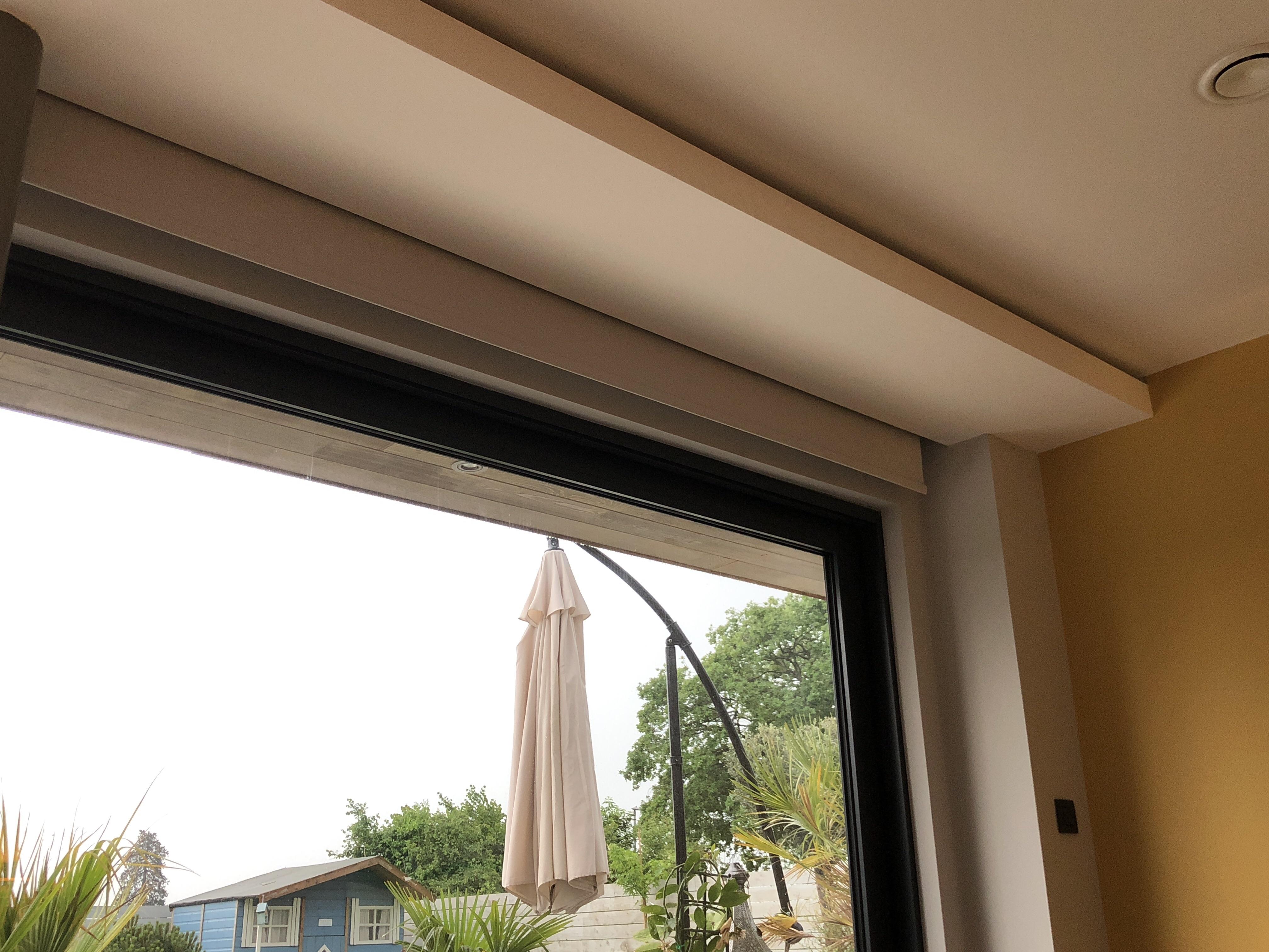

We recessed our blinds into a false ceiling like this to hide the mechanism and give us space for the handles....
The glazing is 2.3m high and the total thickness of blind when compressed is 70mm. Not a very good picture I'm afraid.
Is this detail an reverse L shape that hides the roller mechanism with a shadow gap at the top?
@Pete
Yes, it is - I have some led strip lights to go in the front top shadow gap - it’s one of my remaining jobs when I get some time (and inclination). The blinds are motorised so I don’t actually need to get to any pull cords.
Edited by Trw144
