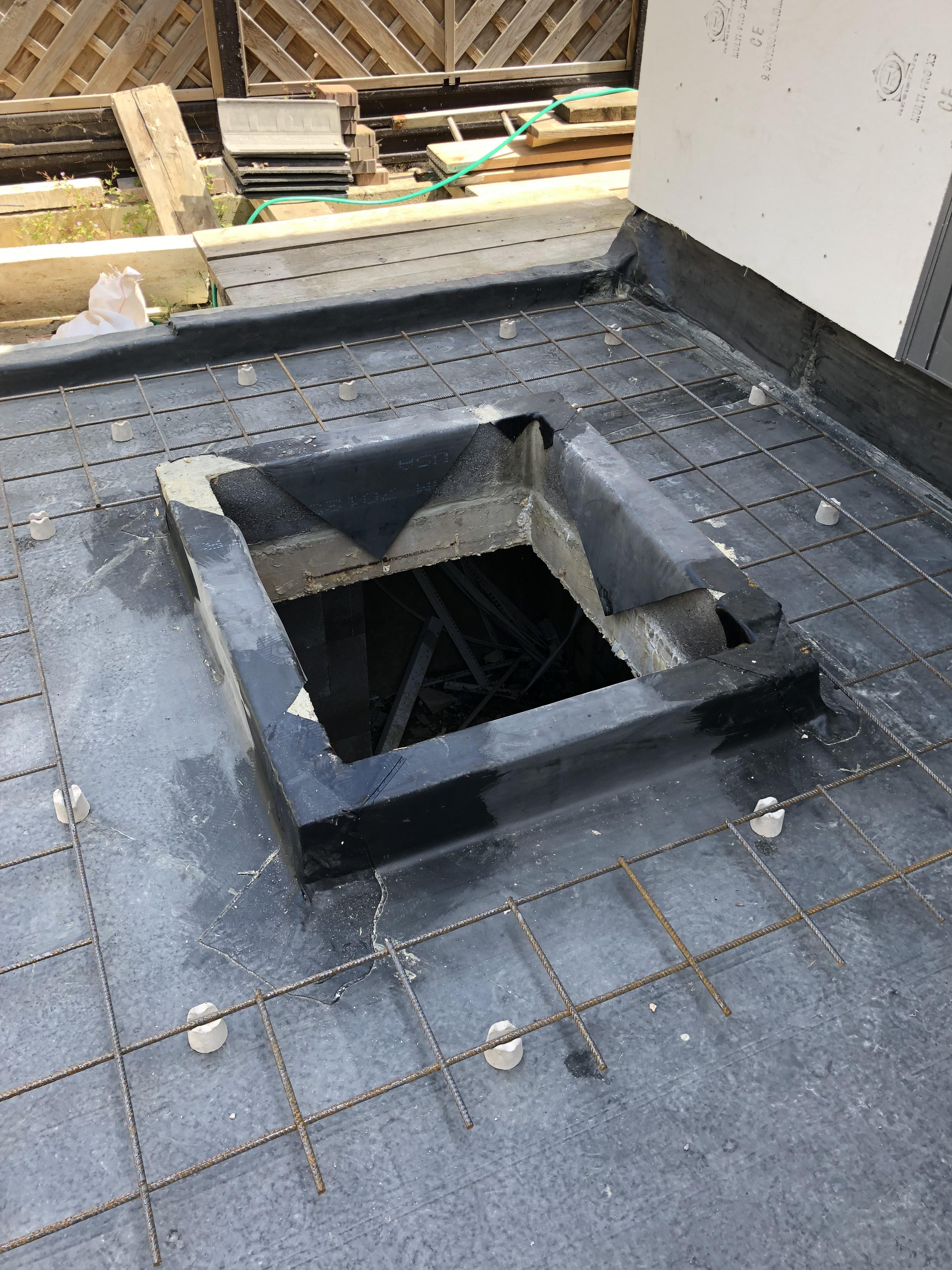

Pocster Posted October 17, 2018 Author Posted October 17, 2018 Found photo of the low up stands before the pour Not sure breaking down through the concrete to this level is doable ....

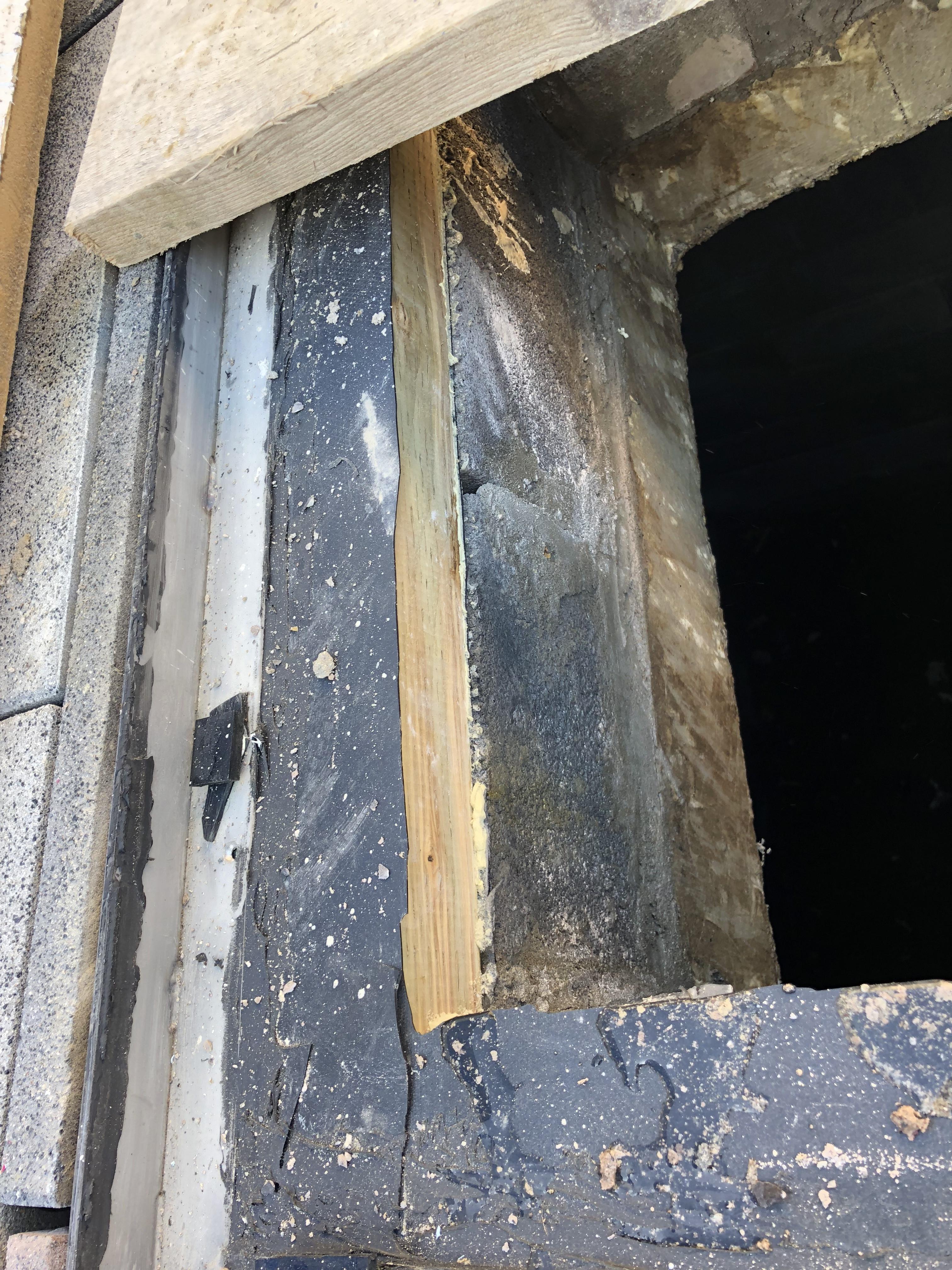

Cpd Posted October 17, 2018 Posted October 17, 2018 Looking at this corner fills me with dread..... there are obvious massive gaps where the patch has not been sealed..... if this is commonplace then you will have multiple leeks around all your windows. Sorry I have nothing helpful to say.
Pocster Posted October 18, 2018 Author Posted October 18, 2018 11 hours ago, Cpd said: Looking at this corner fills me with dread..... there are obvious massive gaps where the patch has not been sealed..... if this is commonplace then you will have multiple leeks around all your windows. Sorry I have nothing helpful to say. I know I didn’t sleep last night ? Architect coming to look at 2pm I’m starting to think I need to rip everything out - literally down to the rubber ???????

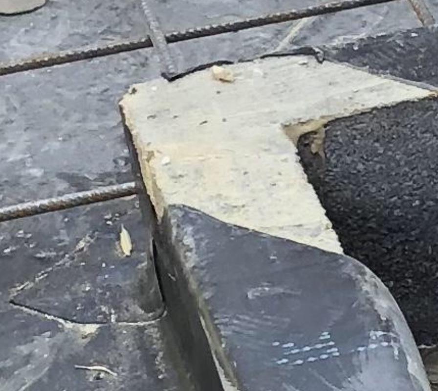

Jeremy Harris Posted October 18, 2018 Posted October 18, 2018 I think you may be able to get away with only breaking out the concrete around the upstands, if the job is tackled with a great deal of care. It seems highly likely that the joints around the upstands are the cause, from looking at all the photos you've posted. One way to do this may be to use a diamond cutter, carefully set to a depth that cuts just deeper than the rebar, to cut through the concrete that's under the pavers around every upstand, maybe a foot or so away from them. The concrete won't have adhered to the EPDM, so, with luck, you may be able to carefully crack it away and lift sections off around each upstand without damaging the EPDM. A proper repair of the EPDM can then be made, running the EPDM right up and over the point where the window frame seats. The "moat" formed by cutting away the concrete would be an effective way of testing for water ingress after the repair, too. If the roof still leaks after doing this, then I think it may all have to come up, but I reckon it's worth a try at a minimally invasive fix first.
Pocster Posted October 18, 2018 Author Posted October 18, 2018 1 hour ago, JSHarris said: I think you may be able to get away with only breaking out the concrete around the upstands, if the job is tackled with a great deal of care. It seems highly likely that the joints around the upstands are the cause, from looking at all the photos you've posted. One way to do this may be to use a diamond cutter, carefully set to a depth that cuts just deeper than the rebar, to cut through the concrete that's under the pavers around every upstand, maybe a foot or so away from them. The concrete won't have adhered to the EPDM, so, with luck, you may be able to carefully crack it away and lift sections off around each upstand without damaging the EPDM. A proper repair of the EPDM can then be made, running the EPDM right up and over the point where the window frame seats. The "moat" formed by cutting away the concrete would be an effective way of testing for water ingress after the repair, too. If the roof still leaks after doing this, then I think it may all have to come up, but I reckon it's worth a try at a minimally invasive fix first. Ok - you understand my concern ; assume worst - hope for best . Will break out around the worst window . Will post pics

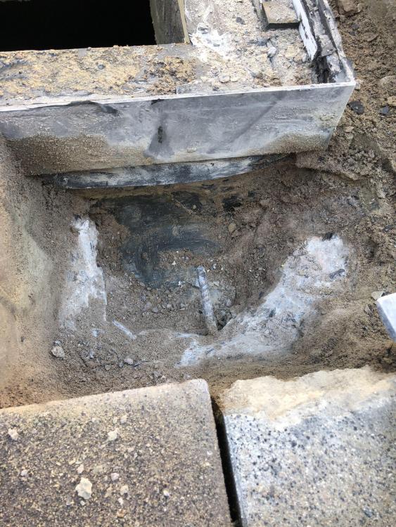

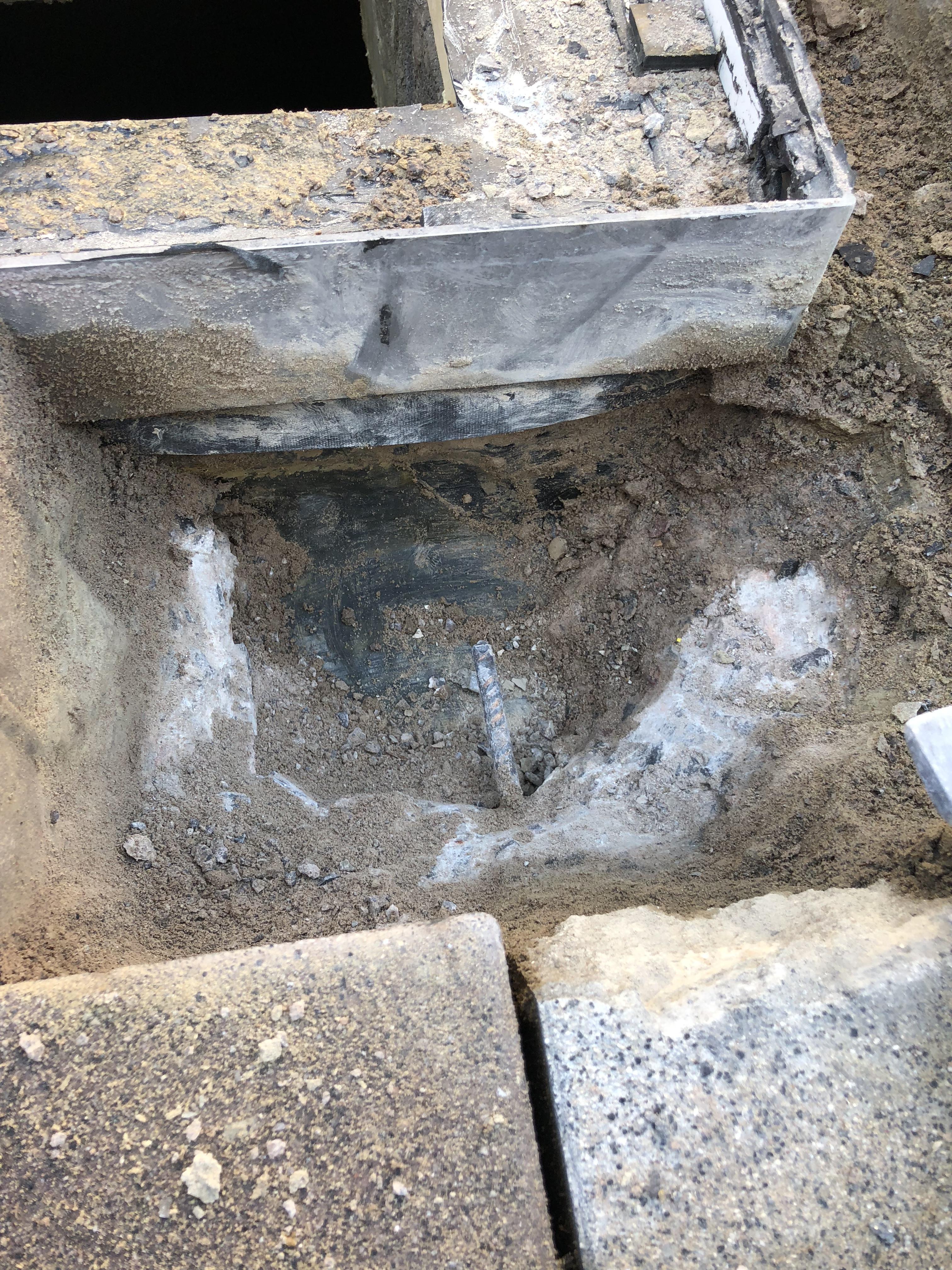

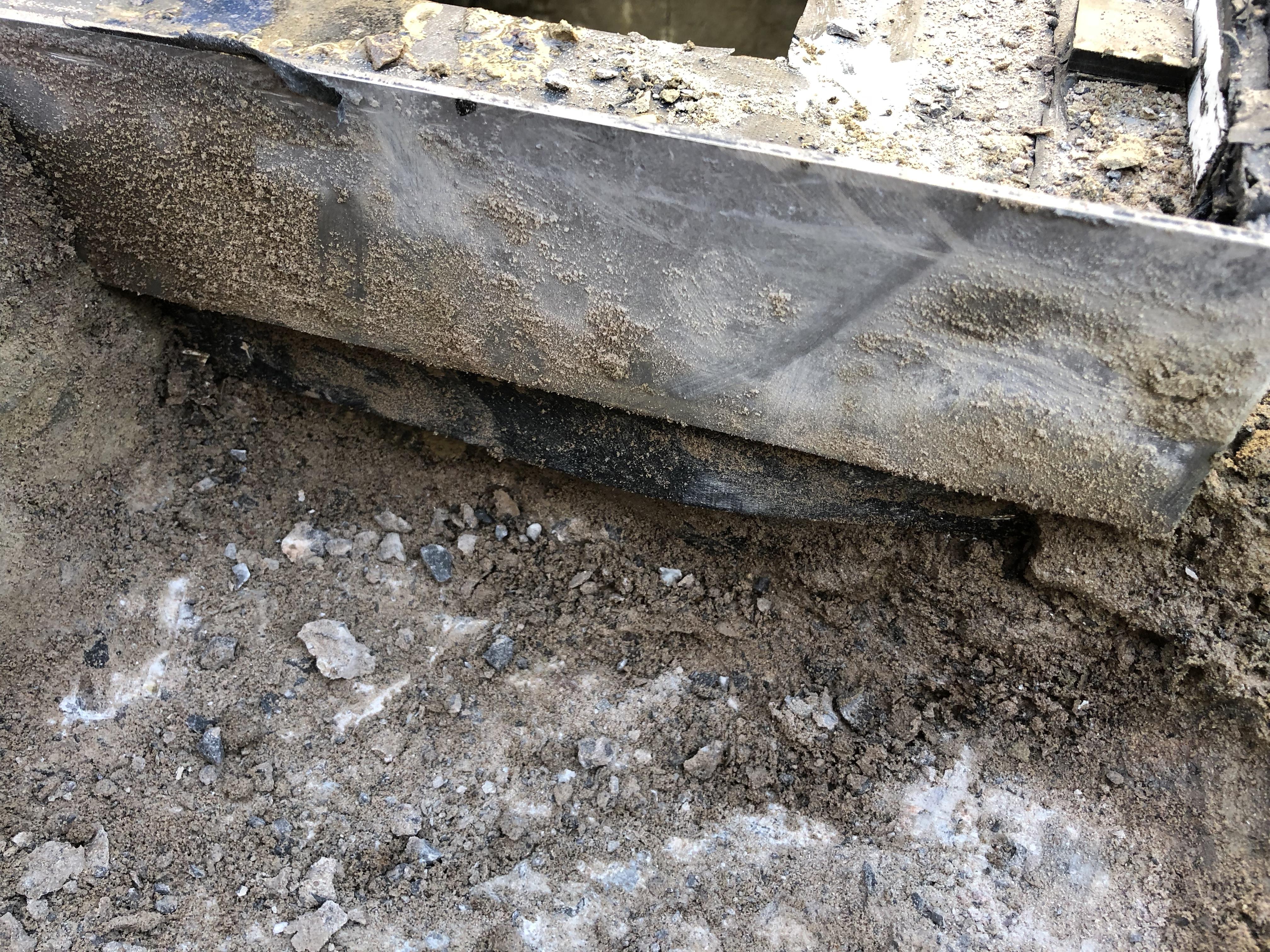

Pocster Posted October 18, 2018 Author Posted October 18, 2018 I’m not sure about this ! Dead slow !! Managed on the shallowest part to get down to the rebar layer . Carefully by hand removing cement away from rubber upstand . There’s a completely unsealed bit ! . This window I didn’t add upstand height too - so this was the quality roofers ! The more I dig the more certain I’ll be taking the lot up . From the edge pavers should come up easily for re use .

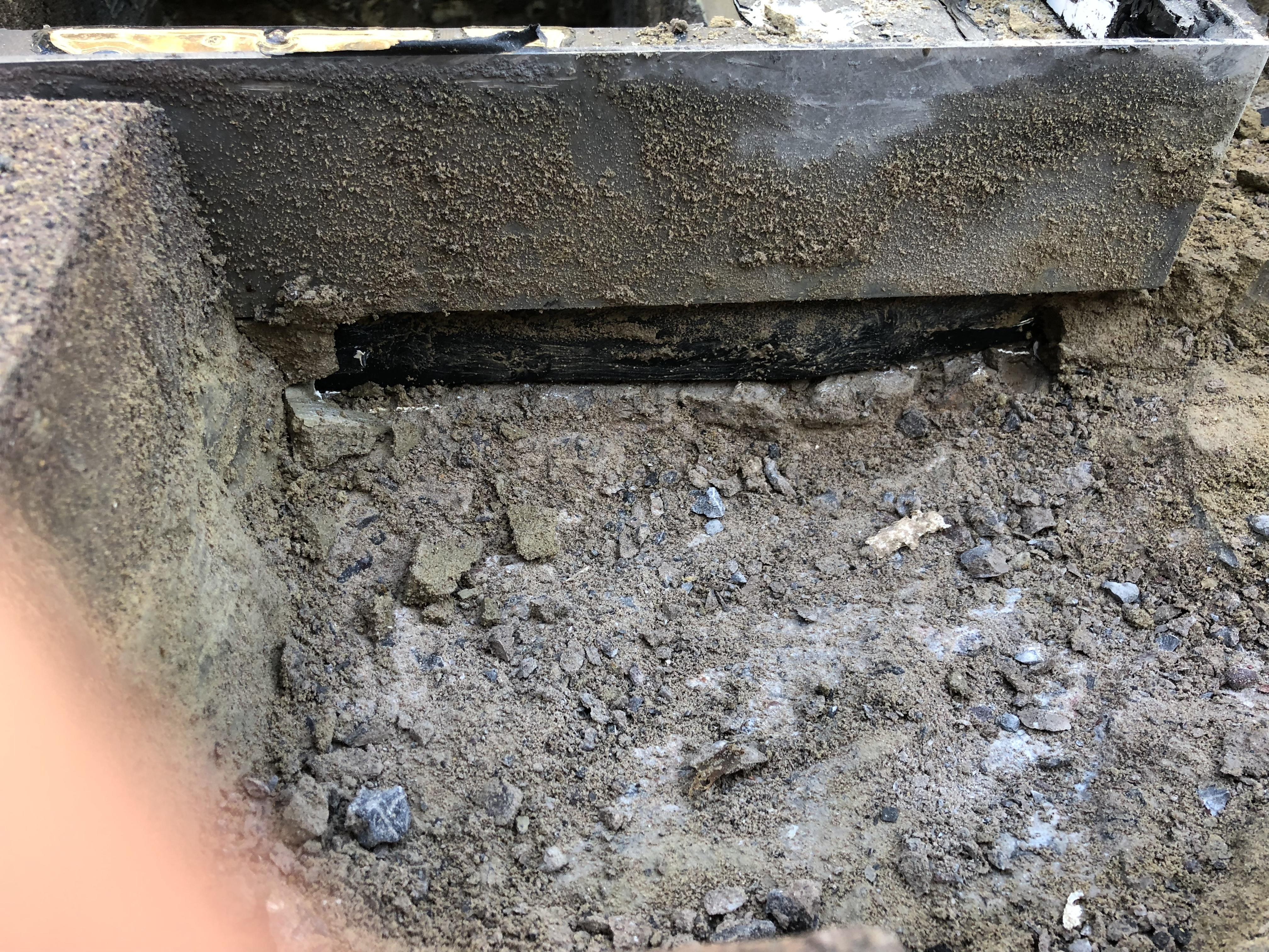

Pocster Posted October 18, 2018 Author Posted October 18, 2018 Definitely did not heighten this one - can prove it ! Too the left you see my concrete block then the wooden firring - no additional height stuff . The more I dig the more disillusioned I get . Can clearly see this lap is free ffs !
Pocster Posted October 18, 2018 Author Posted October 18, 2018 I’ll wait for Architect- but I think start from scratch will be his advice .....
