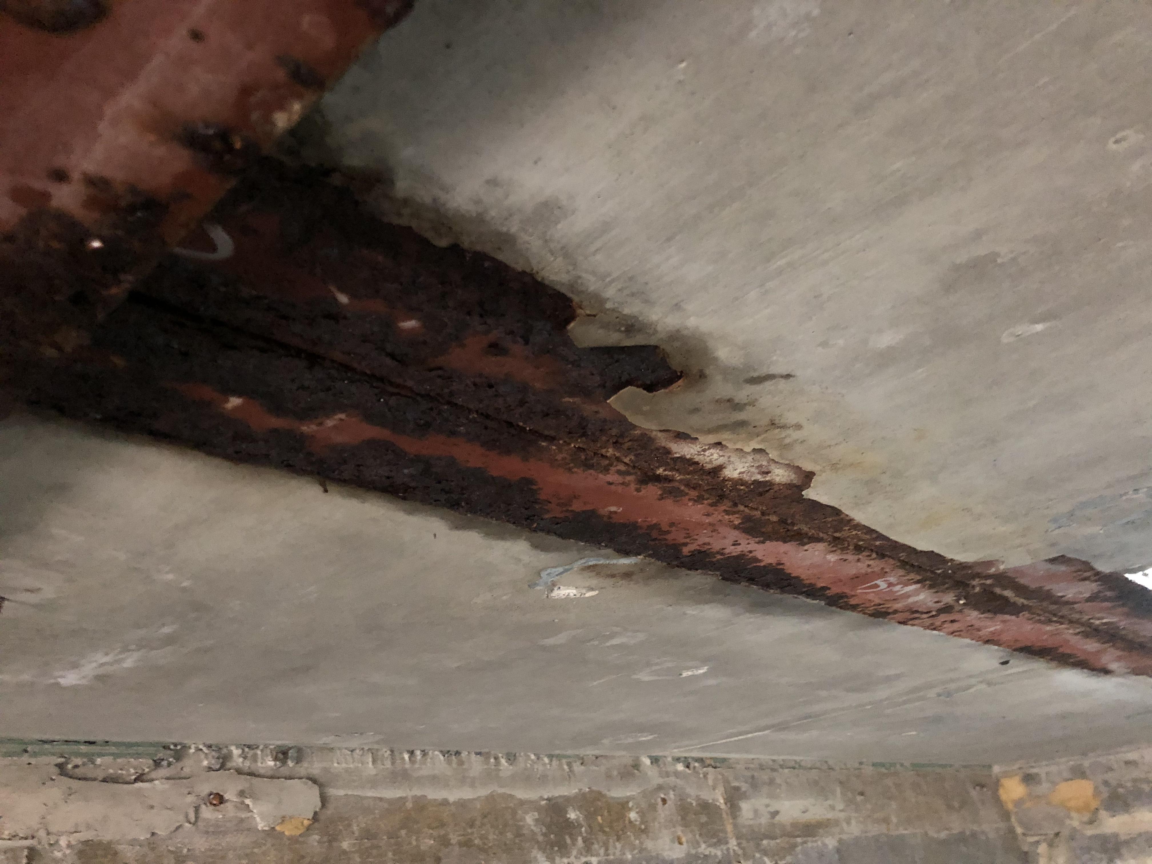

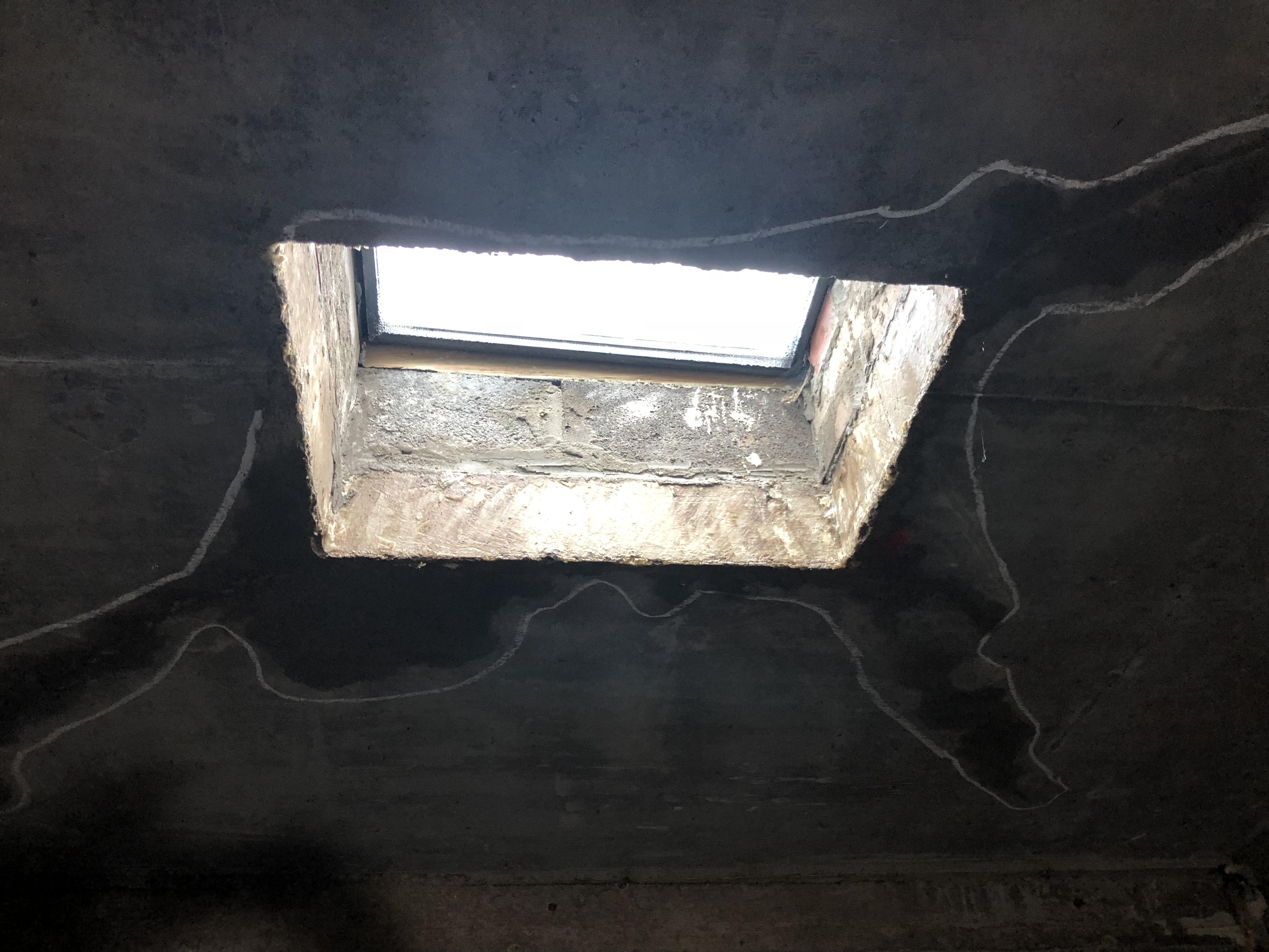

Pocster Posted October 16, 2018 Author Posted October 16, 2018 Looking at the 3rd photo I.e underneath up at the sky light . You can see the water tracking from the corners . My *assumption* is somewhere the water gets under the rubber then ‘comes out’ at that point . Rather than the water ran from the edge ( following the track marks back ) to the opening . This a sensible thought ? Or not .....
Onoff Posted October 16, 2018 Posted October 16, 2018 11 minutes ago, pocster said: Not sure exactly what you mean by drainage above edpm . The block paving runs into drainage channel . The edpm has 35mm on concrete on it . Not to mention my concrete to bed the pavers . I did a water test ( when just edpm was down ) - flooded the site ( but not going over the edges I.e where flashing would be ) - no leaks ; hence did the pour . Gut feel is with you, that it's "tracking" from elsewhere. 1
Pocster Posted October 16, 2018 Author Posted October 16, 2018 8 minutes ago, Onoff said: Gut feel is with you, that it's "tracking" from elsewhere. Yeah - I’m trusting my gut - this problem keeps me awake at night ☹️ Although an atheist I’ll pray for rain ; then if all the track marks go I *know* it’s the flashing - and that’s accessible and fixable . Who builds a fucking house underground anyway !

Pocster Posted October 16, 2018 Author Posted October 16, 2018 14 minutes ago, pocster said: Looking at the 3rd photo I.e underneath up at the sky light . You can see the water tracking from the corners . My *assumption* is somewhere the water gets under the rubber then ‘comes out’ at that point . Rather than the water ran from the edge ( following the track marks back ) to the opening . This a sensible thought ? Or not ..... Really want a time lapse camera pointing at the underside of the opening ! - then could see which way the water runs ?
Mr Punter Posted October 16, 2018 Posted October 16, 2018 Perhaps take up the paving just around the rooflight to expose the membrane.

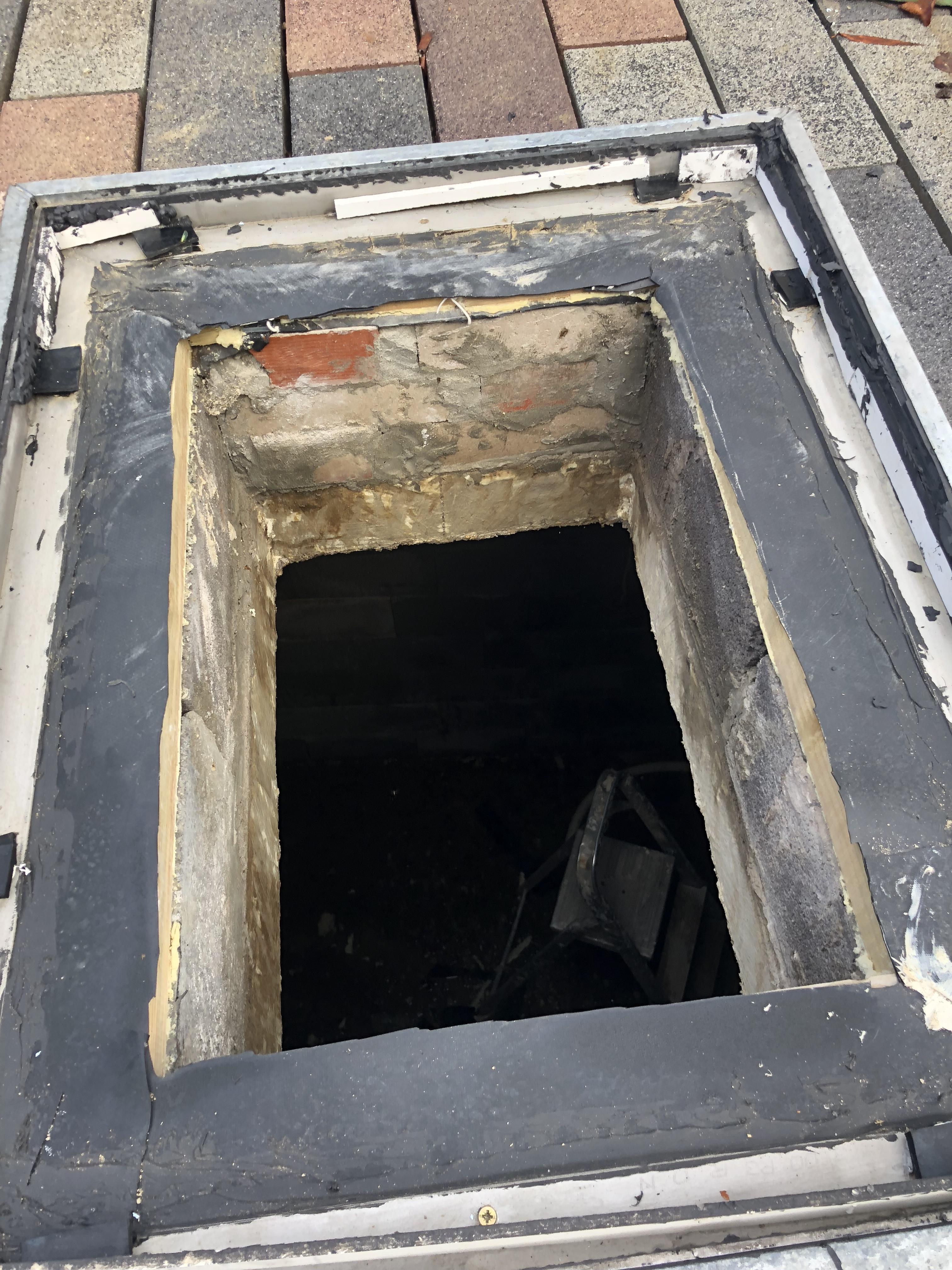

Pocster Posted October 16, 2018 Author Posted October 16, 2018 7 minutes ago, Mr Punter said: Perhaps take up the paving just around the rooflight to expose the membrane. Yeah that’s my next possible option . Out of 4 walk on glass only 2 are fully installed . The other ‘ complete one ‘ has clammy blockwork in its up stand - unlikely both had damaged rubber or bad install by me ?

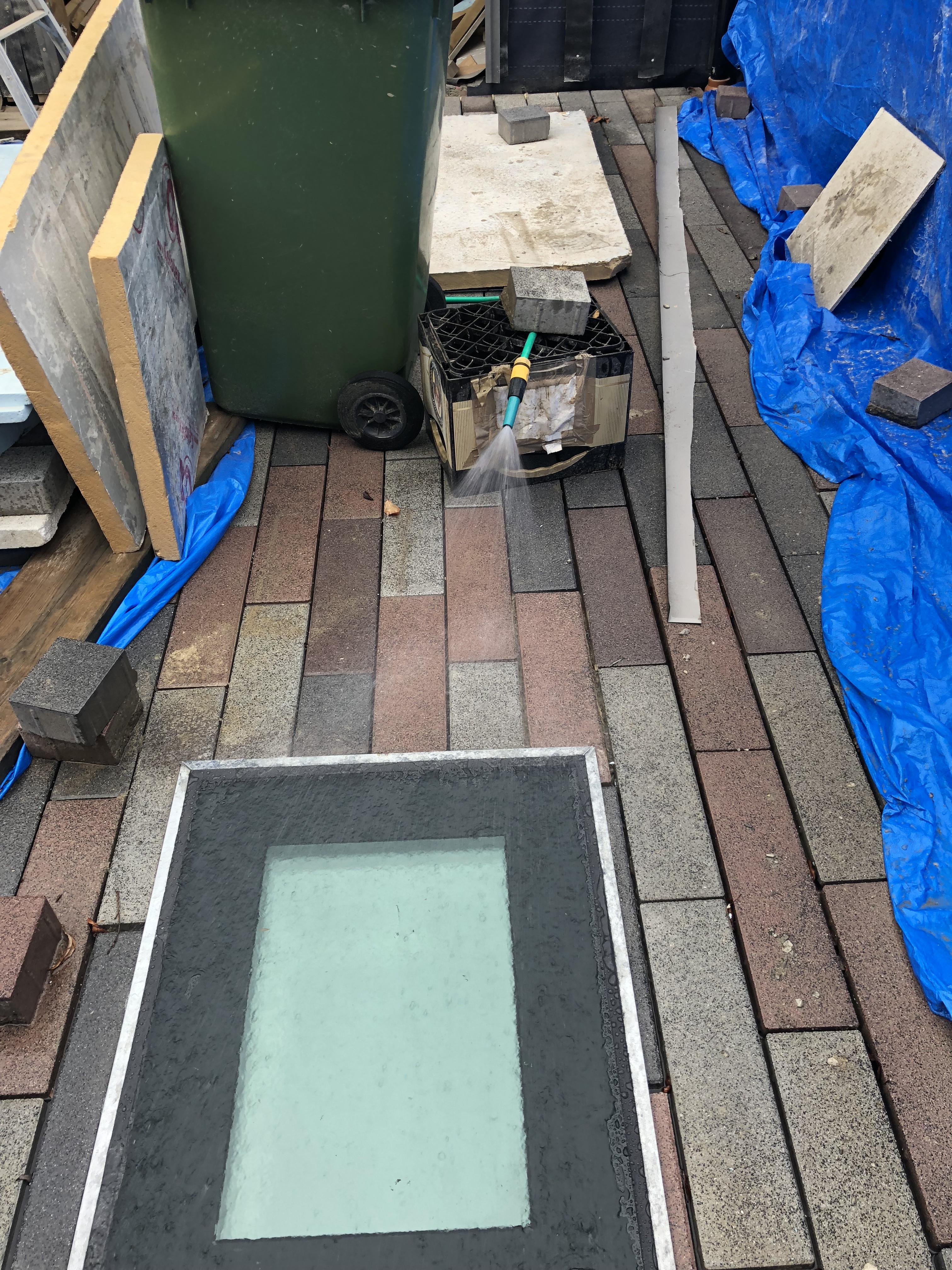

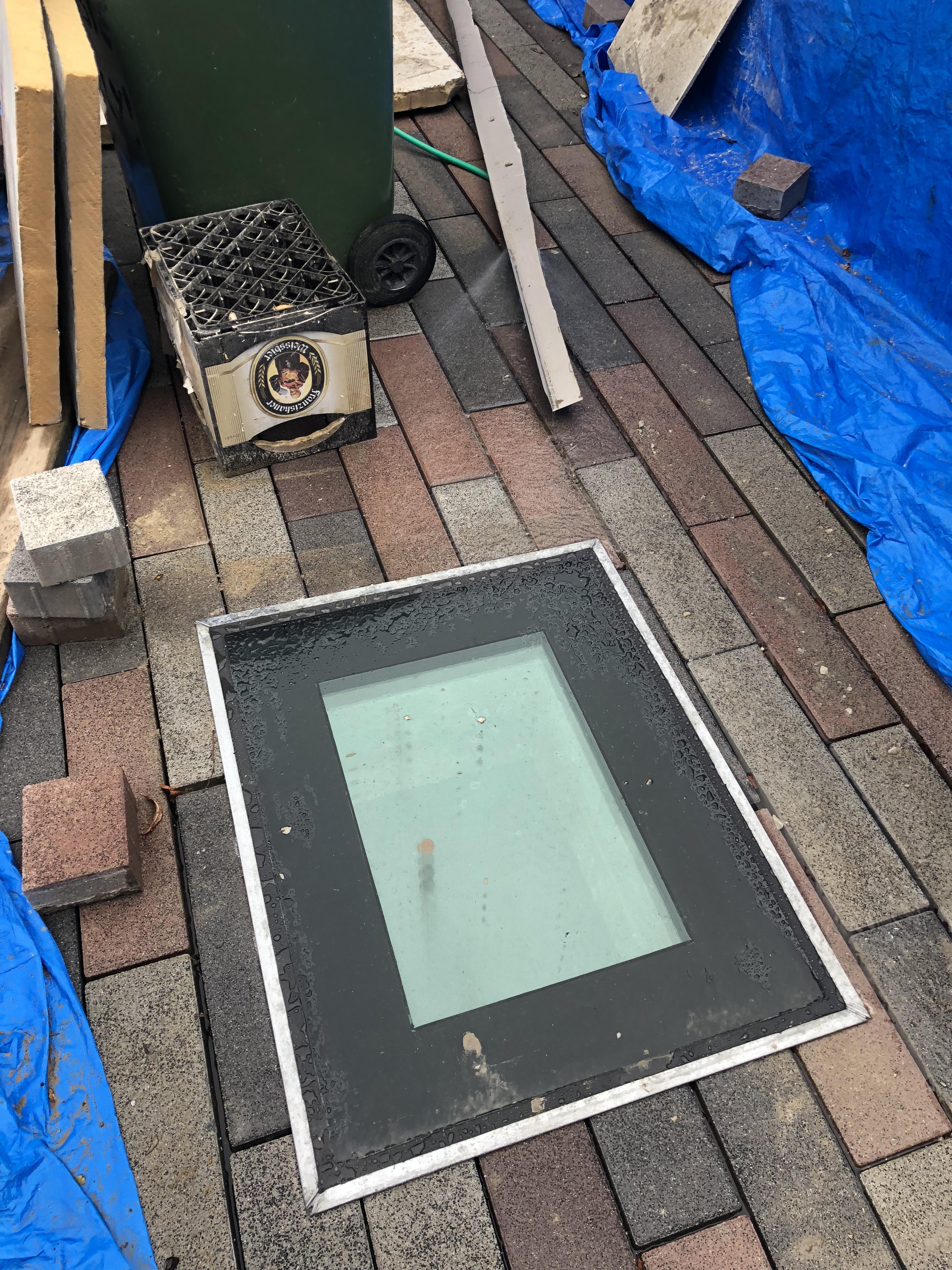

Pocster Posted October 17, 2018 Author Posted October 17, 2018 Stuck hose pipe spraying over corner and side of window . So it’s getting saturated and water is flowing right over it
Pocster Posted October 17, 2018 Author Posted October 17, 2018 Right ! hosing it A few drops formed underneath !!! So can’t be flashing Dead body white line so I don’t kid myself it’s getting better ?

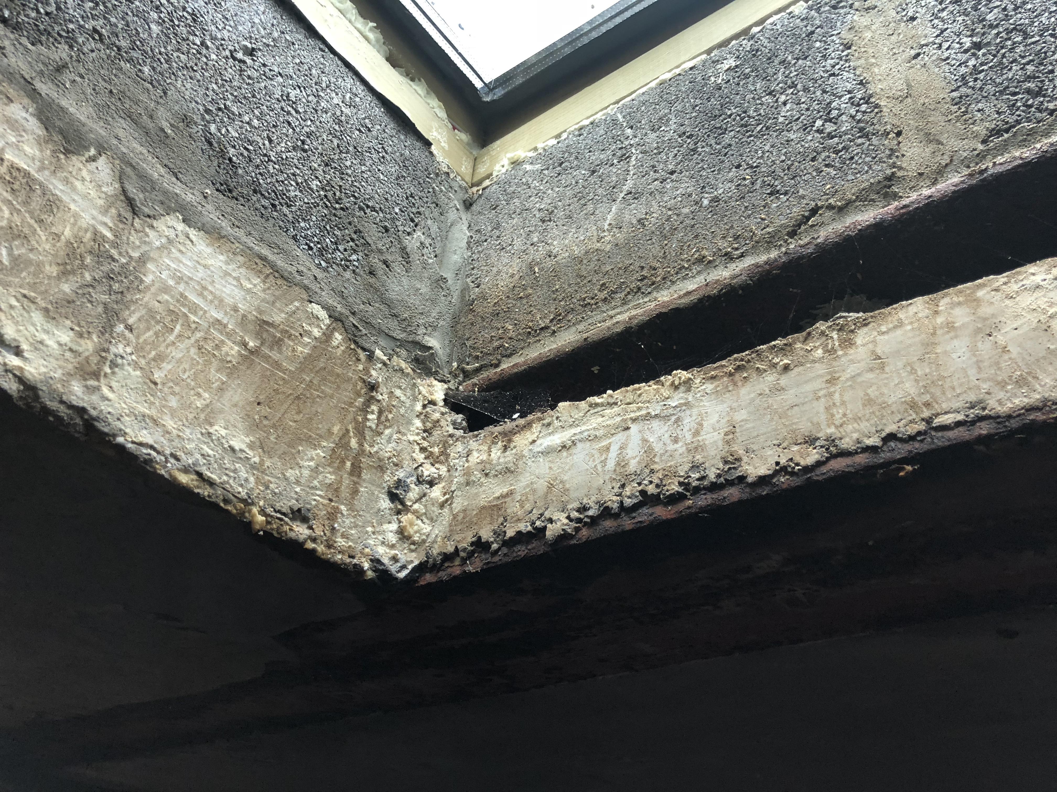

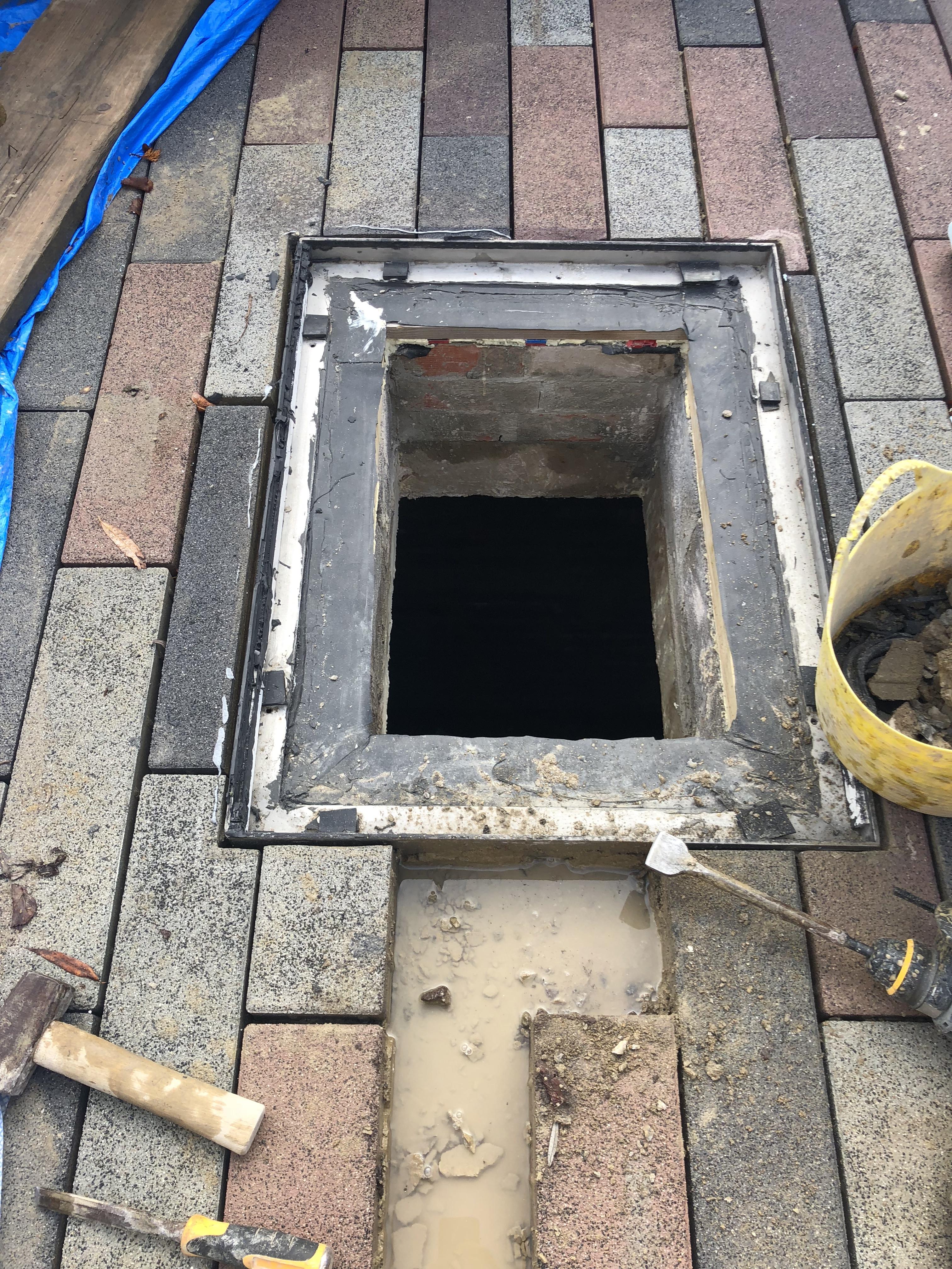

Pocster Posted October 17, 2018 Author Posted October 17, 2018 (edited) Glass out ( again ) can clealy see on the block work the water ingress line Now to get the frame out and break out all the surrounding blocks ? Edited October 17, 2018 by pocster
Mr Punter Posted October 17, 2018 Posted October 17, 2018 OK well hopefully you have now established the cause. Before you put it all together again, can you get someone to do a proper design and spec for you to follow as winging it has not worked so far.

Pocster Posted October 17, 2018 Author Posted October 17, 2018 I’m not even sure breaking this out is the correct thing ! The water is running under the rubber - doesn’t mean it’s at the base of the upstand - could be anywhere as my hose test proved ! Feel a bit stuck !
Pocster Posted October 17, 2018 Author Posted October 17, 2018 Probably a stupid thing to mention but hey ho . My pavers haven’t been in filled with sand yet . So obviously water runs between them and somehow finds it way in . Not sure if that’s relevant- just desperate ☹️☹️☹️☹️☹️☹️

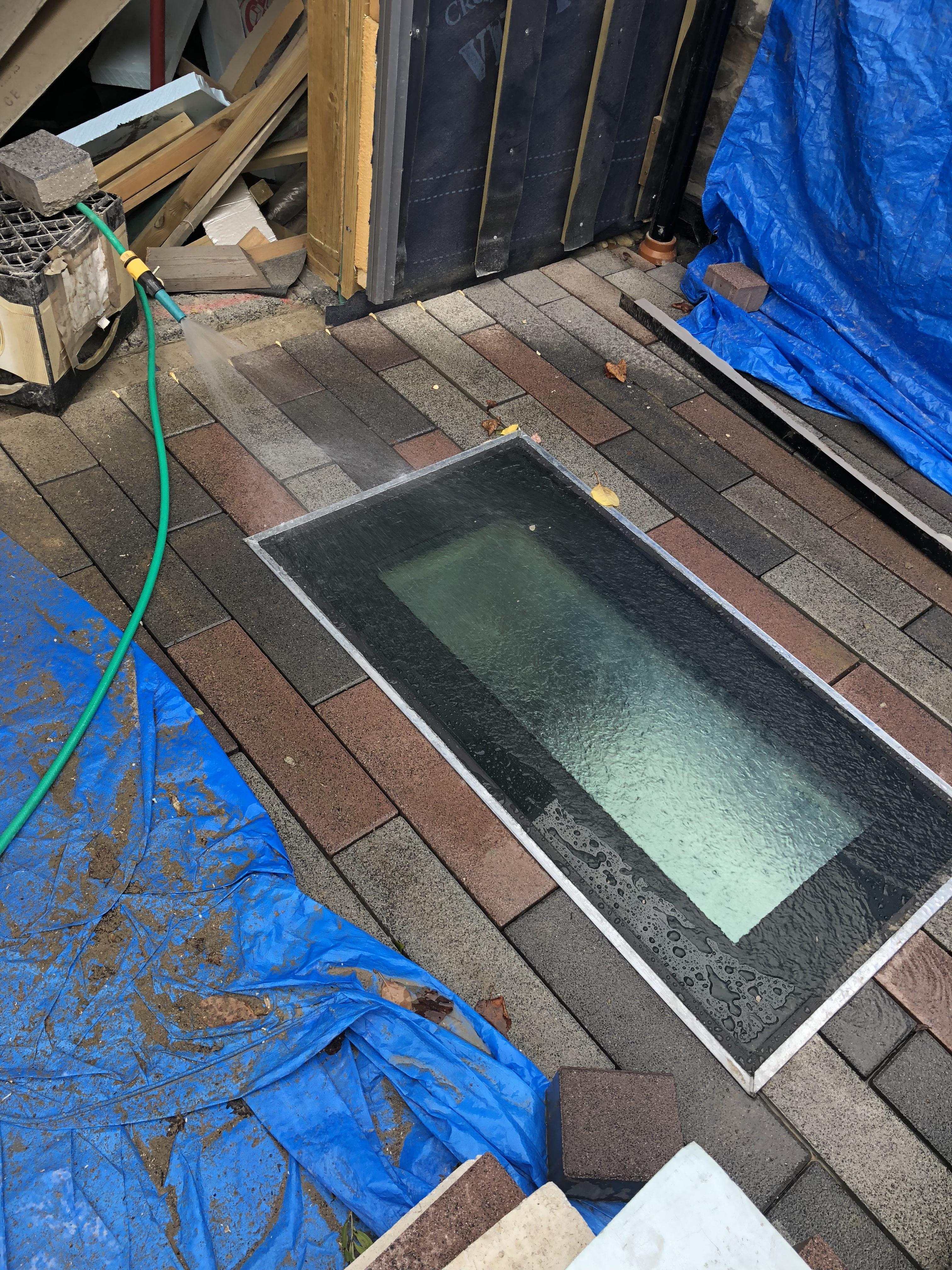

Pocster Posted October 17, 2018 Author Posted October 17, 2018 Larger window leaks with hose on it but no where near as bad - hardly good news though
Pocster Posted October 17, 2018 Author Posted October 17, 2018 Spoke too soon tracking back via the steel
Jeremy Harris Posted October 17, 2018 Posted October 17, 2018 Looks like the pavers are always going to sit in a puddle of water, as there doesn't seem to be any way for water to drain away underneath them. Not sure how you can fix that easily at this stage. The water level looks like it can get up to the top of the pavers, so that's going to make the sealing around the windows challenging. Not sure how you can solve this, TBH. My best guess is that water is either getting in through the corners around the windows, where the original EPDM corner joints didn't look that neat and tidy, or it's just getting in through the window frame to EPDM seal and running under and into the blockwork. Any sealant you try and seal this with now is probably going to fail at some point, as this window and frame is going to be subjected to movement from thermal expansion and contraction plus the load from cars and people walking over it. Hopefully someone can come up with an idea that might fix this.

Jeremy Harris Posted October 17, 2018 Posted October 17, 2018 Would it be possible to provide some sort of linear drain across the pavers, by cutting slots out to an edge? Not sure if it would help much, but I think that, for any sealing fix to work it's going to help a lot if there isn't water sat in a puddle around the window upstands.
