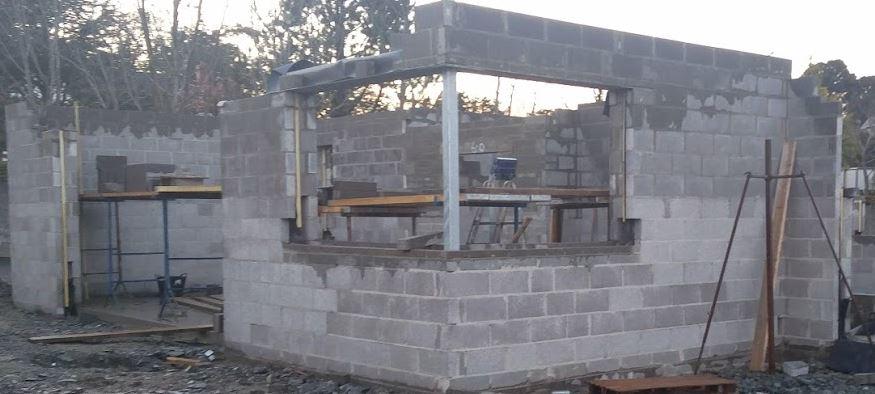

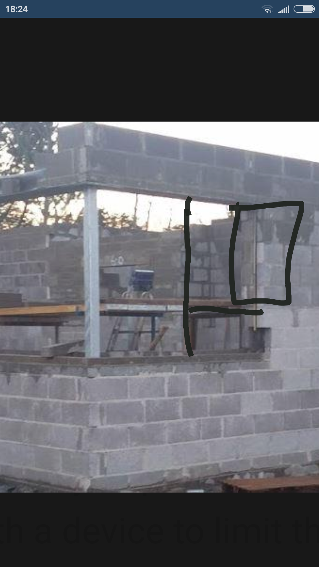

JohnW Posted May 17, 2018 Share Posted May 17, 2018 Hi, We have 2 corner windows, Ground floor & First floor same sized opening. The photo shows the Ground floor, the First floor opening will be directly above it. The opening dimensions are 1500mm tall and 2400mm wide each side. We would like to be able to fully open the First floor set and the only thing I can think of is a short set of glazed bifold doors i.e 1500mm tall. So my questions are; Is it possible to get bifold windows and if so can anyone recommend a supplier Is there a solution other than bifold? I would appreciate any ideas of suitable products that would allow us to open the space fully. Thanks John Link to comment Share on other sites More sharing options...
Jeremy Harris Posted May 17, 2018 Share Posted May 17, 2018 I think you may run into a problem with the regs, if they are the same as here, as they require first floor windows to be fitted with a device to limit the opening, so a child can't just open the window fully and fall out. Usually these restrictors can be unlatched, but it's a two handed job, deliberately so, to make it difficult for a small child to do. For that reason I doubt that you could get a bifold system to work, plus bifold doors are notorious for losing airtightness after a year or two, as the sealing force on the folding joint is pretty hard to maintain. 2400mm is too wide for a single side opening casement, too, although you might be able to find someone who would make custom top hinged frames; I'm not all sure how wide you can go with top hinges, but it'd be little different to a glazed door fitted on it's side. Restrictors would still be needed, but they can be fitted easily enough to top hinged glazing. One challenge to overcome is how to insulate the corner pillar to prevent a thermal bridge and the associated condensation risk, which may be difficult if you want a slim look in the corner with the windows open. Finally, how high above the floor is the lower edge of the first floor opening? I can't recall off the top of my head what the regs say about the minimum height for the lower edge of a fully opening aperture, but have a feeling it's around 1100mm above floor level. If the windows are 1500mm high, then unless the room has higher than average ceilings, you may run into problems there, too. Worth checking the regs that apply in NI, though, as they may well be different to those that apply here, so some of the points above may not be correct. 1 Link to comment Share on other sites More sharing options...
JohnW Posted May 17, 2018 Author Share Posted May 17, 2018 Thanks @JSHarris, I hadn't thought about the restrictors, although I assume they could be put in place if for example, we have a 3 x 800mm panel bifold system with the 1st panel behaving like a traffic door/window? It's certainly something I will be asking suppliers when I find one that does supply bifold windows. Regarding the height from the floor, the window sill will be at 900mm (so no need for toughened safety glass) and the head of the window at 2400mm. Our ceilings will be 2600mm. I'll have to check the rules relating to fully opening apertures. Link to comment Share on other sites More sharing options...

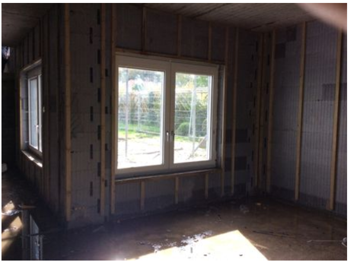

le-cerveau Posted May 18, 2018 Share Posted May 18, 2018 ARe you prepared to have a mullion in the center of the opening? If so then you can get fully opening windows each pain 1200 wide, I have them. I have one window that is 2400 wide and 1800 high with 2 pains and a single mullion 1 Link to comment Share on other sites More sharing options...

JohnW Posted May 18, 2018 Author Share Posted May 18, 2018 3 hours ago, le-cerveau said: ARe you prepared to have a mullion in the center of the opening? If so then you can get fully opening windows each pain 1200 wide, I have them. I have one window that is 2400 wide and 1800 high with 2 pains and a single mullion Thanks @le-cerveau, I'm not sure how that would work at the corner, have you any photos of yours to help me visualise? Link to comment Share on other sites More sharing options...

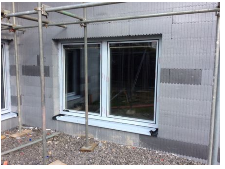

le-cerveau Posted May 18, 2018 Share Posted May 18, 2018 20 minutes ago, JohnW said: Thanks @le-cerveau, I'm not sure how that would work at the corner, have you any photos of yours to help me visualise? This is all I have to hand, the first one is the 2400 wide from the outside. Second one shows both inside, this one is 2000 wide, you can just see the 2400 round the corner. These are internorm units triple glazed with internal blind's 1 Link to comment Share on other sites More sharing options...

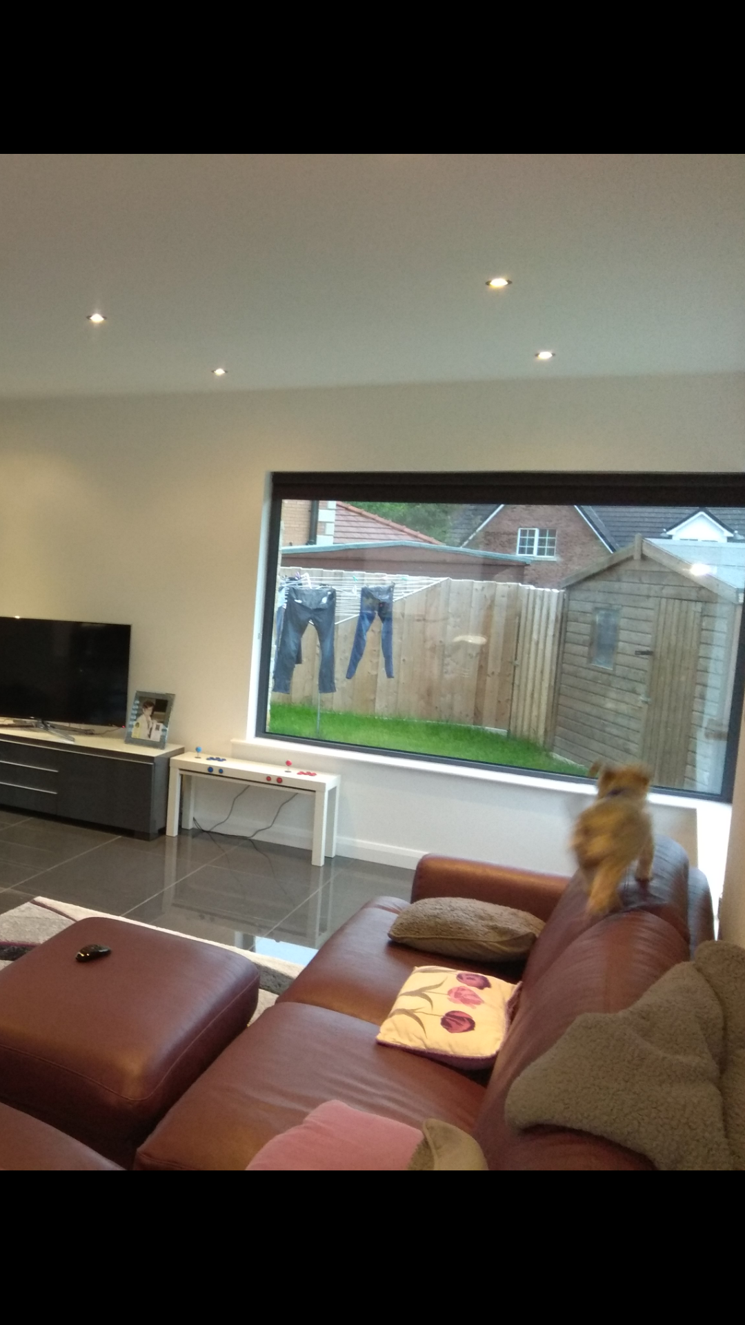

Declan52 Posted May 18, 2018 Share Posted May 18, 2018 41 minutes ago, JohnW said: @Declan52, it must be a big window, what are the dimensions? Yeah it's just one single pane of triple glazing. I reckon it's close on 2.2m X 1.5m. It is south facing so let's in a lot of light which is what we wanted plus you get a fair amount of heat from solar gain. On the downside the blinds weren't cheap!!! But during spring and autumn when the sun is lower you have to have the blinds down or you cant watch TV . That's the only pic I have on my phone but the other window coming down is the same size. Link to comment Share on other sites More sharing options...
JohnW Posted May 18, 2018 Author Share Posted May 18, 2018 2 hours ago, Declan52 said: Yeah it's just one single pane of triple glazing. I reckon it's close on 2.2m X 1.5m. It is south facing so let's in a lot of light which is what we wanted plus you get a fair amount of heat from solar gain. On the downside the blinds weren't cheap!!! But during spring and autumn when the sun is lower you have to have the blinds down or you cant watch TV . That's the only pic I have on my phone but the other window coming down is the same size. Class big window, who did you get your windows from? (looks like the dog is about to launch himself out through it) Thanks for sharing. Link to comment Share on other sites More sharing options...
Declan52 Posted May 18, 2018 Share Posted May 18, 2018 32 minutes ago, JohnW said: Class big window, who did you get your windows from? (looks like the dog is about to launch himself out through it) Thanks for sharing. From baskil. So far so good with them but have seen plenty of their bad jobs. There is always cats out on the left handside and the dog goes nuts trying to get at them. 1 Link to comment Share on other sites More sharing options...
