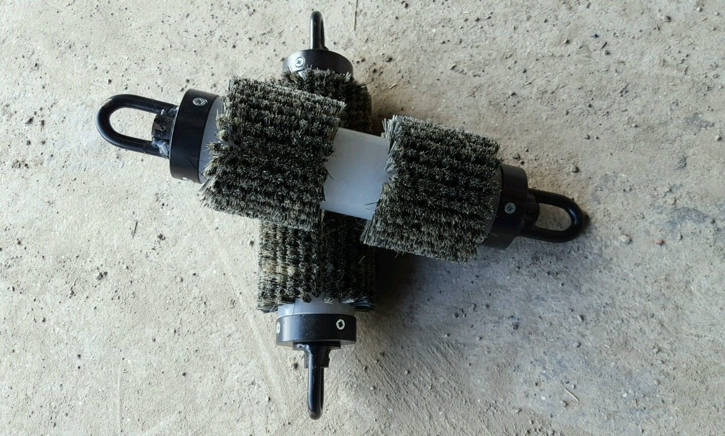

Jeremy Harris Posted July 5, 2016 Share Posted July 5, 2016 This is the only photo I can find quickly (from an ebay ad for duct pigs), but it gives an idea of how the things work: 1 Link to comment Share on other sites More sharing options...

Jeremy Harris Posted July 6, 2016 Share Posted July 6, 2016 You can get short ones that go around tight bends, foam ones, "fluffy duster" one, the one above is a hard scrubber pig to get stuff off that's really well stuck on. Some of the lighter foam pigs can just be blown through ducts with compressed air, rather than blowing a pull cord through. TBH, I don't think I'd go to the expense of buying one, as a foam ball of around the right size for the duct, with a bit of plastic pipe stuck through the middle and a couple of large washers either side would be easy enough to knock up. With a bit of cord threaded through the middle, and knotted either side, you could run it back of forth through the duct, a bit like cleaning a gun with a pull-through. Link to comment Share on other sites More sharing options...
