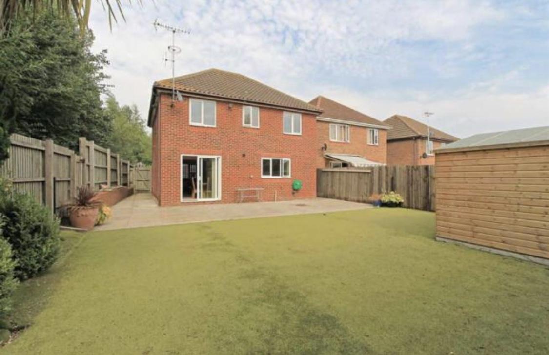

David Chapman Posted May 9, 2018 Share Posted May 9, 2018 Hi Guys, I'm looking at the options of leveling the garden and was considering, decking with artificial turf on top. I've looked at easigrass but now trying to decide on the most cost effective boards to use, decking is about £14 per square meter, I've also priced marine ply but the only thing that seems cheaper is OSB but not confident I'll get much life out of it with the amount of rain we have. Any advice or knowledge on suitable base boards? Link to comment Share on other sites More sharing options...

David Chapman Posted May 10, 2018 Author Share Posted May 10, 2018 Thanks for your response everybody, the garden in picture is a friend who's asked me to level it and astroturf but as it's 8m x8m with a 1m slope, the cost of a retaining wall and fill material was too much for him as we still had to add astroturf. To put it in perspective for him I've asked him to get 2 quotes from landscape gardeners and I'm expecting it to be £4000 - £5000. I've already replaced his fence (see picture). Link to comment Share on other sites More sharing options...

Declan52 Posted May 10, 2018 Share Posted May 10, 2018 34 minutes ago, David Chapman said: Thanks for your response everybody, the garden in picture is a friend who's asked me to level it and astroturf but as it's 8m x8m with a 1m slope, the cost of a retaining wall and fill material was too much for him as we still had to add astroturf. To put it in perspective for him I've asked him to get 2 quotes from landscape gardeners and I'm expecting it to be £4000 - £5000. I've already replaced his fence (see picture). A dry retaining wall requires no concrete so is much cheaper. Only other thing is use some concrete block to set fence posts on and then build your decking of these. The blocks will need to be bedded in concrete to stop them sinking. Link to comment Share on other sites More sharing options...
