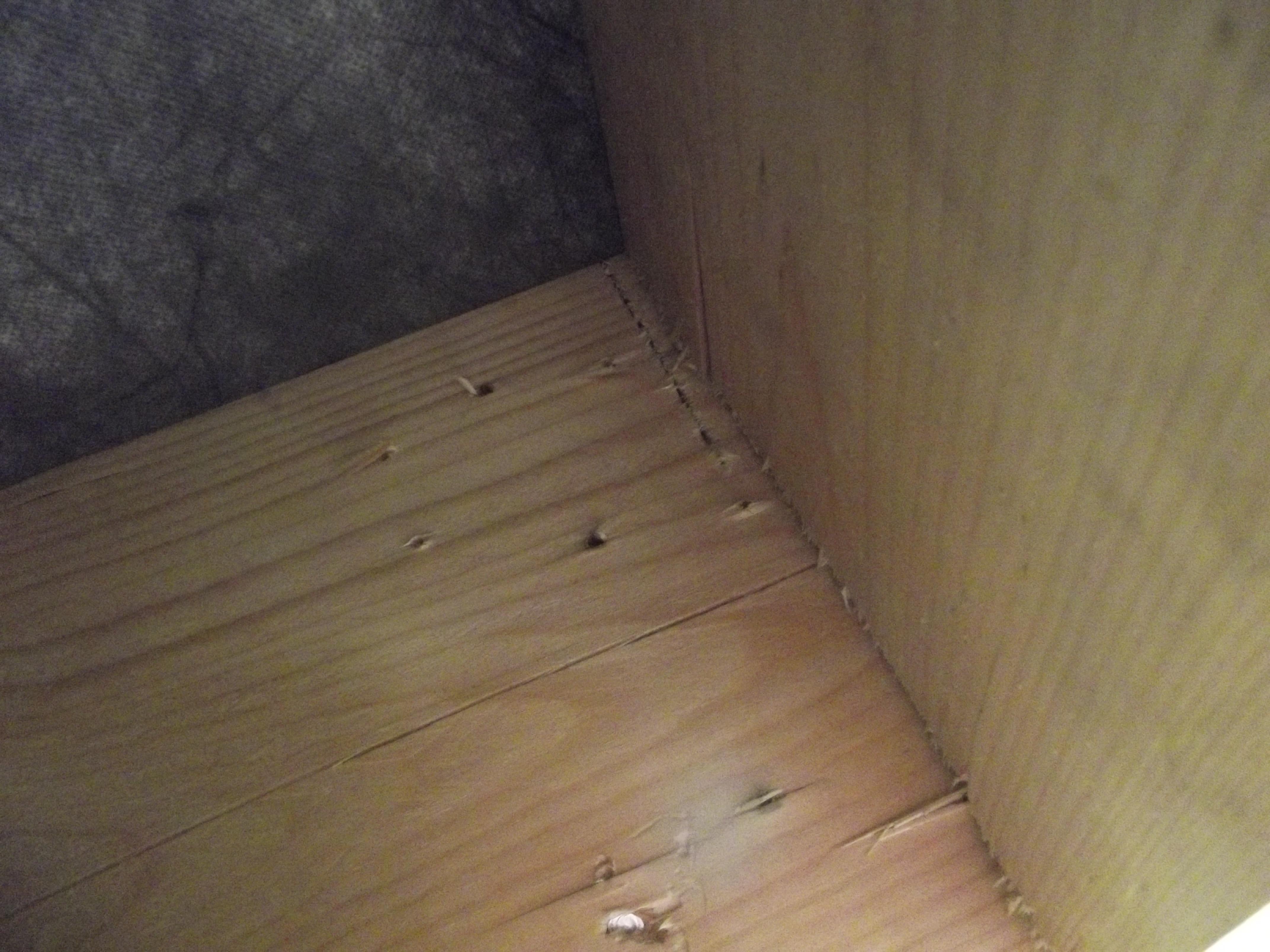

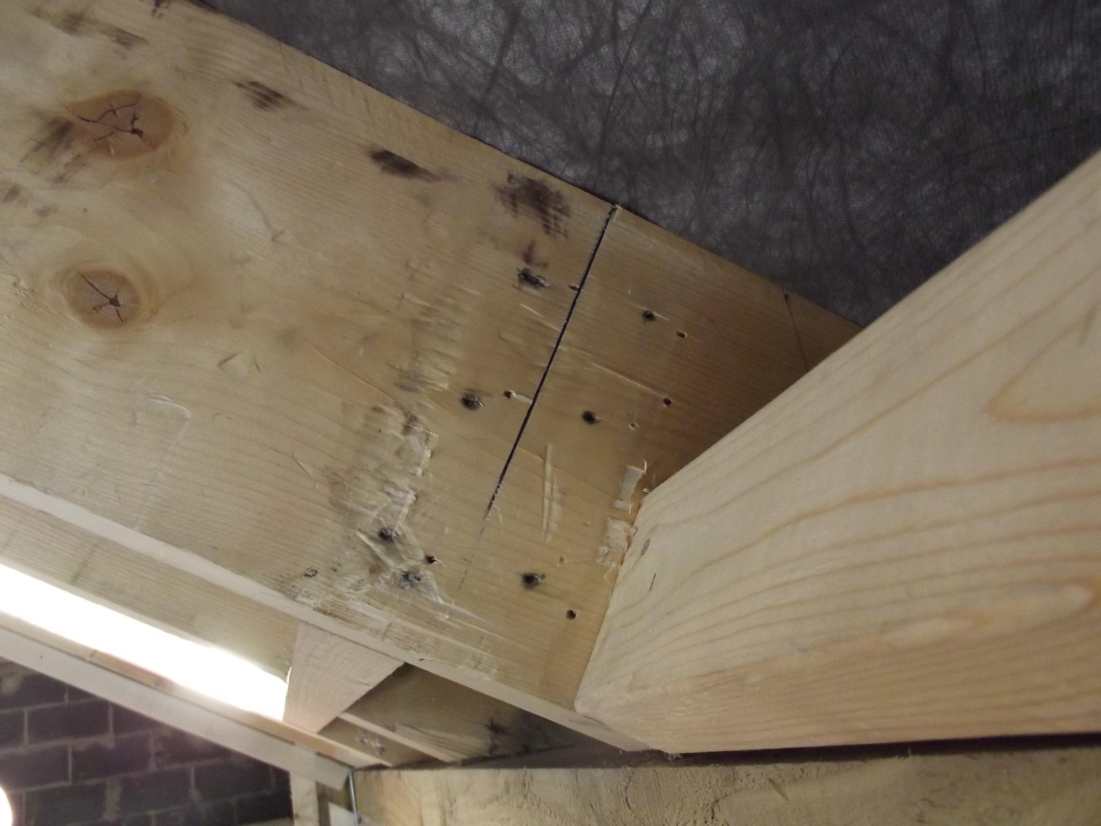

Hecateh Posted June 26, 2018 Author Share Posted June 26, 2018 (edited) In addition to bracing the roof just with cross braces (in an area that is going to form part of the bedroom ceiling,) which is bad enough - the joiners have just found this so from the diagonal it's half cut through and they had just patched it with a little square of wood so it couldn't be seen. Like 6"sq and 1/2" thick. There is a velux installed close by and it would seem that they were cutting the wrong joist for it. Edited June 26, 2018 by Hecateh 3 Link to comment Share on other sites More sharing options...
SteamyTea Posted June 26, 2018 Share Posted June 26, 2018 It's OK, just get the people that did it to come back and do it again. After informing BC, who may or maynot have seen it, but never did anything about it either way. By making a fuss you will be helping get rid of bad practice and hopefully bad building. Link to comment Share on other sites More sharing options...
