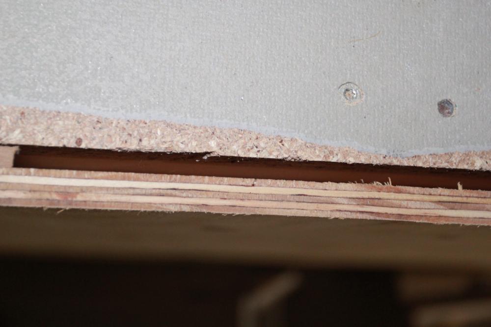

CC45 Posted April 11, 2018 Author Posted April 11, 2018 another gap filling query - I took the pic below tonight, the cheeky monkey who knocked the frame up (who obviously didn't own a level or a line) didn't get the timber up the stair well right - so its not plumb - the 12mm ply I've put up there (with PB due to go on top of this) has ended up with a gap (see pic) - at its worst its ~ 5 or 6mm wide and about 10" deep. I would like to fill this gap with something that will help strengthen the ply / PB because the stairs needs to screw into it & 12mm ply isn't very strong (18mm next time) - ideally a pour in substance (the 'cavity' is sealed). It doesn't need to be an adhesive - its just got to fill the gap. Even better would be a pour in and let it expand to fill the gap (but not push the board out). Tight for a foam gun - I wondered about some Egger D4? Any advice gratefully received. thanks
ProDave Posted April 11, 2018 Posted April 11, 2018 ^^ probably a bit late to say this, but the bottom end of your ply is floating. That will flex. I would have put a dwang (noggin) across there t catch the end of the ply and screwed it to that. Then you only have a ply and plasterboard deep gap to fill and it will be one whole lot more solid.

CC45 Posted April 12, 2018 Author Posted April 12, 2018 The ply in the pic isnt floating - there are spacers every 150mm or so - screwed back into the timber through these. How would you fill gaps @ProDave?
Onoff Posted April 12, 2018 Posted April 12, 2018 50 minutes ago, CC45 said: The ply in the pic isnt floating - there are spacers every 150mm or so - screwed back into the timber through these. How would you fill gaps @ProDave? I'm not sure what I'm even looking at from your picture...or your description. Is that gap horizontal, vertical etc? Is the slot ply one side and something else the other or hollow? Can you take one standing back a bit?
CC45 Posted April 12, 2018 Author Posted April 12, 2018 Its from above it so that gap is horizontal. One side is solid timber (part of the timber frame) - under the chipboard floor - this is the timber that goes out of plumb, the other side is the ply which comes up from the bottom of the stairs - and is plumb. Leaning towards just using Egger d4 as a filler. Not on site at min for extra pic.
