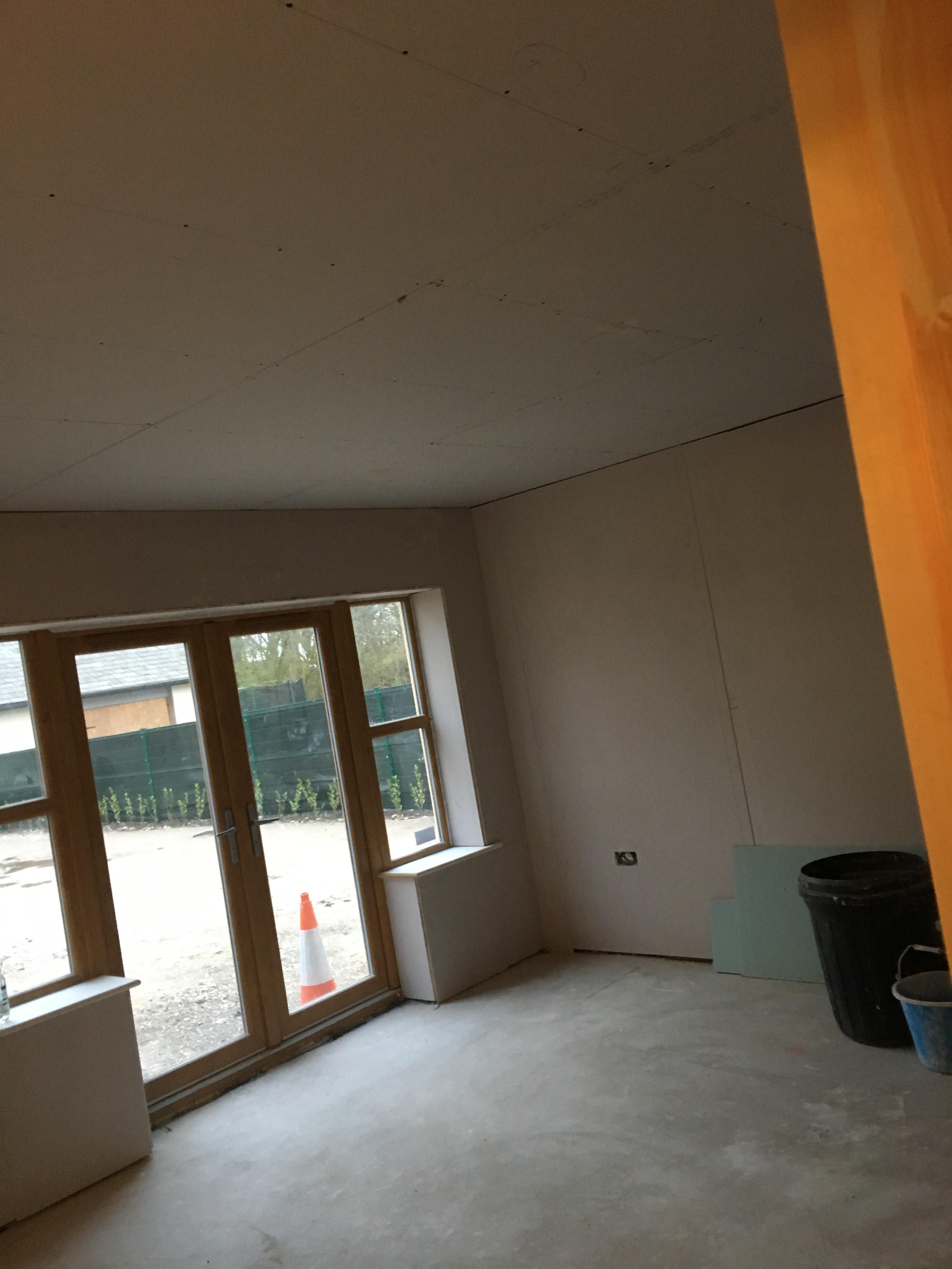

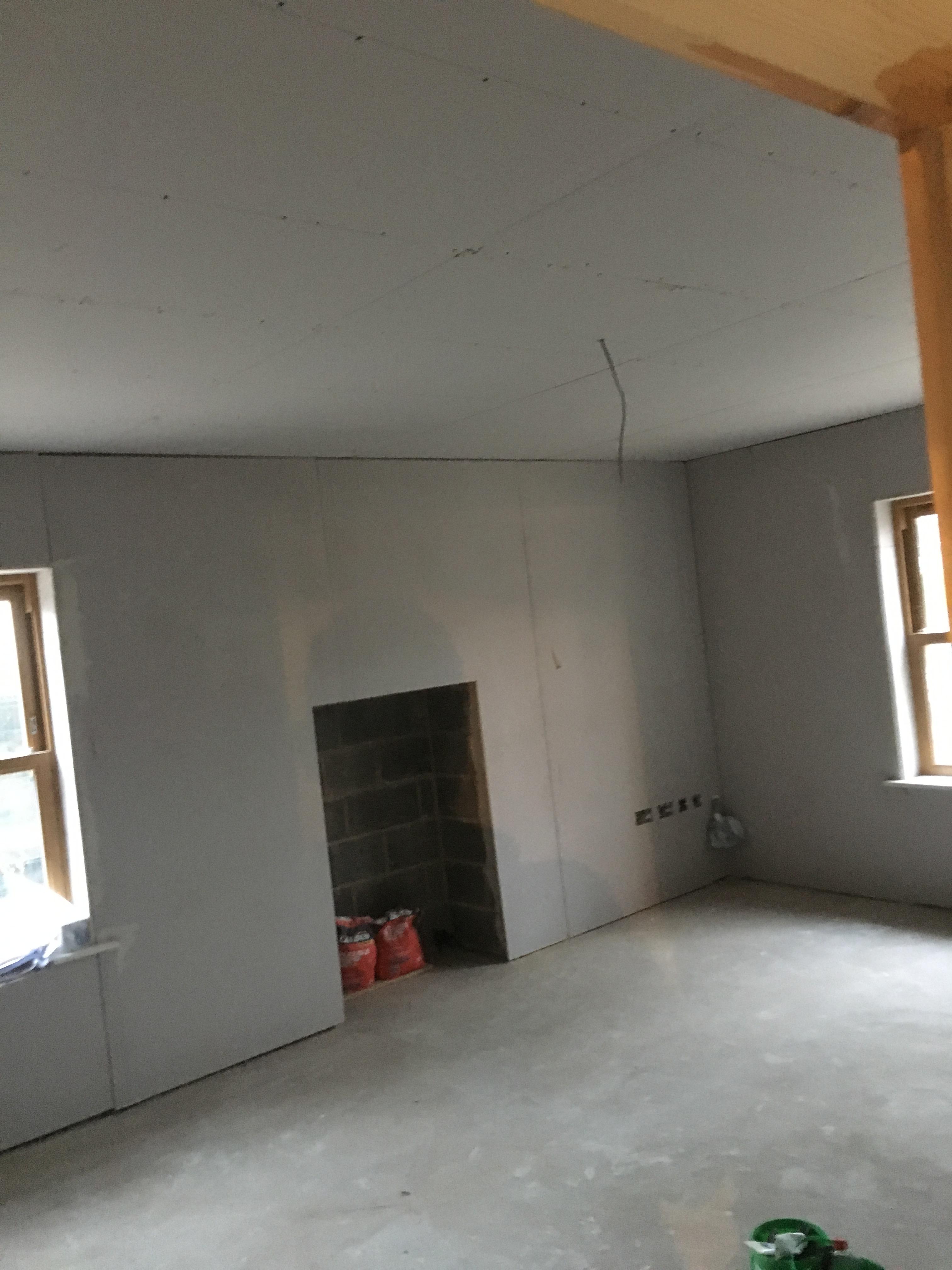

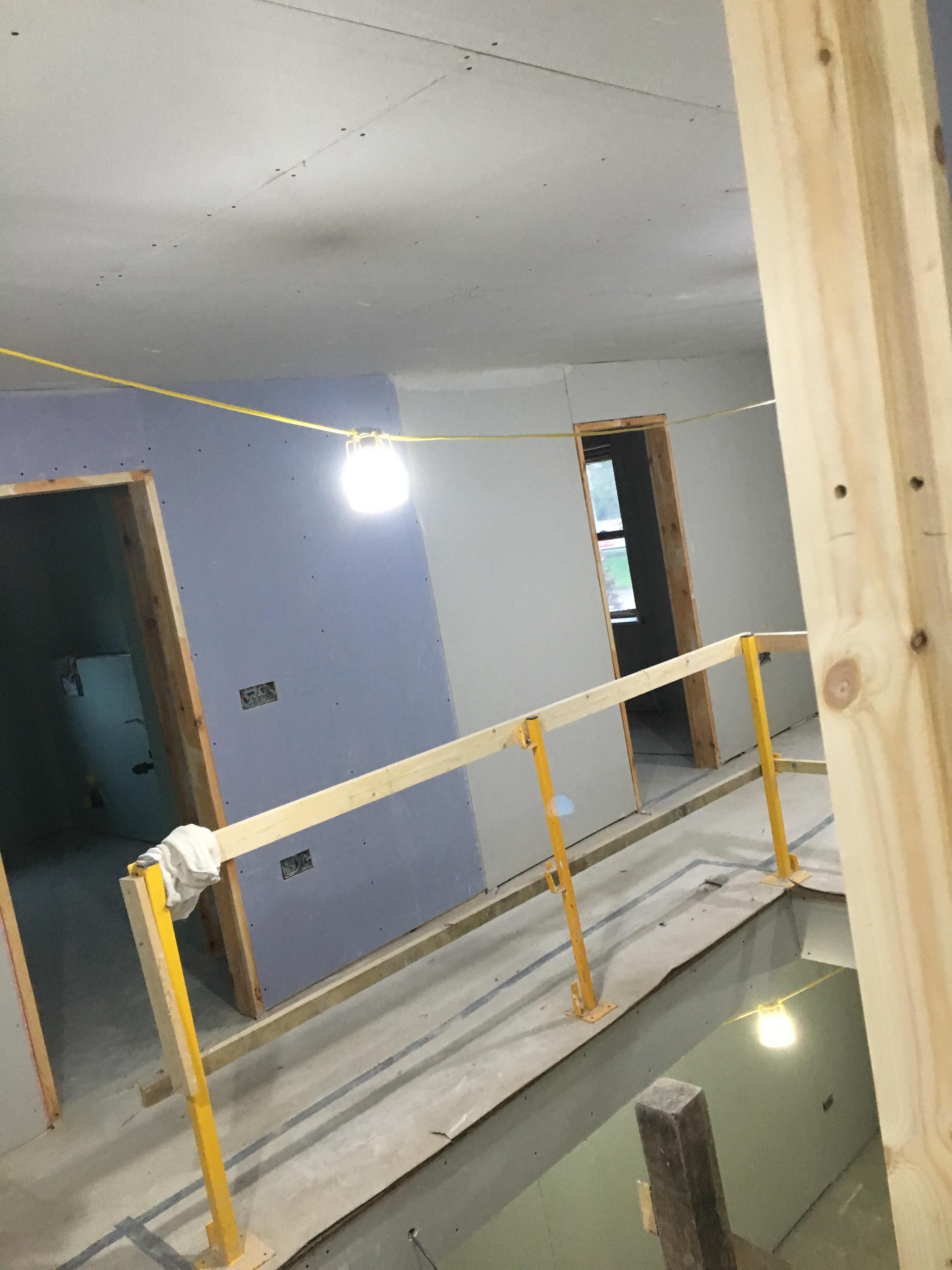

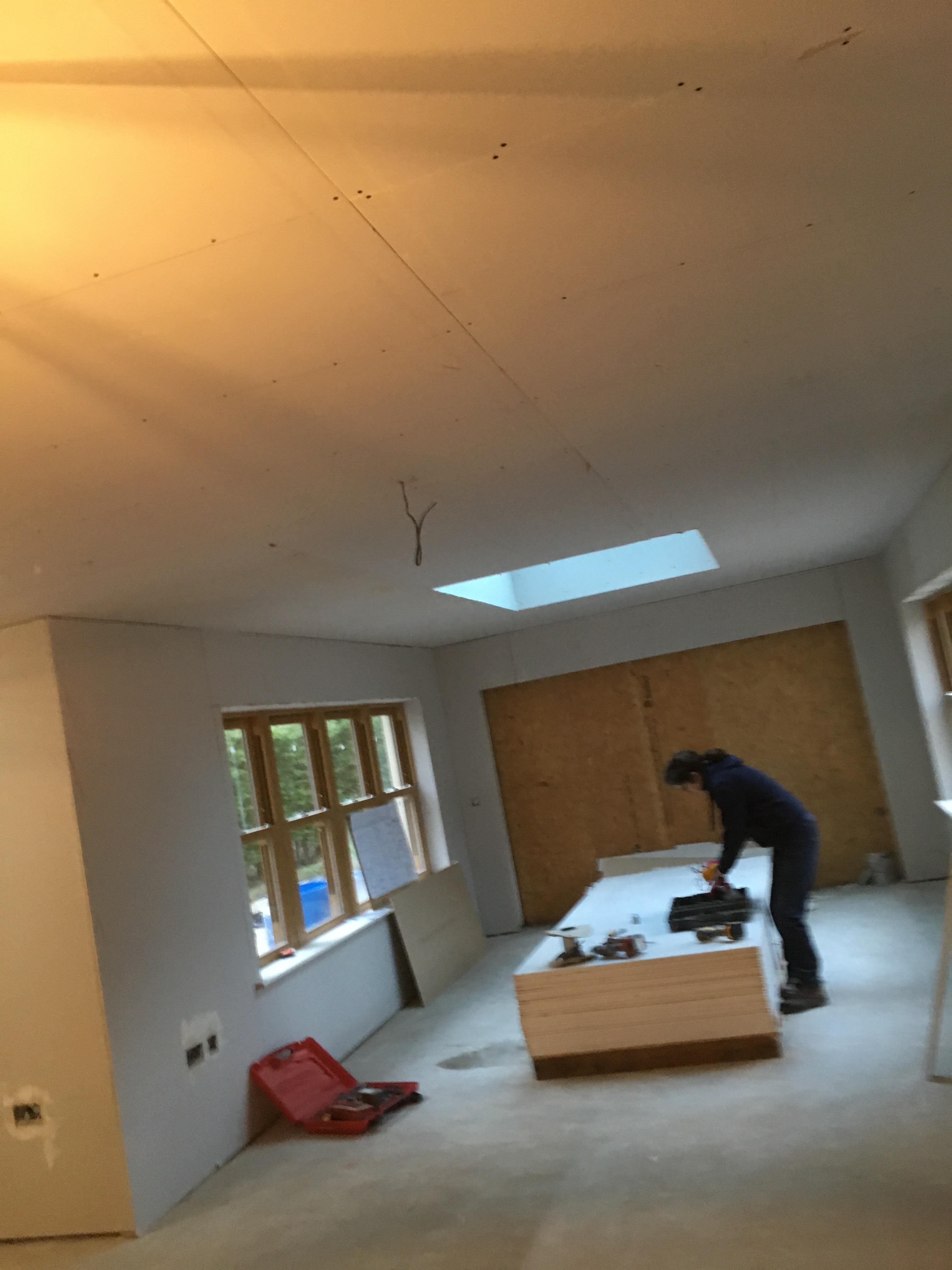

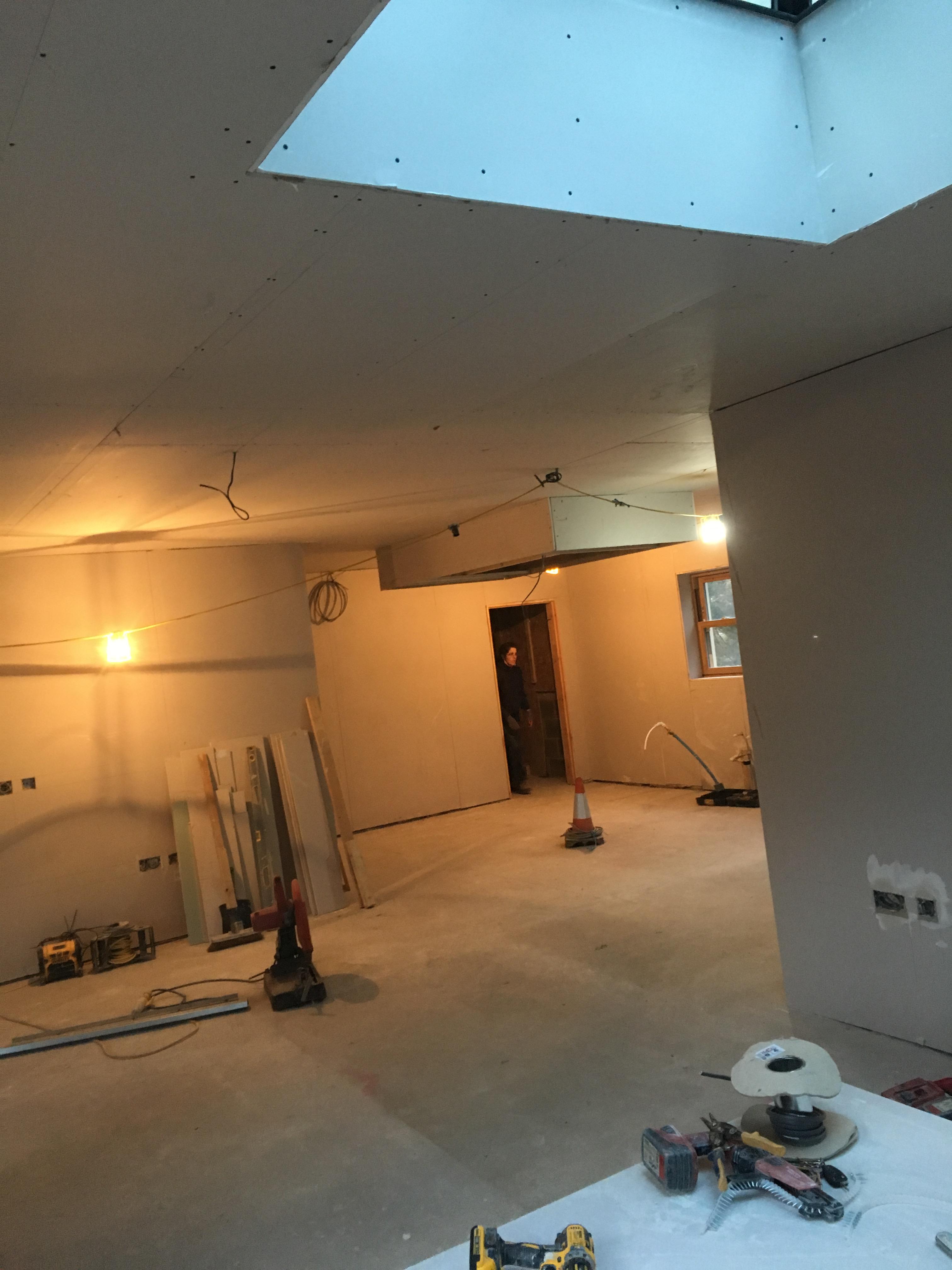

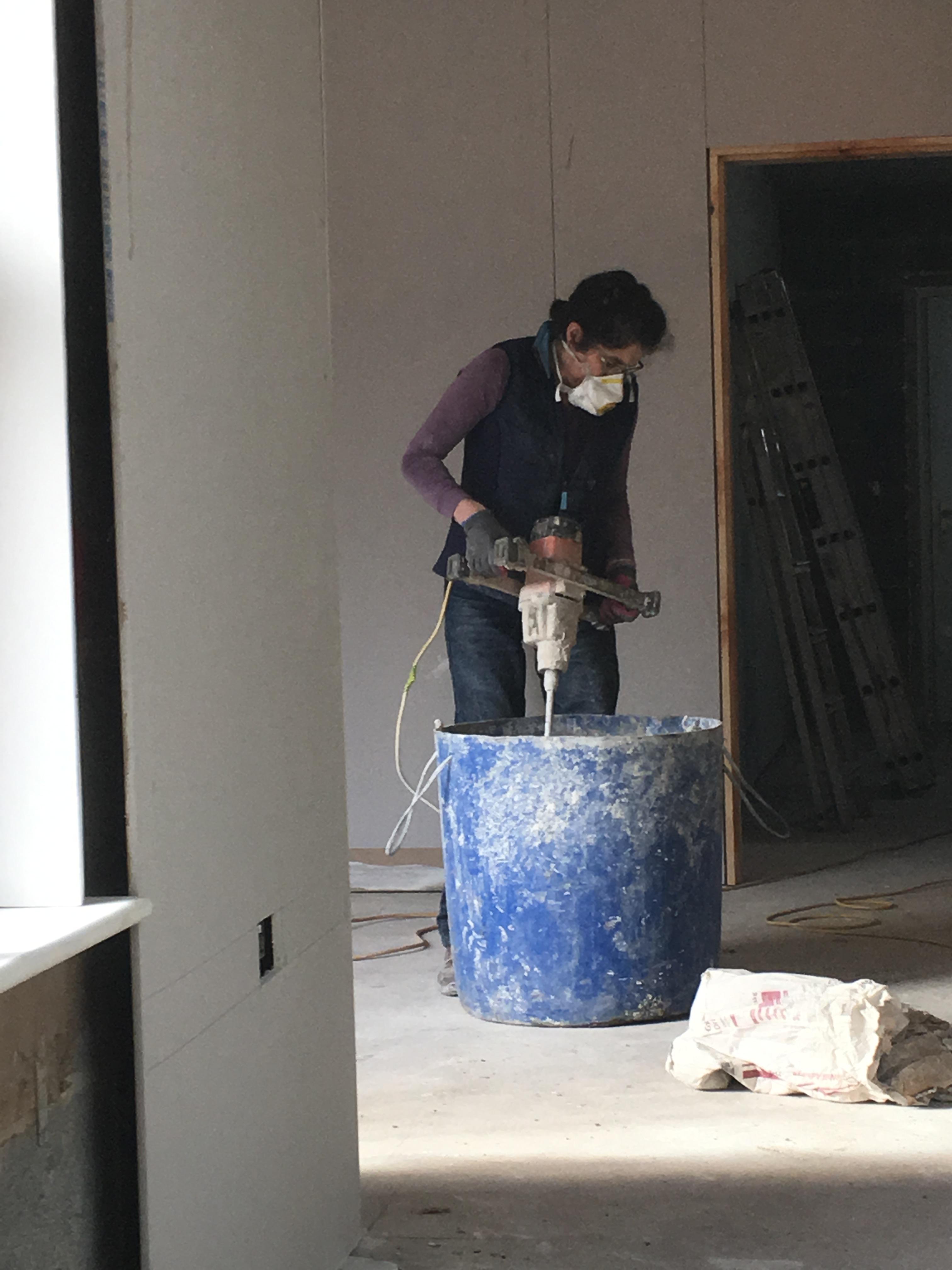

I’ve had a few days doing the dabbing with my able assistant
Still some bit to finish and build the fitted wardrobes
Hoping to skim the upstairs out on Tuesday and Wednesday

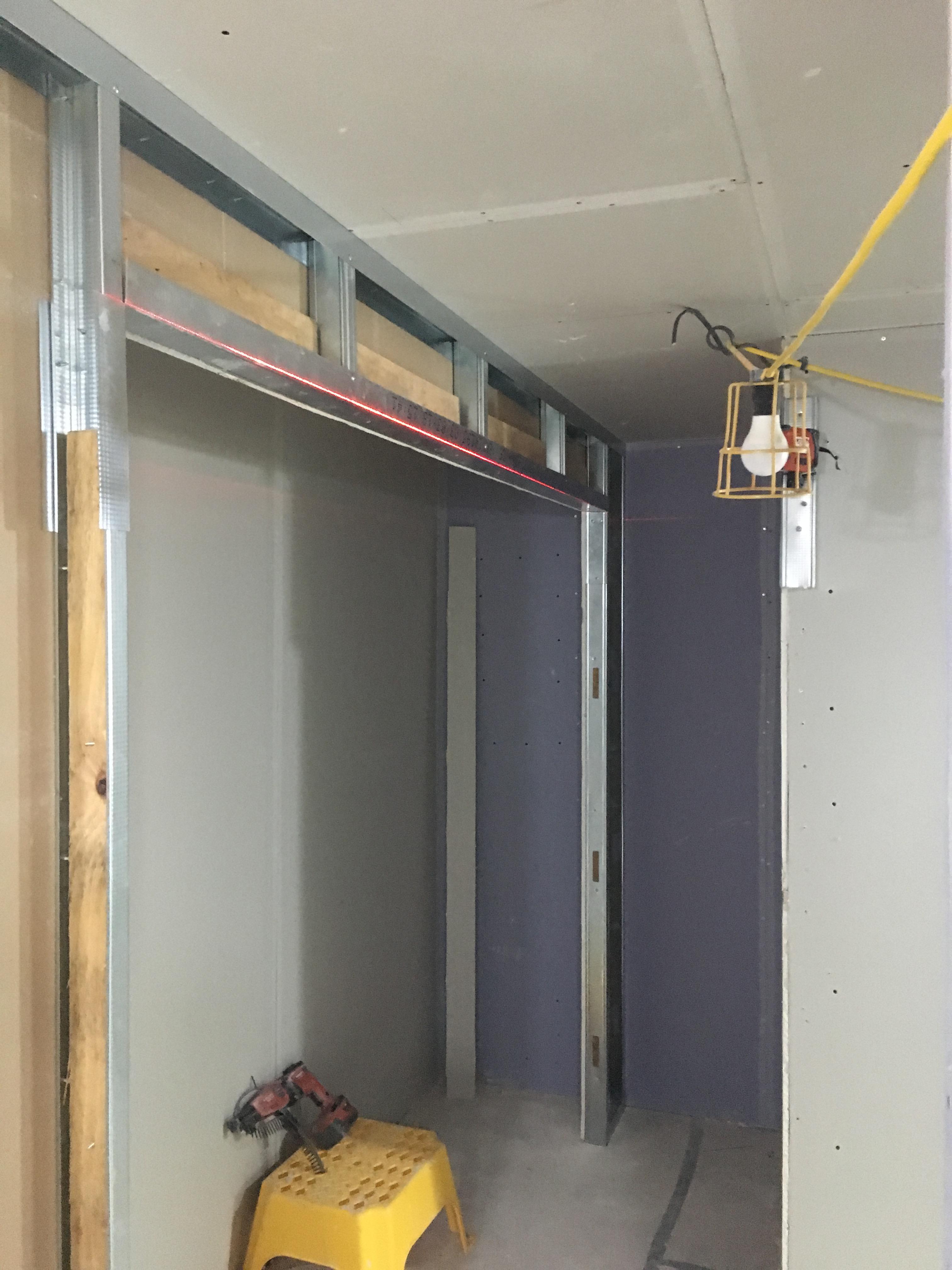

7 hours ago, Russell griffiths said:
Looks good mate

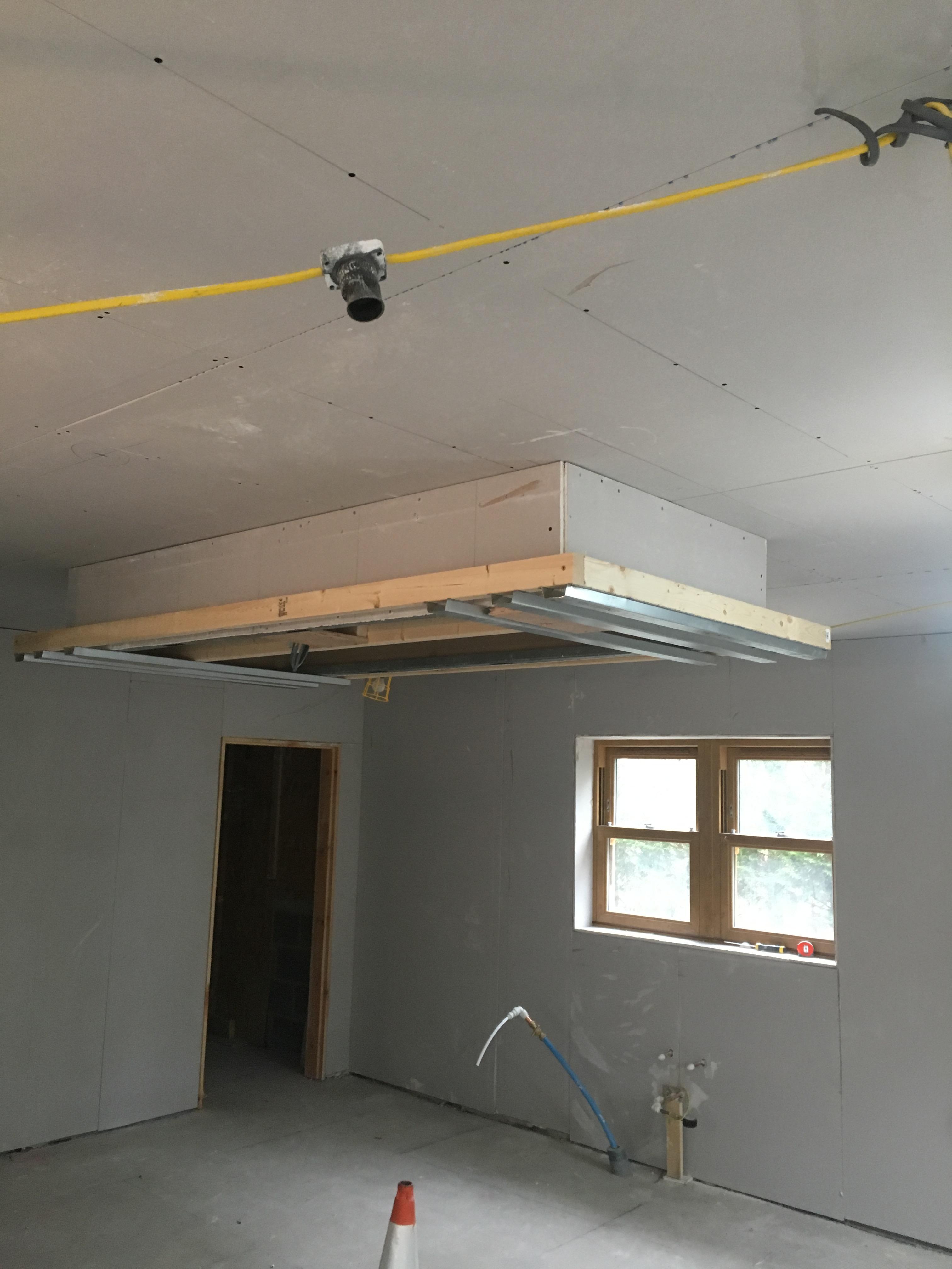

i see you have a metal chop saw in one of the pics, have you used steel track and stud somewhere?
Yes I have Russel

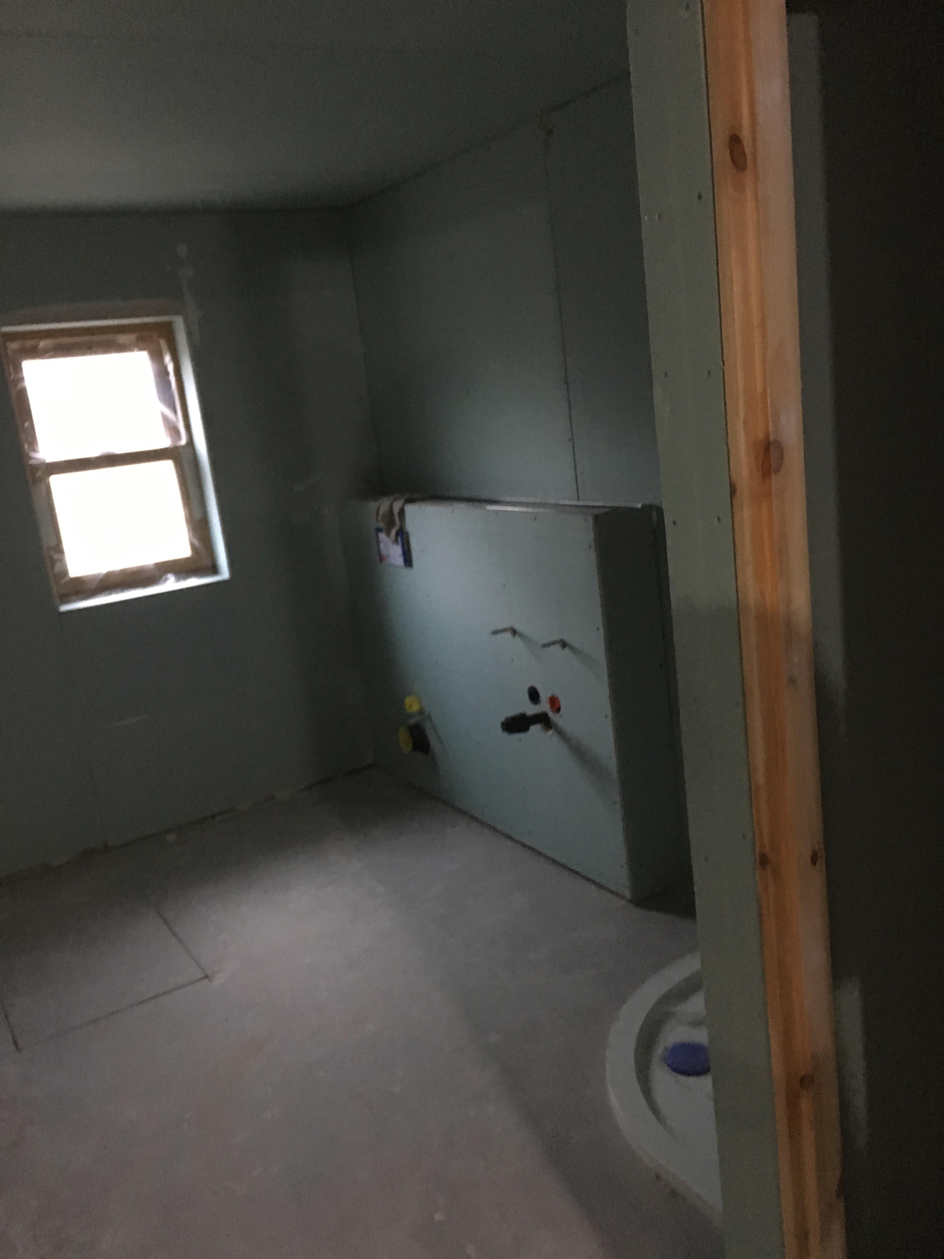

Ive used MF studying to form the bathrooms and ceiling coffer
A lot straighter than timber Better sound insulation
and quiker
I’ve three built in wardrobes to do today Two hours for all three
Millinetre perfect

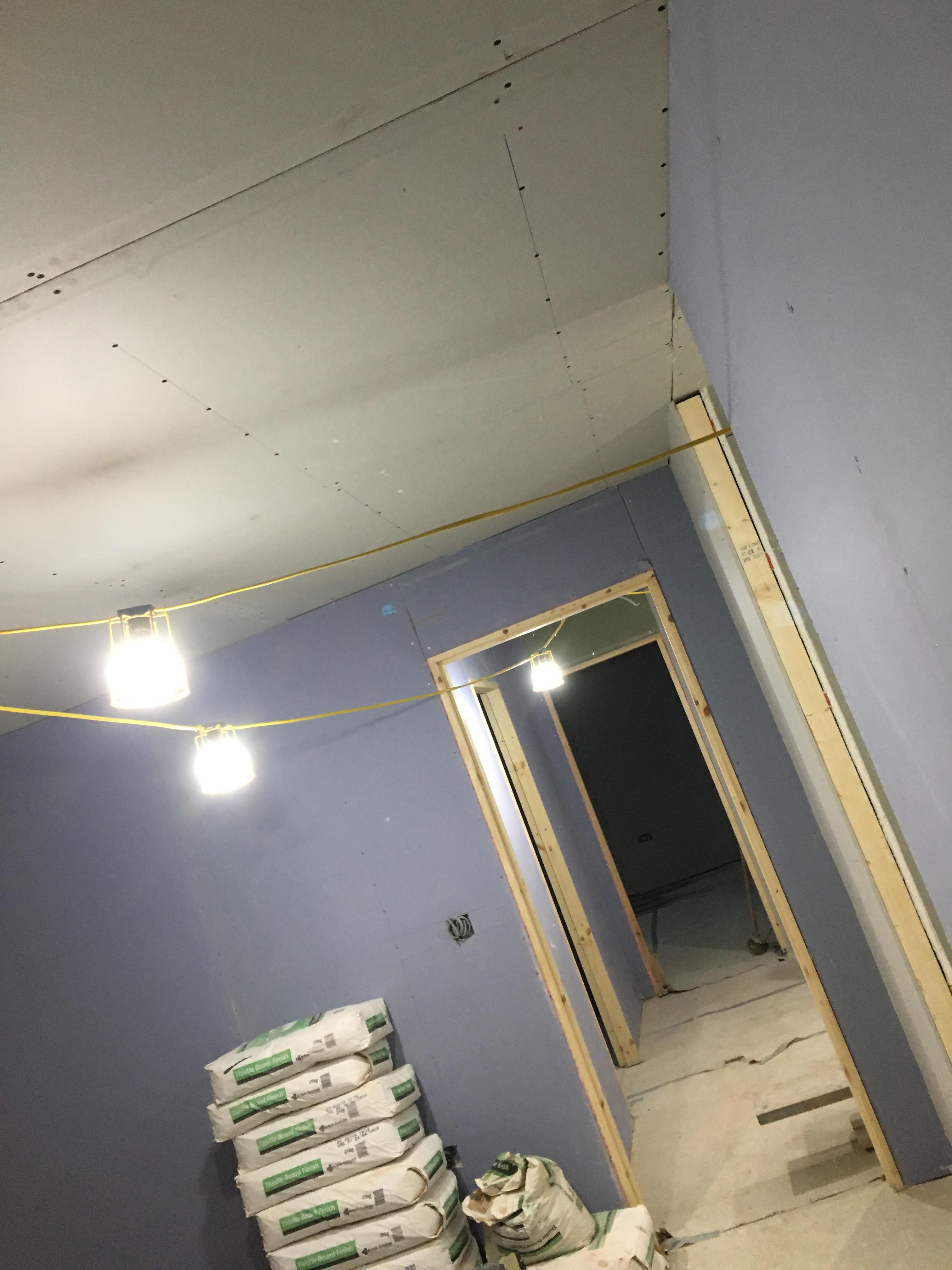

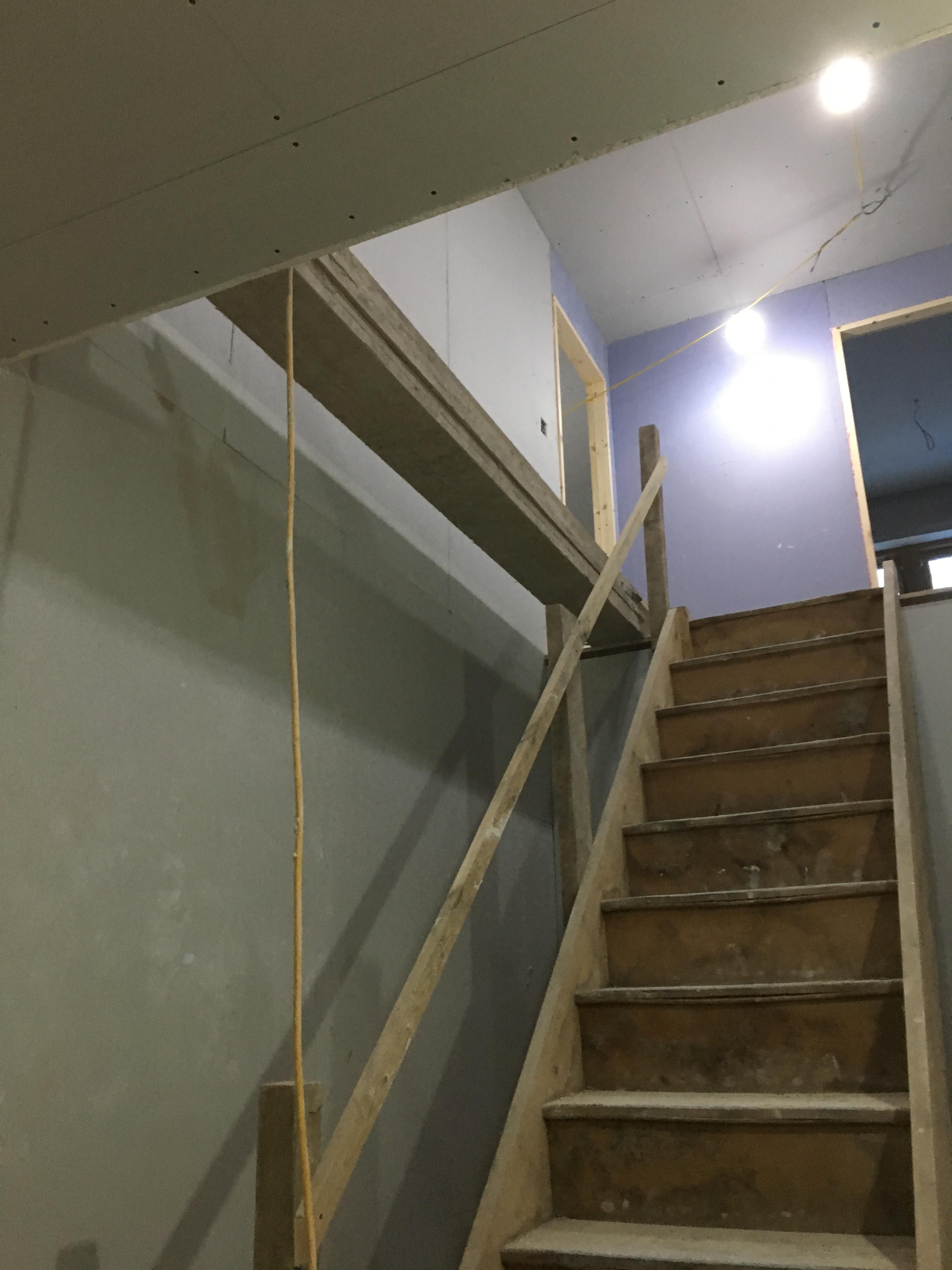

Building the fitted wardrobes may be delayed for a few hours
My wife has just shown me a picture in Lancashire life and asked if I could alter the lighting coffer over the kitchen Island
So I’ve just to take it down slightly
At least I hadn’t finished building it up
Again that the beauty of MF as aposed to Timber
Ive also moved the bathroom walls three times now
One is back were we started
Deep breaths

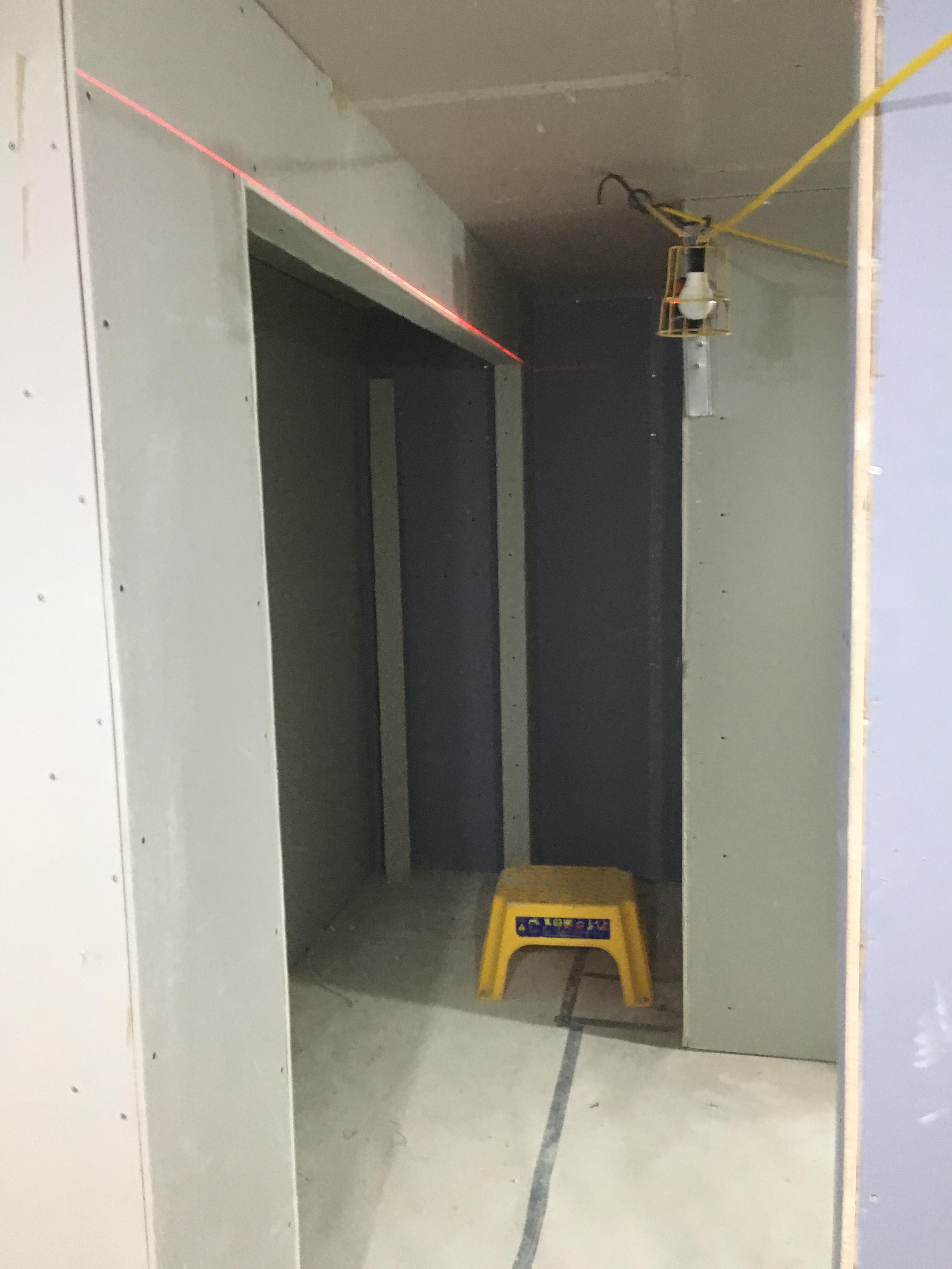

I’ve put the three fitted wardrobes in yesterday afternoon
A Quik and cheap method
I intend to hang three Mexicano type doors on each and kit the insides out from ikea
