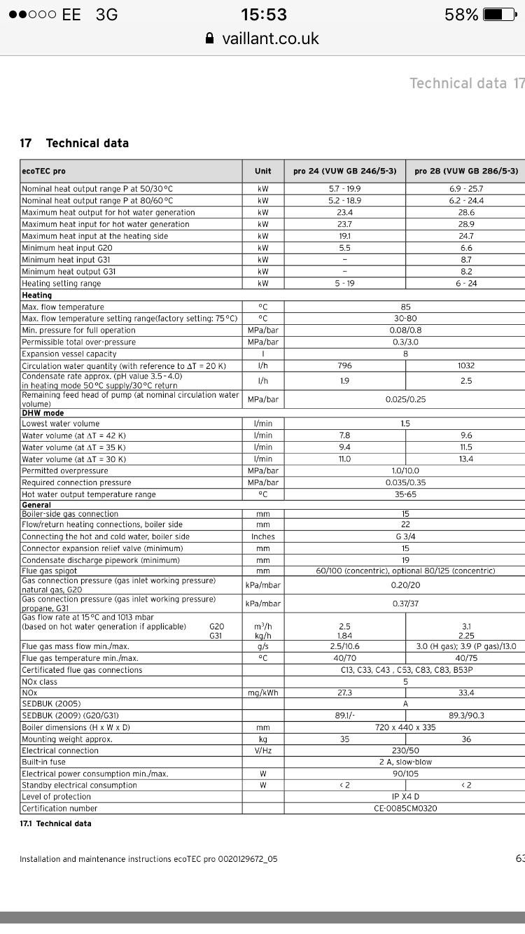

Pocster Posted April 1, 2018 Author Share Posted April 1, 2018 1 minute ago, Nickfromwales said: Need to know as it'll be heating the system. If it's only a 24/28kw then we may end up going W-plan aka "DHW priority" where it doesn't do space heating and hot water together and any time the hot water needs topping up the system will divert from heating to do so by design. The hot out of the combi will just do the kitchen sink so it ( the moving hot water components etc ) stays active, with the heating output serving the rads and UVC via the W-plan arrangement. Controls can be discussed on a separate thread if you like, when a system is firmly decided upon. Ok ! ill need to go to the property and get the model number - suspect 24/28kw Link to comment Share on other sites More sharing options...

Nickfromwales Posted April 3, 2018 Share Posted April 3, 2018 If it's only a 28kw then we may end up going W-plan aka "DHW priority" where it doesn't do space heating and hot water together, so any time the hot water needs topping up the system will divert from heating to do so, by design. The 28kw gives around 25Kw to heating ( or heating / hot water in your case ) so going Y or S plan ( space heating and DHW reheat simultaneously) is a bit ambitious from 25Kw for a cylinder that big. You really should be taking the combi out and be fitting a correctly sized system boiler TBH. The hot out of the combi could just do the kitchen sink so it ( the moving hot water components etc ) stays active, with the heating output serving the rads and UVC via the W-plan arrangement. Controls can be discussed on a separate thread if you like, when a system is firmly decided upon. 1 hour ago, pocster said: I thought the 1 electric working if the UVC bust is better than nothing. At least *a* shower is possible. I also thought that the electric takes the strain of the UVC - i.e. it only has to deal with 4 showers potentially on simultaneously The uvc won't typically 'go down', the most likely failure will be the boiler or motorised valves. Are all the showers ensuite? Link to comment Share on other sites More sharing options...
Pocster Posted April 3, 2018 Author Share Posted April 3, 2018 1 minute ago, Nickfromwales said: If it's only a 28kw then we may end up going W-plan aka "DHW priority" where it doesn't do space heating and hot water together, so any time the hot water needs topping up the system will divert from heating to do so, by design. The 28kw gives around 25Kw to heating ( or heating / hot water in your case ) so going Y or S plan ( space heating and DHW reheat simultaneously) is a bit ambitious from 25Kw for a cylinder that big. You really should be taking the combi out and be fitting a correctly sized system boiler TBH. The hot out of the combi could just do the kitchen sink so it ( the moving hot water components etc ) stays active, with the heating output serving the rads and UVC via the W-plan arrangement. Controls can be discussed on a separate thread if you like, when a system is firmly decided upon. The uvc won't typically 'go down', the most likely failure will be the boiler or motorised valves. Are all the showers ensuite? Yep all showers ensuite. Boiler was spec'd by an install company that doe the maintenance - can't it just do heating for rads and kitchen tap??? Link to comment Share on other sites More sharing options...
